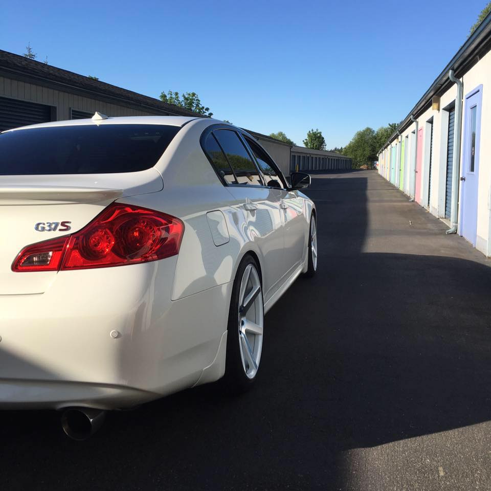

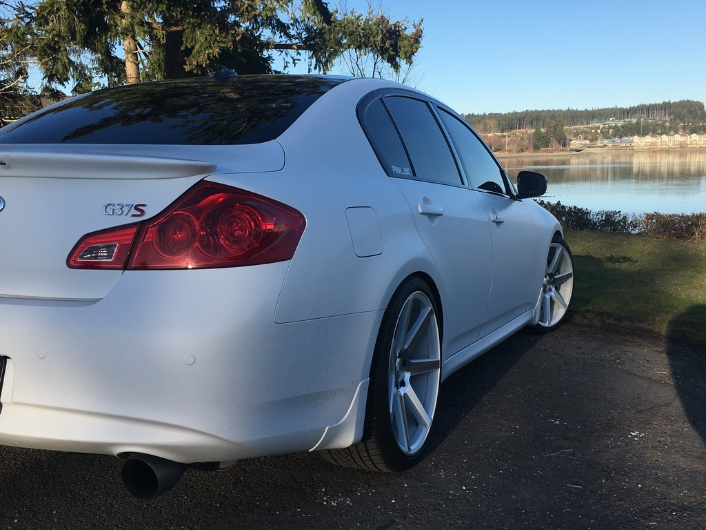

I have 20x10 +40 rear and 20x9 +35 front.
Tires are 285/30 rear and 245/35 front.
I really want a 7-10mm spacer for the front. rear is perfectly flush imo but front sits way too far in for my liking.
attached a couple pics for reference.
Will fit ok, rears will be just a bit outside the fenders when looking straight down (about 5mm) fronts will be right at the fender edge (again, when looking straight down). You could run up to a 285/30 rear tire and a 255/35 front.
Attached Thumbnails SEDAN | Official Aggressive Offsets & FAT Tires-car-at-storage.jpg   SEDAN | Official Aggressive Offsets & FAT Tires-angle-shot.jpg
