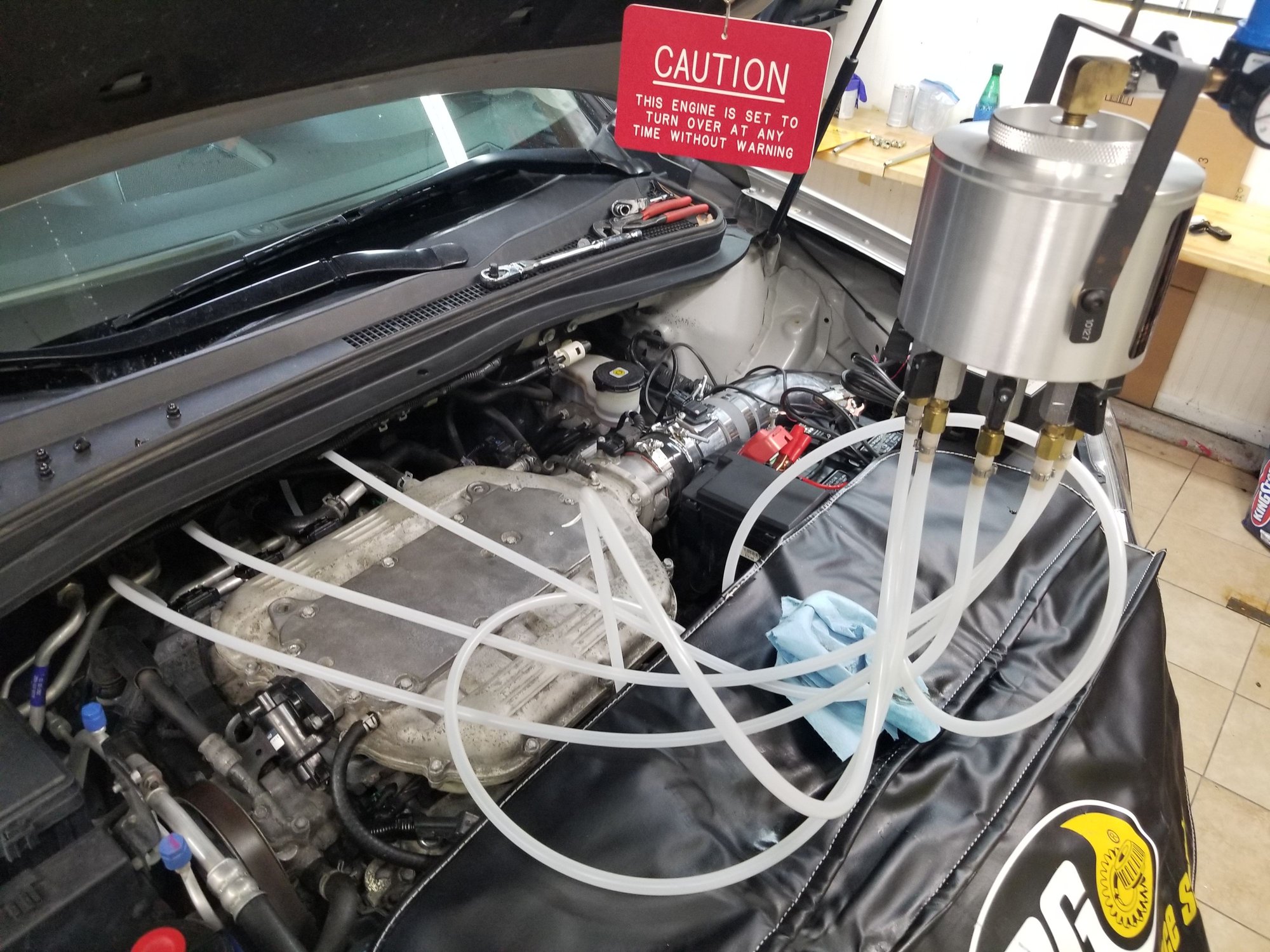

I will take this recommendation, seen much great advice from you. Tell me more about your decarbonization setup in your J. Are you dripping cleaner into every cylinder to "pre-soak" then you do a vacuum feed with the engine on?
Old Dec 9, 2021 | 01:40 PM
  #13655
Dzionassi's Avatar
Dzionassi
Joined: Feb 2017
Posts: 363
Likes: 46
Actually chemicals getting sucked from the machine to the engine. This setup comes with timer which connects to a starter. It bumps starter for a sec and all soaking material is send to the cylinders. It really works great for heads, valves and piston rings.
When procedure is completed, air connected to the machine and all chemicals are purged through the piston rings to the oil pan. This way engine starts easier when all is done.
