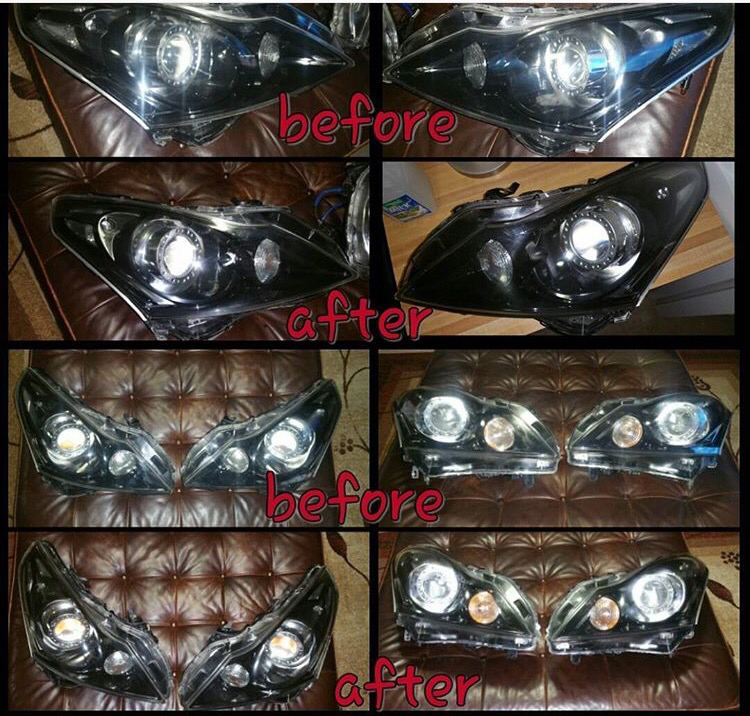

Just picked these up for a crack head price, and a buddy of mine worked his magic on restoring the lens. I think they came out pretty good.

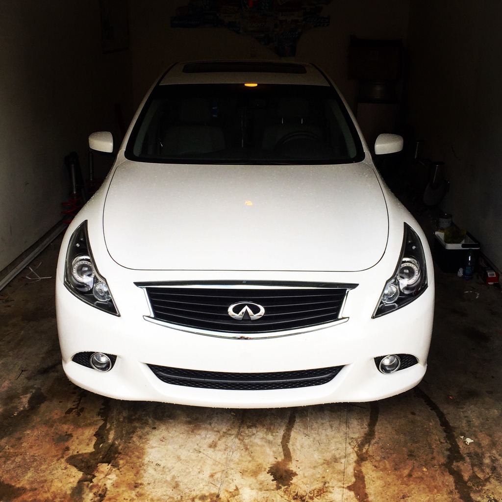

Here's a pic to stay on topic. Front end Friday, post em up. Edit: I though i was in the show off your sedan thread
