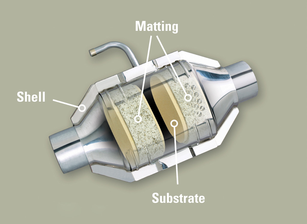

Nice to see your dealer covered this under warranty. I believe since it is an emissions related item that Infiniti actually extends the warranty by another year (5 years instead of 4).
Bad CAT's are not all that uncommon. I've run across it many times. Most common cause is that the matting inside the CAT fails to expand properly when the car/CAT is new and therefor never properly holds the ceramic brick in place. Eventually the brick will start to move around and then begin to rattle.
So what you're saying is that the substrate becomes dislodged from the walls of the cat, and it's the entire "brick" that's rattling?
It's the matting that surrounds the substrate that can cause the substrate to come loose. This matting is designed to expand and in-turn hold the ceramic substrate in place, but if it doesn't expand properly or doesn't properly seat itself it is possible for it to come loose from the housing allowing the entire piece of ceramic substrate to rattle inside the housing. I've had this happen on two previous cars and have seen it happen on several others. Here's a quick cross-sectional view of what I'm referring to.
