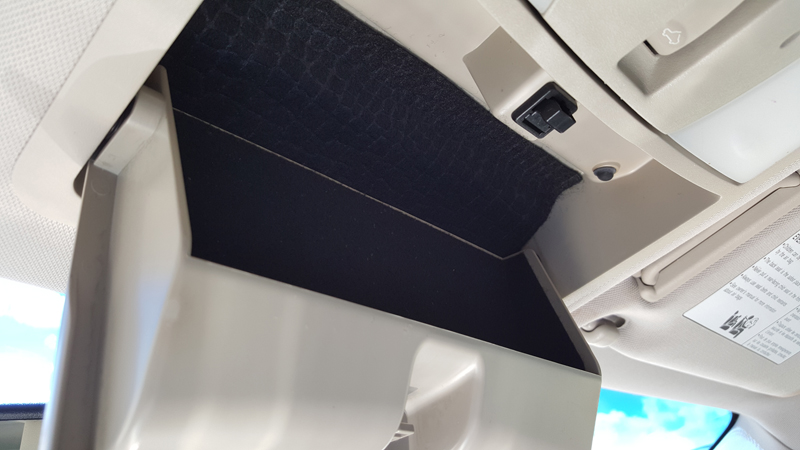

I got tired of my sunglasses rattling so I went to an arts and crafts store and picked up some black felt. They had tons of colors and patterns to choose from but we already have black on the tray so why not go ahead and match. I also picked out a faux pattern but it is basically too dark to see it up there anyway.
I already had some spray adhesive at the house so it was a simple matter of cleaning the plastic, measuring the opening, cutting the felt and gluing it into place.
The rattle is now gone for good and it also looks better than the plain plastic that was there before.
Super cheap fix.

Do you have a picture of where you put the felt? Mines drives me crazy and i just have a folded up tissue shoved in there

You can't see it in the photo but the material continues all the way to the back of the holder. I'm going to do the sides next as there is plenty of leftover material. I sprayed the plastic on the first go round but this time I'm going to spray the glue on the material and then adhere. The glue drys quickly and it was difficult to get the material to move once it made contact. Plus gravity and spraying up doesn't mix too well. The glue is also withstanding the heat that builds up in there.
