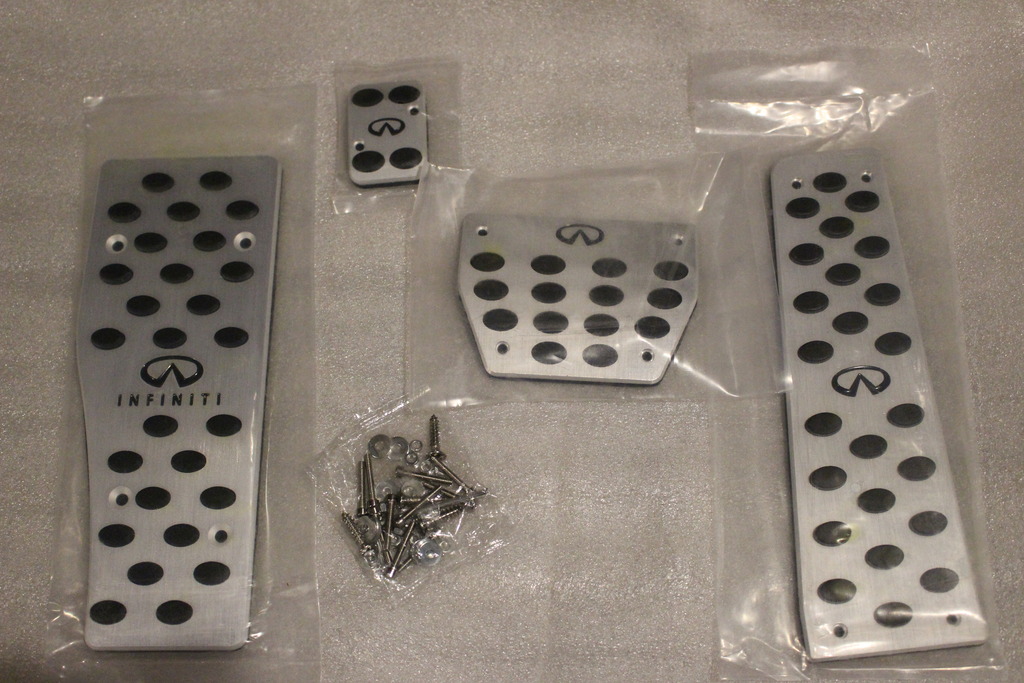

Sport Pedals and GTR clear map lenses installed....paid under $40(including expedited shipping from China) for the pedals, $31 shipped for the map lenses.
I’ve been in and out of the forum for some reading but haven’t posted in awhile. I finally got around to installing some of the mods that I received earlier this month….so many things to do…so little time…
I always wanted sport pedals on my G, but have been reluctant to order since I haven’t seen a lot of options that I liked but came across a set on eBay. They arrived well packaged and included all the necessary parts - however, it would have been nice/helpful to have a small nut wrench included but I was able to manage with my own tools.

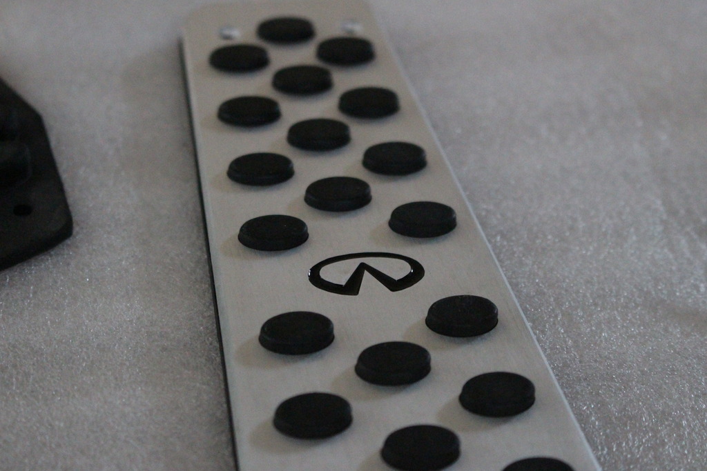

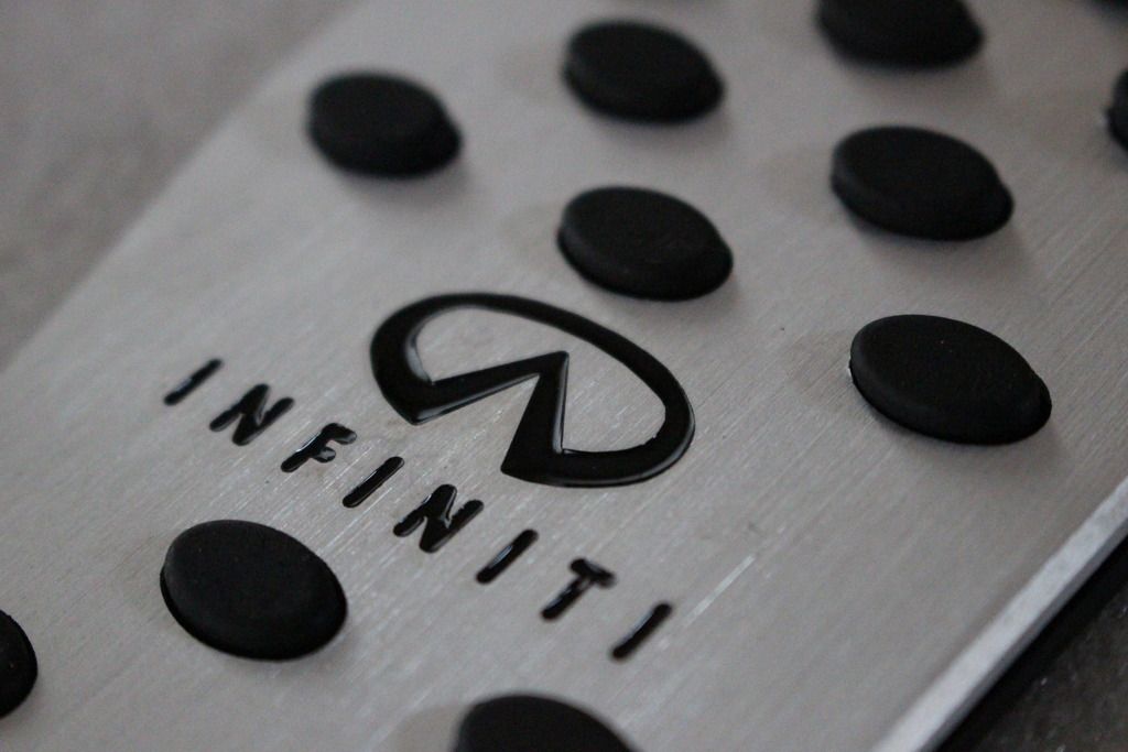

The pedals are light weight brushed aluminum with thick rubber inserts for added pedal grip/non-slip. 4 aluminum pieces included in kit with set of screws (allen and self tapping), washers (flat and locking), nuts, allen wrench. Install was pretty straight forward. screw in foot rest pedal with self tapping screws, drill through e-brake, brake and accelerator pedals.

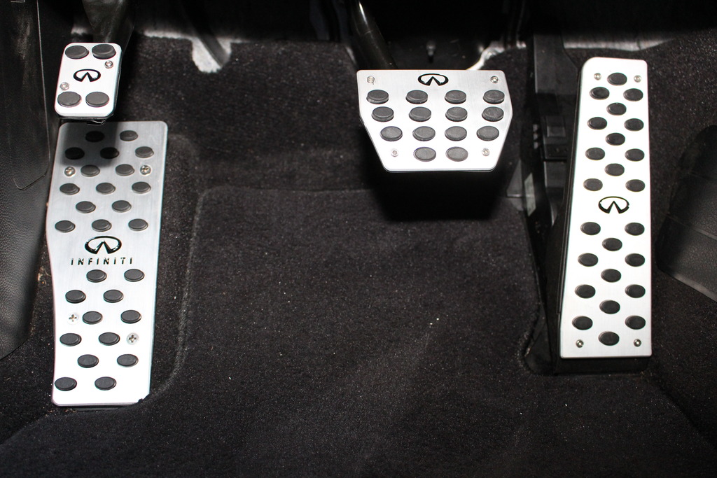

Took me about an hour to finish the install. I used painters tape to help mark drill points as well as C clamp to help keep things lined up. Much better appearance and works really well - we’ve had some rain here so I was able to put the non-slip pedals to the test.

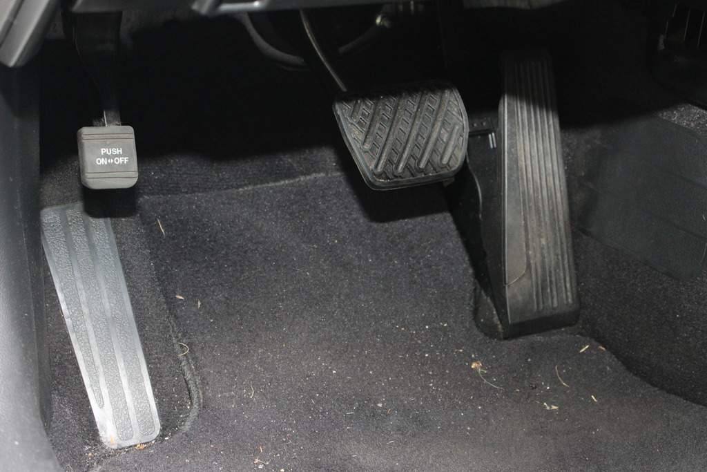

Stock pedals - sorry for the dirty floor LOL.
Sport pedals

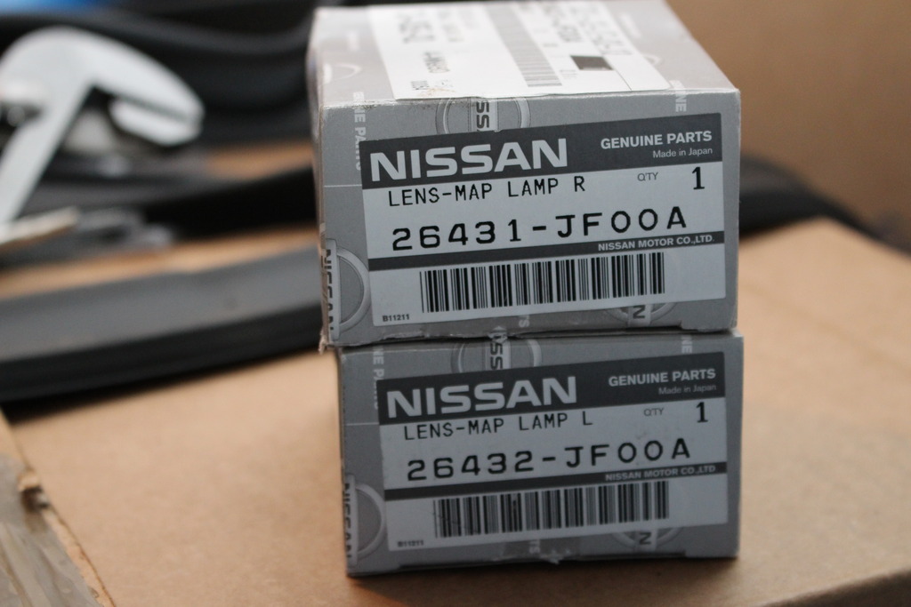

The GTR clear map lenses were an easy upgrade….really quick to replace the frosted map lenses in our G’s. Part numbers:
Both mods were inexpensive and added a nice touch…

Nice Mods did you get both items on Ebay I cant find lenses? I take it pedals just screw into rubber on OEM pedals

GTR lens at z1 motorsport
OEM R35 GT-R Clear Map Light Lenses (Pair)

Thanks! For the foot rest (dead pedal), the replacement fits directly over the existing area and just use the self tapping screws provided to hold it in place. For the E-brake and brake pedal, you have to remove the OEM rubber cover and drill thru the metal then place the replacement over it (just save the OEM rubber covers when returning to stock), for the gas pedal, just screw directly through OE plastic and place the replacement over it...the screws and nuts provided hold the sport pedals in place securely.... No issues with my install and I have plenty of grip on the pedals
