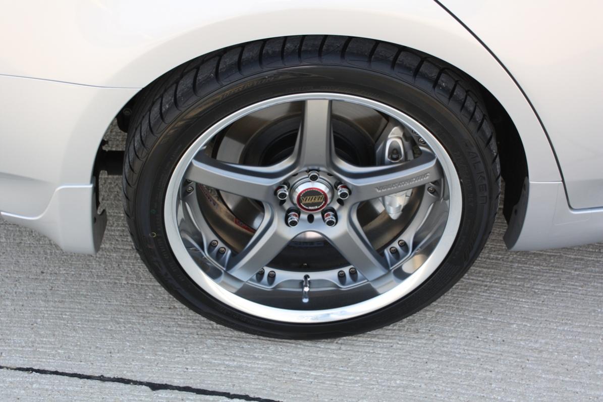

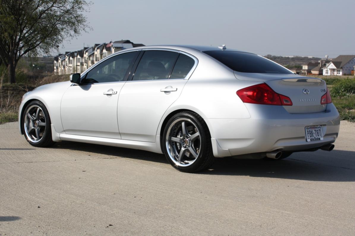

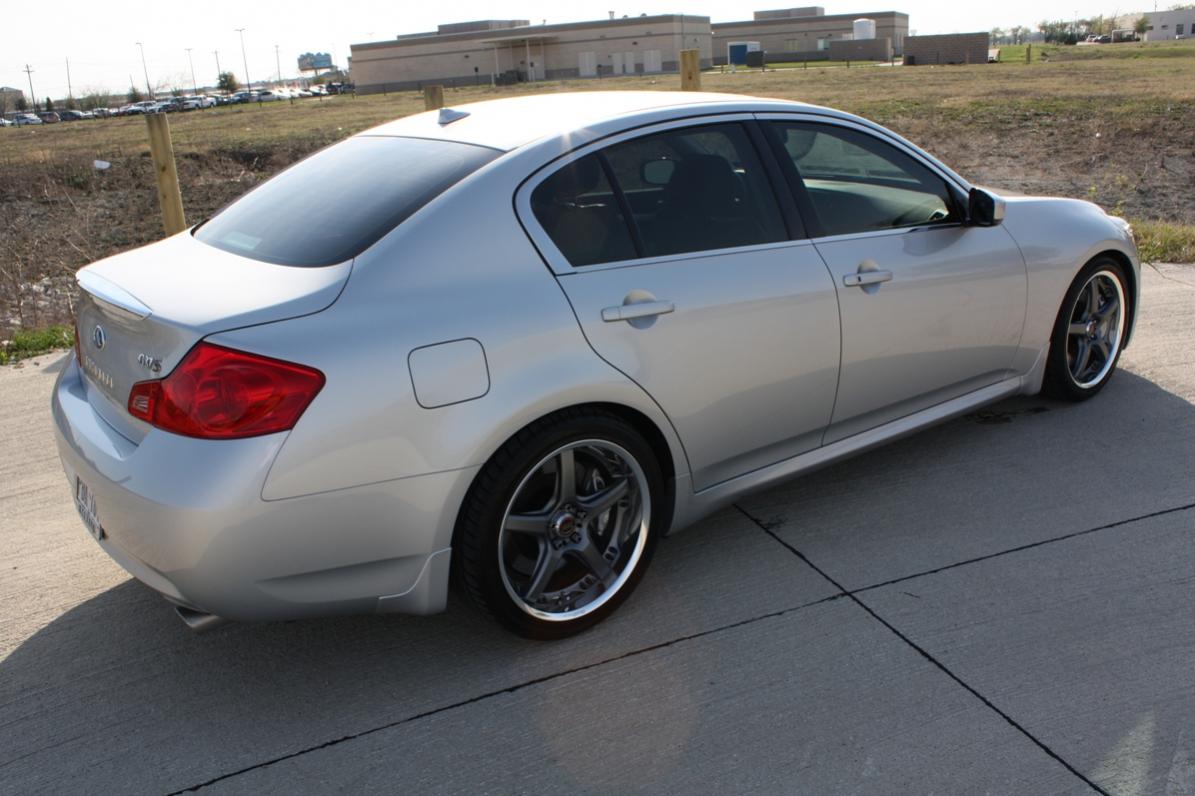

Everything is done. Here are some pics. Enjoy.
Attached Thumbnails Starting to Mod my 09 G37-gts1_small.jpg   Starting to Mod my 09 G37-gts2_small.jpg   Starting to Mod my 09 G37-gts3_small.jpg   Starting to Mod my 09 G37-gts4_small.jpg   Starting to Mod my 09 G37-gts5_small.jpg

nice ride!!!
what's your next mod?

very nice!! nice choice of wheels!

Very nice looking wheels.
Are the tires still staggered? What size tires did you get? Is your ride dropped?

Yes, the tires are staggered. 245/40/19 front and 275/35/19 rear. The wheels are Volk GTS's in Titanium gunmetal. They are 19x8.5 (+36 offset/inset "A" for Volk) and 19x9.5 (+37 offset/inset "C").
I am dropped on Eibach springs for the 07-08 sedan. I also have Eibach (SPC) rear camber arms. We discussed this in another thread, but the 09 Eibach springs should be out in about a month. These do work, and I am happy with them so far.
I had my alignment done today, and the toe is in spec all around, the rear camber is at -1.3, and the front camber is at -1.5 and -1.8.
Eibach springs $220 from tirerack.com
Eibach rear camber kit $180 from tirerack.com
Volk GTS wheels $2400 from Wheel Warehouse (center caps +100)
Volk Formula lug nuts $200 from Aspec
Falken FK-452 tires $1000 from Discount Tire
You can throw in some tax and shipping on top of the above. I installed the springs and camber kit myself, and had Cobb tuning align it for $100. That's it.
