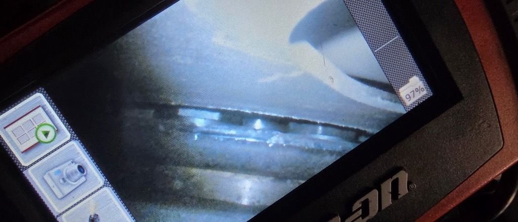

I recently had the engine on my 2013 G37xS coupe swapped out for a VQ from a 2014 q60 with 78k miles, due to my gallery gasket giving out. Now less then a week later, my G broke down again mid-drive. This time was due to the flexplate snapping. Specifically, where the crankshaft bolts attach to the plate. You can see the break in the picture below:
From my understanding, flexplates can break from age/metal fatigue, but also from uneven and improper torquing of the bolts. My mechanic claims its due to metal fatigue and age, but I want to get other opinions on whether this looks more like a break from fatigue or from improper installation.

I have heard that the OEM flexplates are weak in the context of 500+ WHP forced injection builds (Soho will say this, as well as IPT), but I have seen very few flexplate failures reported as most of us are just naturally aspirated with some bolt ons.
My flexplate broke a few years ago. I was redlining with the paddles a lot though, cause that's where most of the power is and it won't let you get to that if you keep it in auto. With that many miles I don't see how they can blame the mechanic unfortunately. I just use stop leak for my leaking gaskets. https://barsleaks.com/product/oil-se...k-repair-os-1/

The stock flex plate is a design flaw. 300 hp with that thin metal? Mine went out at 130K. Put a good one in from Z1 Motosports.
That was a corner they cut for profit. Yes i drive it hard at times. Thats why i bought it. If i wanted to ease around i would have bought a KIA.
