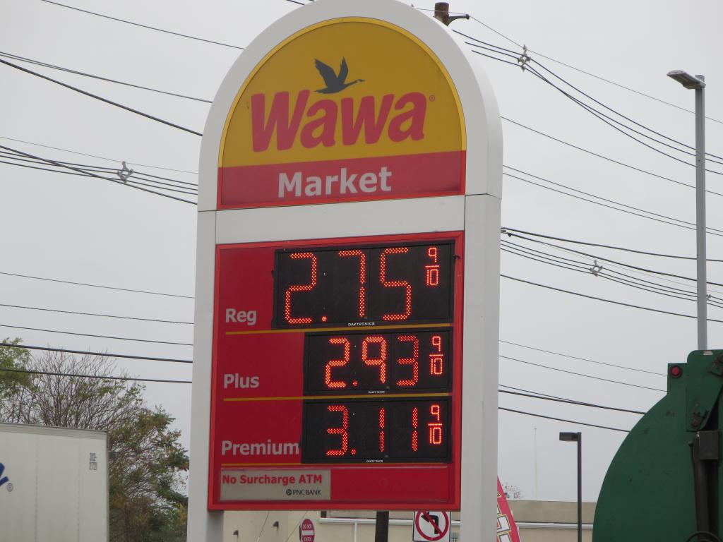

Old Oct 26, 2014 | 10:09 AM
telcoman's Avatar
telcoman
Posts: 1,638
Likes: 161
From: NJ
Originally Posted by PanzMan
I have had this issue several times. Here in NJ you are not allowed to pump your own gas. One attendant showed me if you put the handle in the tank upside down (looks weird) it does not kick off. Sure enough every time I have this issue this seems to work.
I've experienced the problem a few times at stations out of state on my way to Florida along I95. I usually make a note of the stations and never go back.
This is a new station that opened a couple of years ago near my house and I've never experienced the problem as I usually purchase all my gas here.
Telcoman
$3.11 Road trips for gas from now on, for me.....
Old Oct 26, 2014 | 12:22 PM
telcoman's Avatar
telcoman
Posts: 1,638
Likes: 161
From: NJ
Today's price is $2.73 for regular and $3.09 for premium
