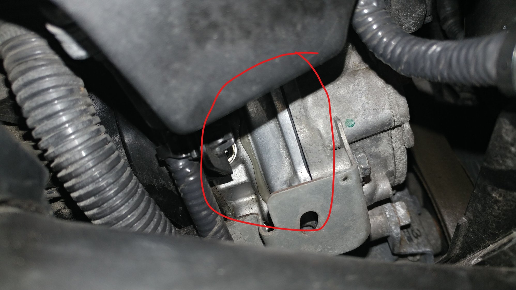

well I went to 3 garages and they said oil pressure test wont do anything since a leak like that doesnt have an effect on oil pressure.
I cleaned around the oil leak with some brake cleaner. After 1 week of driving, 500 miles. it seems to have not leaked again . is it some old oil ?
Should I do the maintenance since I saw many people after opening an engine, like the timing chain cover, many problems can occur after. so is it worth it
picture before:
picture just after it was clean :
picture one week after it was cleaned ( after 500miles of engine running):

This thread is about a specific issue of an internal oil leak. That's not what you have.
