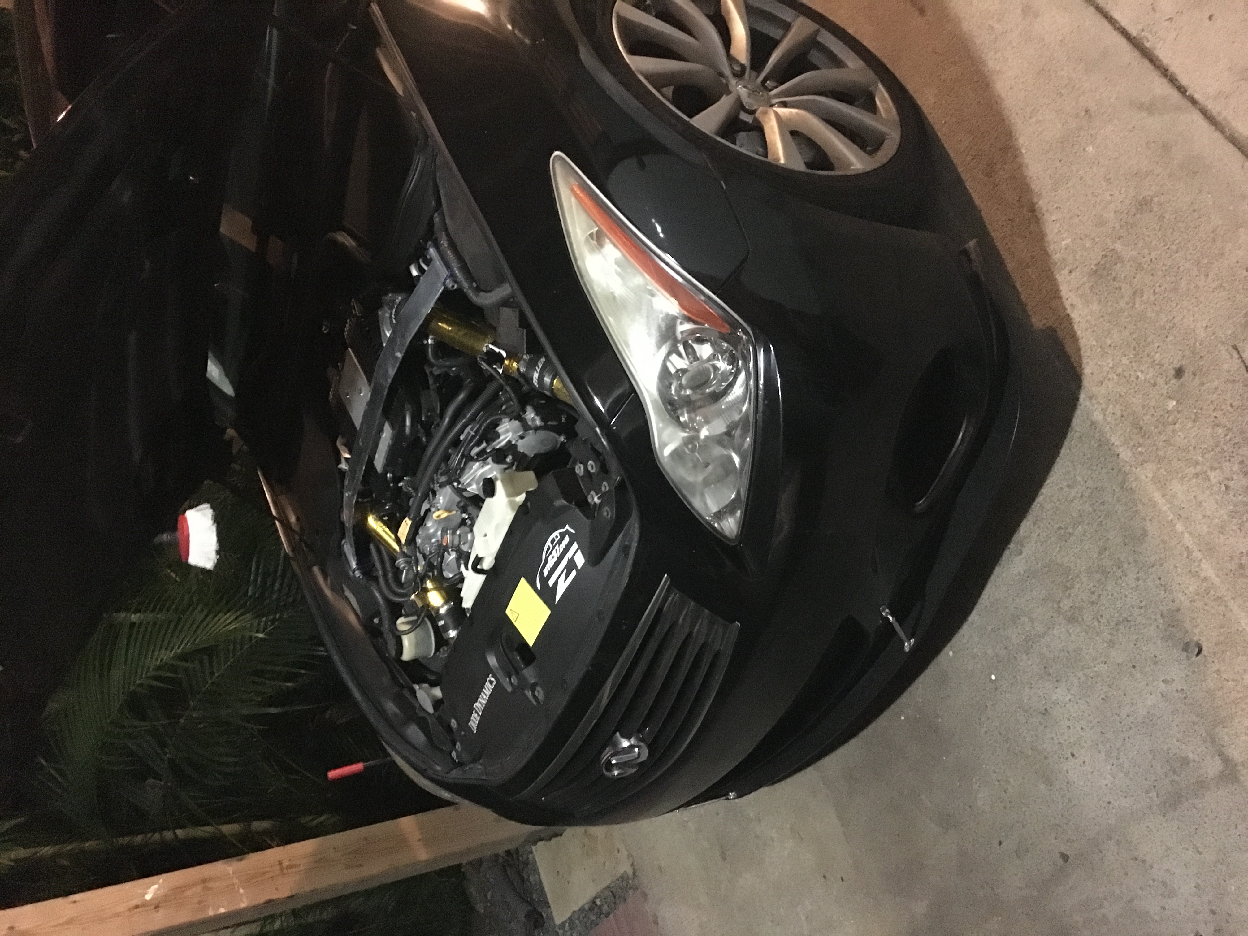

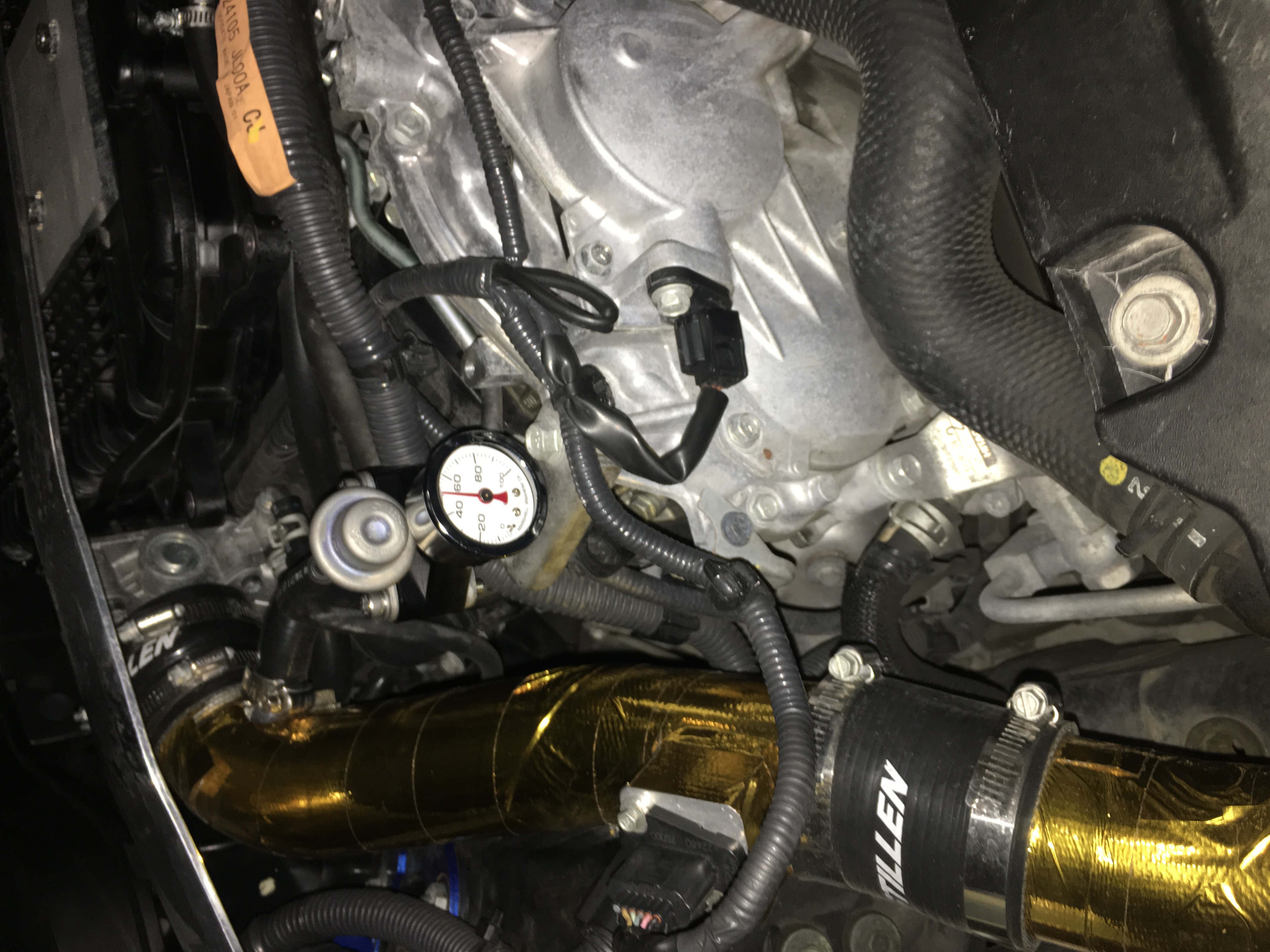

So I installed this bad boy last night. Purchased it from CJ Motorsports (Phunk from the370z.com site, he's very active over there) on Black Friday. Available here ( CJM Fuel Tap NPT, Nissan 2-Bolt | CJ Motorsports ) or here ( https://www.z1motorsports.com/fuel-s...pt-p-9010.html ). Instructions supplied ( http://host.cj-motorsports.com/pdf/H...auge%20Kit.pdf ) are pretty straight forward. On page 3, the bracket that's removed just toss that out. On page 4, it speaks about depressurizing the system. It's a bit exaggerated in my opinion but safety first. I took off the OEM Fuel pressure Regulator expecting a shower of fuel on my rags, and they were all dry. I allowed to sit for 2 hours with the hood open and battery disconnected. Very minor mod. VERY easy. Less than 10 minutes. Shows Fuel pressure. Pretty straight forward. I like it. it'll be very helpful for force induction applications. Thumbs up to Phunk!!
