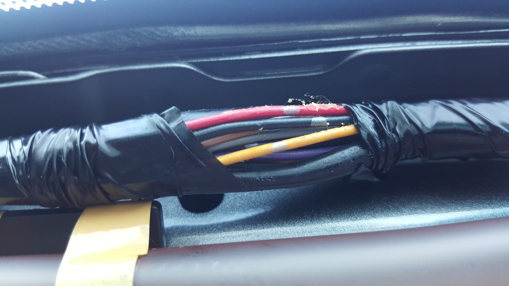

So I popped off the passenger side pillar and I see a spindle of wires that looks more of what I'm looking for.
One of these wires lead to the dome light. I'll try to figure it out this weekend.
I tested the wires on the left and they're a no go. They have sockets that I unplugged them from yet the dome lights stayed on.
