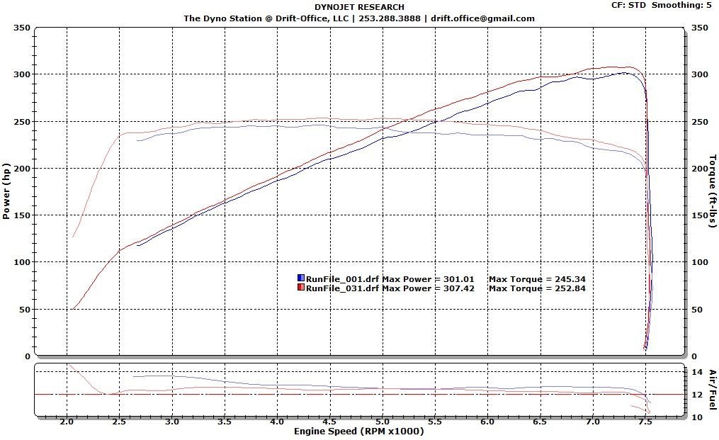

UPDATE: Bucking issue has been resolved! Car is now running beta software from Ecutek. The issue was software related - the car essentially thought that the gradual application of throttle was engagement of the launch control! If any of you are experiencing a similar issue - I worked for Lucan from Ecutek. For reference...car is the 2013 G37S 6MT tuned via Drift Office. Good luck!
Eric
Evening folks,
Been a minute. Hope everyone is well! My car has been tuned via ECUTEK for a little over two weeks now - I'd like to add that the power delivery is MUCH cleaner compared to my previous tune via Osiris. Now...onto my issue. Holding revs at around 4000 (3rd gear, but I can replicate with similar conditions in 1st and 4th) and going WOT, the car bucks quite aggressively; almost feels like fuel cut off. I do concurrently have a bad passenger, heated O2 sensor...but this is a bit too coincidental for me to believe that this is the issue. Does anyone have some similar experiences? Car has 78,000 miles on it now and is 6mt. As I am the first original owner, the car has been well maintained. Car NOW has art pipes and FI exhaust; removed gen 3's for the tune. Everything else about the car is in tip top shape. Thoughts? Thanks in advanced!
I've considered bad MAF sensors and maybe dirty throttle bodies...and I've done all the hunting I possibly can...with no real answers
Final numbers are in GREEN
Uprev (blue) vs ECUTEK (red) - 3rd gear
Uprev (blue) vs ECUTEK (red) - 4th gear
Old Dec 17, 2015 | 07:42 PM
warpeacelove's Avatar
warpeacelove
Joined: Oct 2011
Posts: 628
Likes: 38
Sounds like Tuner ERROR.
Old Dec 17, 2015 | 09:58 PM
eksigned's Avatar
eksigned
Joined: Apr 2010
Posts: 1,700
Likes: 15
From: Pacific NW
^ I dunno about that. I'm the 4th car to get tuned. They're a reputable shop...and I was there the entire time. Afr's throughout the entire wot band are where they should be :/
