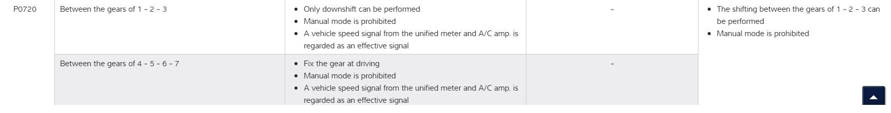

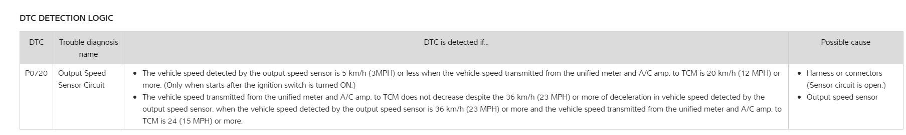

Sometimes you need to look up specific things, for example, when I was tracing Original Poster's issue, I used the base name for the transmission and the DTC (Diagnostic Trouble Code) P0705. Since I know P stands for Powertrain and the first number is a 0 not 1, it tells me this is a general code, not specific to the manufacturer, I look up the code using google first and it tells me the code is triggered by the transmission failing to be in the right range due to malfunction. I next look at the situation you are in, vehicle turns on, drives, but is in limp mode, this instantly tells me its not the speed sensor because you are able to make the shift from 1-2 and 2-3 and obviously 3-2 and 2-1 (also P-R-N). I will suspect Transmission Range Sensor since I know you cannot shift ALL gears, but you have some, this tells me your vehicle can determine speed under load and attempt to shift accordingly. After looking into the Service Information, I note the locations of the suspected components and compare to more google searches, pushes me to valve body replacement. With the capabilities a car dealer has, they should have been able to figure this out and not oversold you.

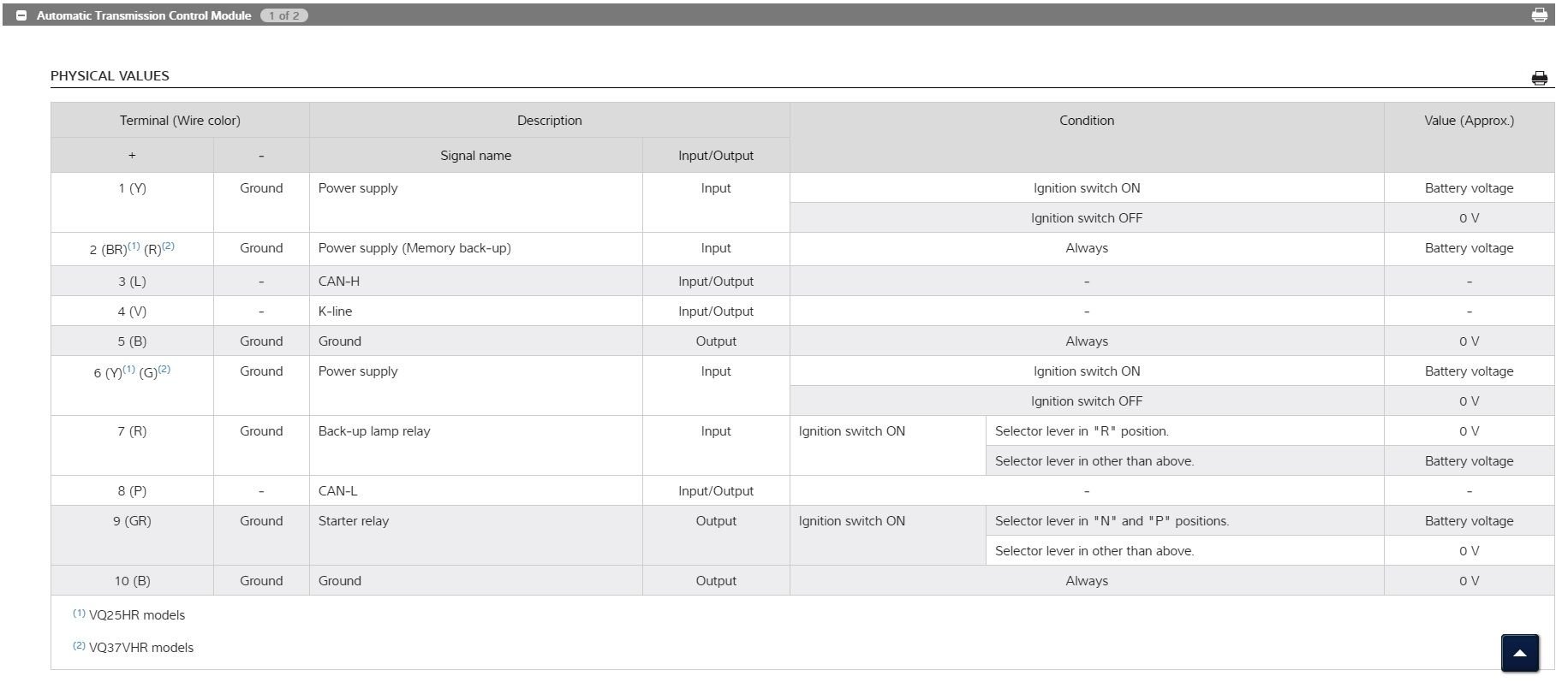

Hard to say specifically, but digging around (hey im doing FREE diag work here!!!!) pushes me around in a few directions, if the Valve Body has a harness connector on it, this is most likely the culprit. There are however SOME pressure numbers you in theory could check, spools could have gotten stuck, springs can bind etc. They do give some values for pressure testing that you might be able to check with a decent scantool if the PID shows up for it, 1370 kPa perhaps, it shows up a bunch.
Theres a joint connector which coulda gotten ****ed up on a hard bump, overall the symptoms point to some kind of electrical connection being open or having some issue where the signal sent back is not right and making the car be in limp mode. Included a chart which you can check for electrical values to detect bad harness / connector. To check against it being the output speed sensor, theres a little test I didnt show here, but it will help you determine if its the speed sensor or OTHER ISSUE.
I do suspect highly a possible electrical connection fault, its all that they lead you to believe, however you said the old tcm and solenoids operate fine, my eyes are on the connectors themselves where they plug into etc. Two connector pins could have arc'd by some metal in the fluid passing by and made the readings from tcm not appear normal.
I forgot where I saw it, but it lists the valve body and TCM as non serviceable parts, meaning replace in entirety. It's probably why the remans are hella cheap and available, also the fix for majority of limping transmissions.
