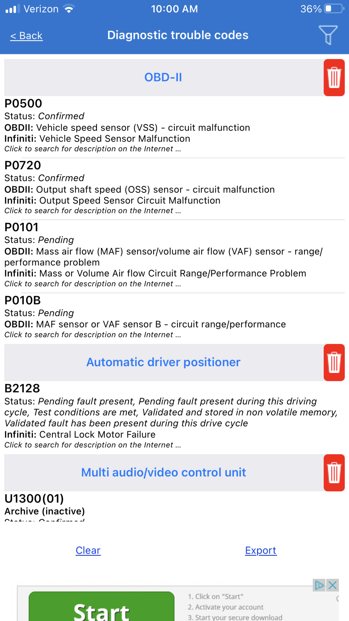

Hello everyone,
A couple nights ago my wife was about to get on the highway and her G37 suddenly lost power and she was not able to go faster than 40MPH. I'm trying to avoid a hefty bill at the dealer because the warranty has unfortunately ended. I ran the OBD and it gave the following codes below, and an emissions test. Would I be correct in assuming that changing the "transmission output speed sensor" would fix all the problems?

What app is that? It looks nice.
According to factory shop manual, possible causes of the P0720 are the output speed sensor and harness / connectors.
I suspect the P0500 is caused by the missing output speed sensor signal.
The output speed sensor plugs directly into the transmission control module (TCM), which is located inside the transmission just above the valve body.
If the speed sensor is bad, replacing it is not a simple job.
The exhaust, driveshaft, transmission pan, valve body and rear transmission housing need to be removed to get access to it.
Also, the app shows a pending fault P0101 / P010B for both your mass airflow sensors. A pending fault is where a fault has been detected ONCE. If the fault happens again, it will then be a CONFIRMED fault and the check engine light will turn on.

Does anybody know if after replacing the valve body/tcm and speed sensor (to solve this type of issue) the TCM needs to be flashed? I'm reading conflicting information online and after doing this my car is still in limp mode despite having a new speed sensor and replacement remanufactured TCM swapped into my car.
