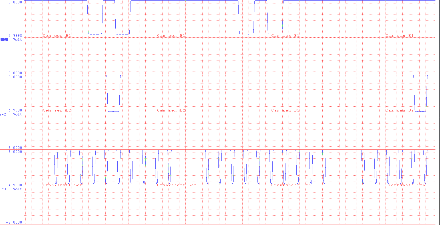

I'm going through this right now as well. Initially I thought it was a crank sensor/wiring/damaged signal plate tooth but got that resolved.
Now, When I have bank 2 cam sensor plugged in. It won't start. When I unplug the sensor it starts up in limp mode.
But the engine idles very smoothly you don't know it's a problem untill you try to rev it past 3k rpm and it won't let you.
I'm also interested in your theory to fix it without taking the timing cover off...

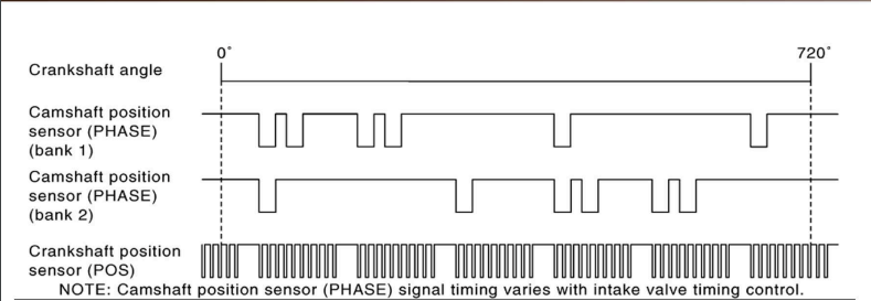

I have attached a photo of the captured signal of the 2 cam sensors and 1 crank at idle 800RPM.
cam 1 at top
cam 2 middle
Crank last
But I don't know if this spec data is supposed to match 1:1 .

Once of your cam position / encoder has slipped.
Since the engine won't run with bank 2 cam position sensor plugged in, that encoding ring has slipped.
As others have done, you can move it back to the proper position as a temporary fix.
You could try cleaning up where the encoder ring connects to the cam phaser and apply some loctite Red.

So I found out bank 2 encoder ring has moved CCW by 2 teeth from the dot at TDC. I knocked the ring back to teeth #7 and clear all fault codes by disconnecting battery. The car started right up no hesitation or delay. Haven't heard it start up so smoothly like this since the problem started.
Do you know if anyone here found a permanent fix to stop the ring from moving? Can it be weld at the mating lip where the encoder ring ID sits on top of the cam OD? Or any solution besides doing a whole cam sprocket assembly replacement?
