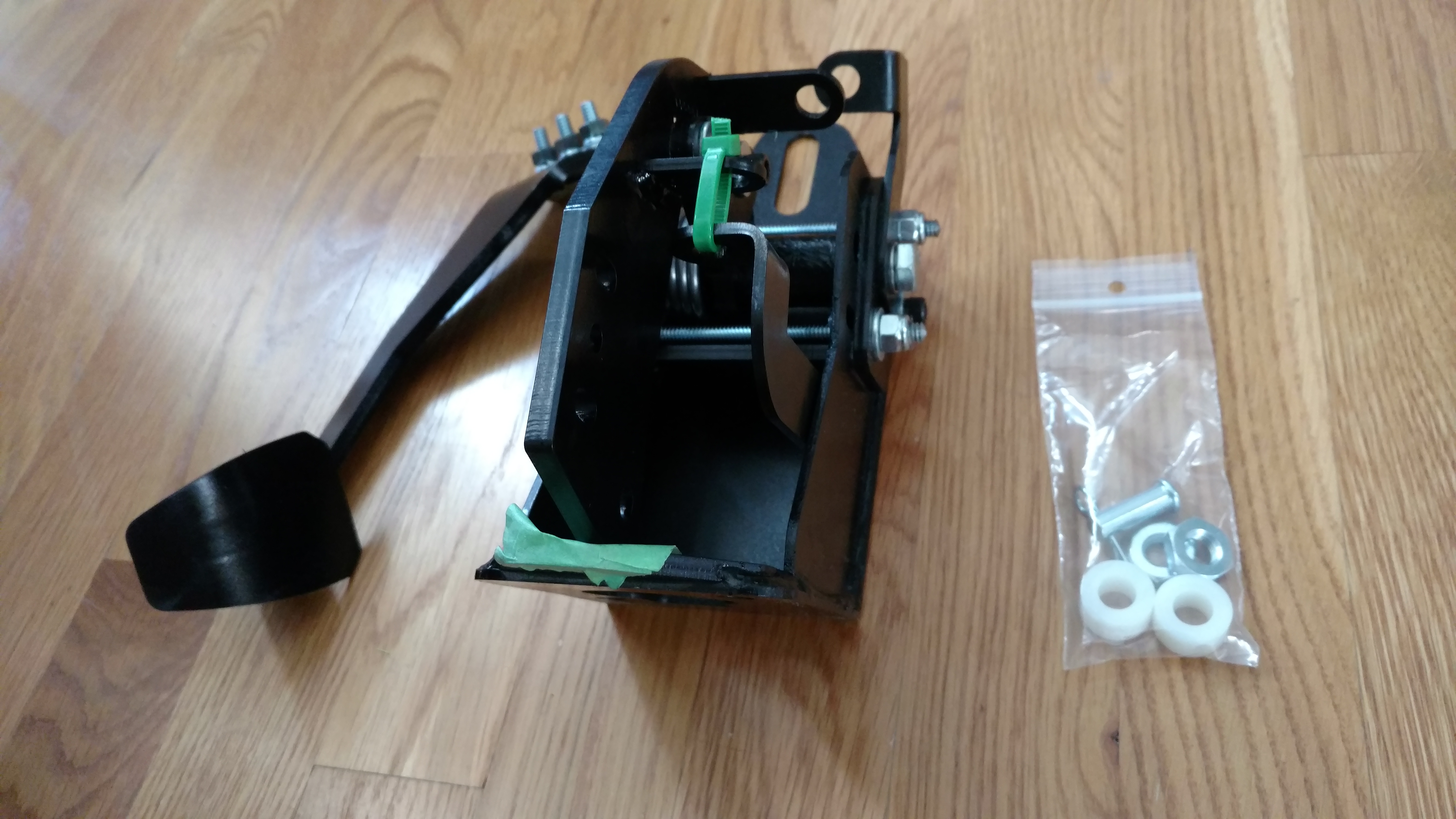

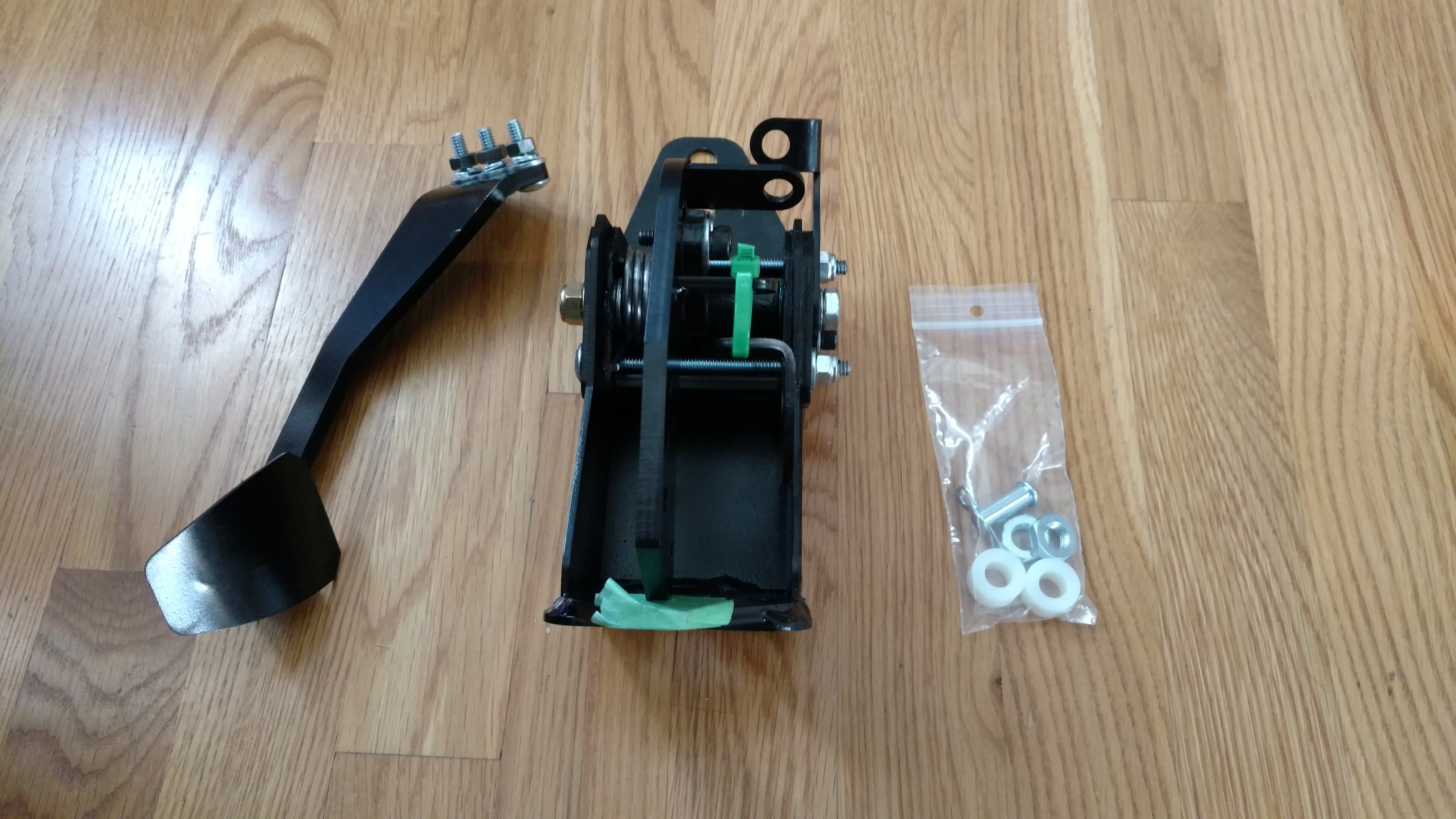

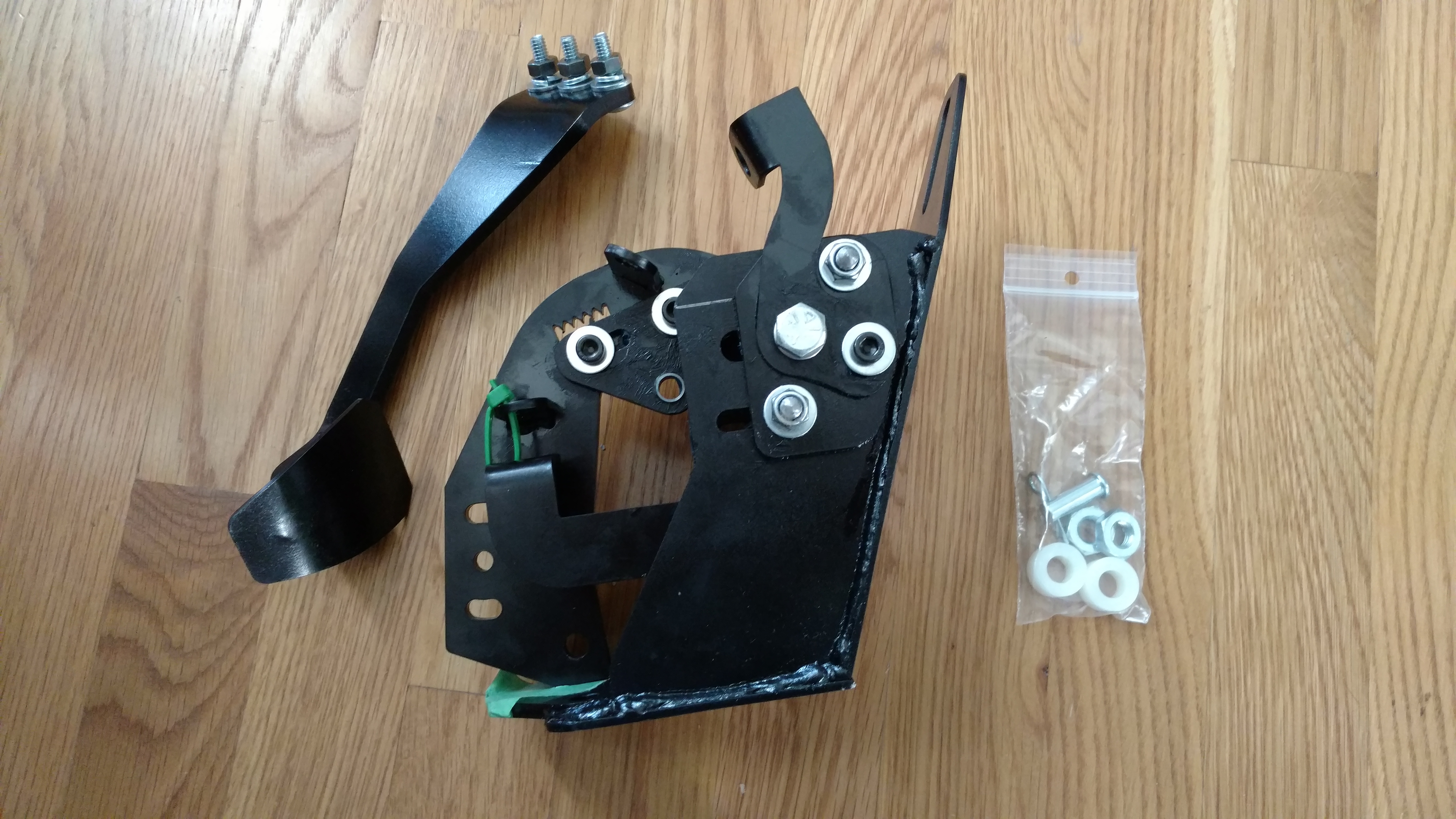

Just received my v3. These were the 3 things in the box: assembly, pedal and a baggie of hardware. Looks like everything else is on and ready to go.
I'm excited to get it installed when I have a chance. I'll have to go back and re-read all the pages in this thread first. I want to make sure I feel comfortable with it all before I go f*** something up.
