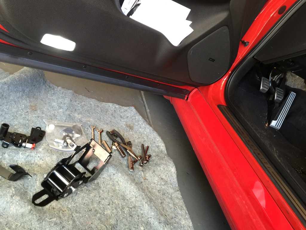

installed mine today, took about 2 hrs. i'm in love with the car again. was suppose to be my 1st mod but got side tracked with the spring swap. i'm been hating the pedal ever since i got accustomed to it.
the RJM arm is the best quality engineering and parts! i did two turns back and on the clutch rod turned it back till it was flush with the fork. Got engagement around 1.5-2" off the floor

one thing tho.. i can really hear that blasted throw out bearing now more than before.

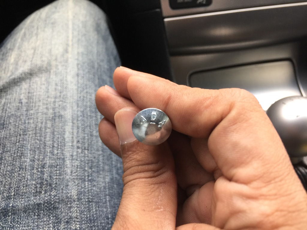

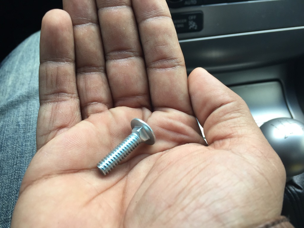

so figured out my issue a few weeks back.. in all the adjusting tuning.. i forgot along the way that i have to push in the pedal 1/2 way before locking in the adjustment ****.
i've also adjusted the hell out of this thing to find where i liked it.
**** from 1-3 turns clockwise
pedal height in relation to the brake pedal
and finally settled on 2.5 turns clockwise and height level to the brake (after the freeplay). i choose this based on the engagement high, amount of engagement and also in relation to the feel of the gear and stick engagement (how easily it was to get the car into gear). Since i have a SS the two adjustments did play a part in gear engagement.
also in the numerous adjustments i began stretching pedal bolts to breaking..
found exact replacement in HomeDepot bolt isle look in the loose bolt bins for ADA
