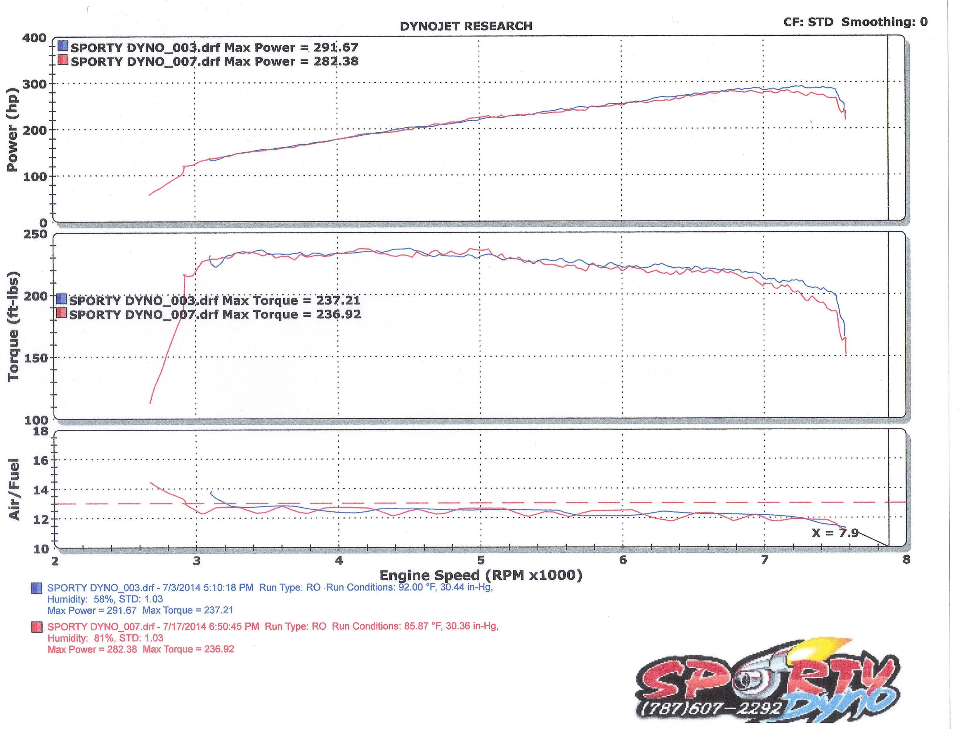

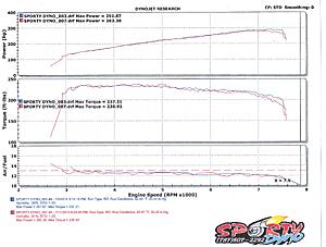

here is more "proof".
This is before and after the M370 with no tune:
This is before and after the M370 with no tune:/IMG]
I'm sorry but I wouldn't call this proof. Days and days are in between with very different weather conditions.

Likes: 95
From: Puerto Rico
Out of all the mods I have tested, this was the only one to lose power. Even if the conditions varied by day, the loss at the top end is indisputable.
I agree. They flat line pretty hard around 7000k
