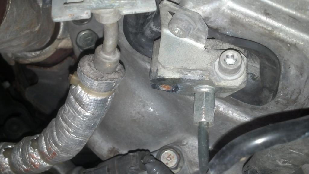

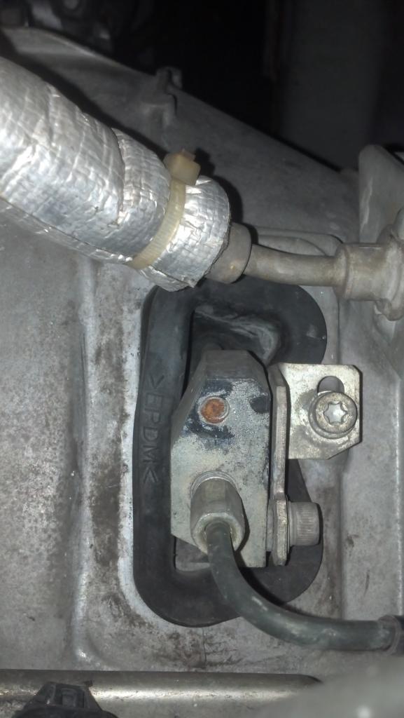

Originally Posted by Jsolo
I haven't actually done mine yet. Will be doing it this spring. I'll likely go with whatever DOT4 I can find on store shelves. I don't track the car nor do I drive it hard. The comments were made after crawling under the car to see just how accessible that bleeder screw was.
So I had the same idea... I crawled under the car to see how accessible the bleeder screw was and I found this nightmare (pictures below). It seems like someone over-tightened the bleeder screw and sheered it off! I've had the car for about 6 months now and figured it was time to change the fluid. Guess I'll have to try the turkey baster method for now...
Anyone have any advice on what to do here to get this fixed?

Old Jan 1, 2015 | 07:46 PM
Dough1397's Avatar
Dough1397
Joined: Jul 2011
Posts: 469
Likes: 62
From: GTA & K/W, Ontario
I also sheared my bleeder on my stock CSC. You'll have to use a drill out/extractor to remove what is left. Presoaking with some penetrating fluid would be wise.
I didn't bother doing this, I figured I'd get my dealer to fix it during the next oil change. The CSC failed before my next oil change.
