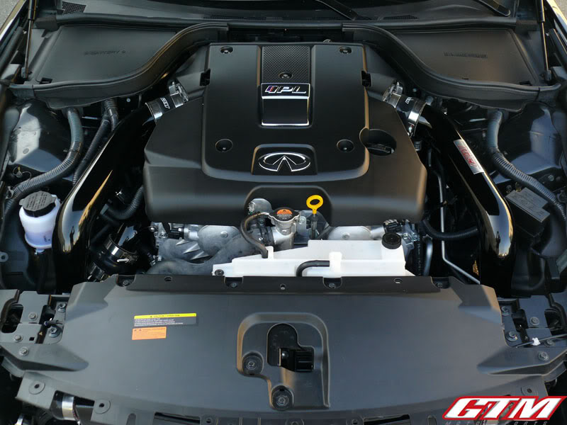

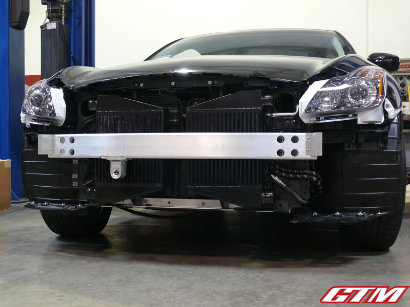

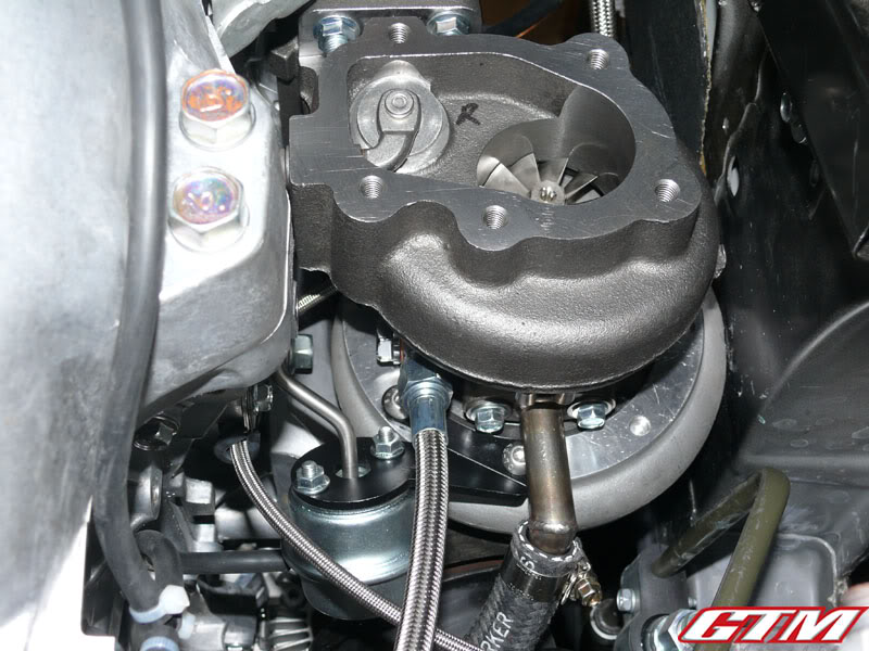

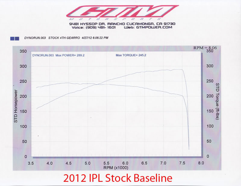

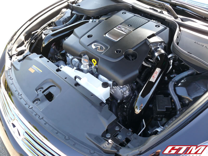

For starters, our new kit is designed to retain the factory crash bar, can accommodate both manual and automatic transmissions as well as any aftermarket or stock exhaust system preferred by the end user. Here are some pictures of the kit and the baseline dyno run.

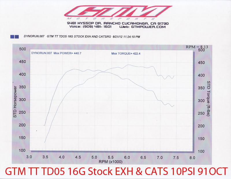

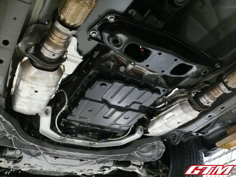

For the emissions conscious enthusiast, we tested our new TD05 Twin Turbo Kit with the stock cats and cat-back exhaust. Despite the restriction, the kit still delivers 440whp and 422wtq on 91 octane pump gas at 10psi of boost with an automatic as seen in the dyno graph below. As you can see, the restrictive stock exhaust causes torque to plummet at high rpm. Despite this being an IPL with the higher flowing exhaust, it is still far too restrictive for a forced induction car.

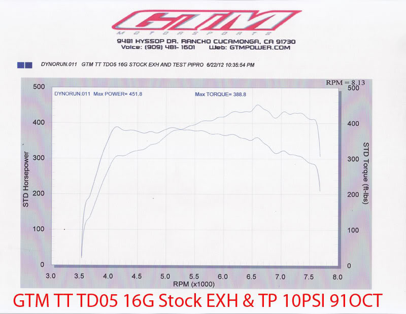

Opening up the exhaust with a set of test pipes still keeps an understated exhaust note while delivering more power and torque at higher rpm as you can see in the dyno graph below. As you can see, torque doesn't fall off quite as hard at high rpm with test pipes. That said, there's still room for improvement in the exhaust department.

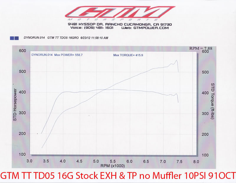

For best results, a less restrictive exhaust is a better way to go. Shown below are the results of our test pipes and no mufflers; still at 10psi on 91 octane with an automatic transmission. As you can see, torque stays flat all the way to redline once the exhaust is opened up.

So with this setup simply removing the exhaust past the test pipes added 101 HP and 27 TQ at 10 psi?

Will the stock cats hold up with this setup? Interesting how the highest low-end tq figures were achieved with the stock exhaust
