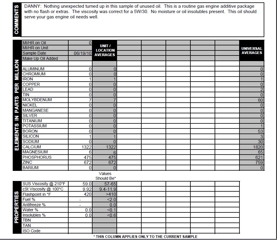

Virgin ENEOS sample

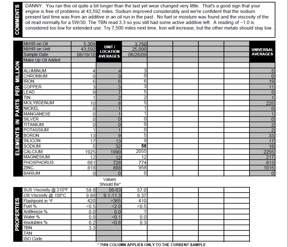

UOA

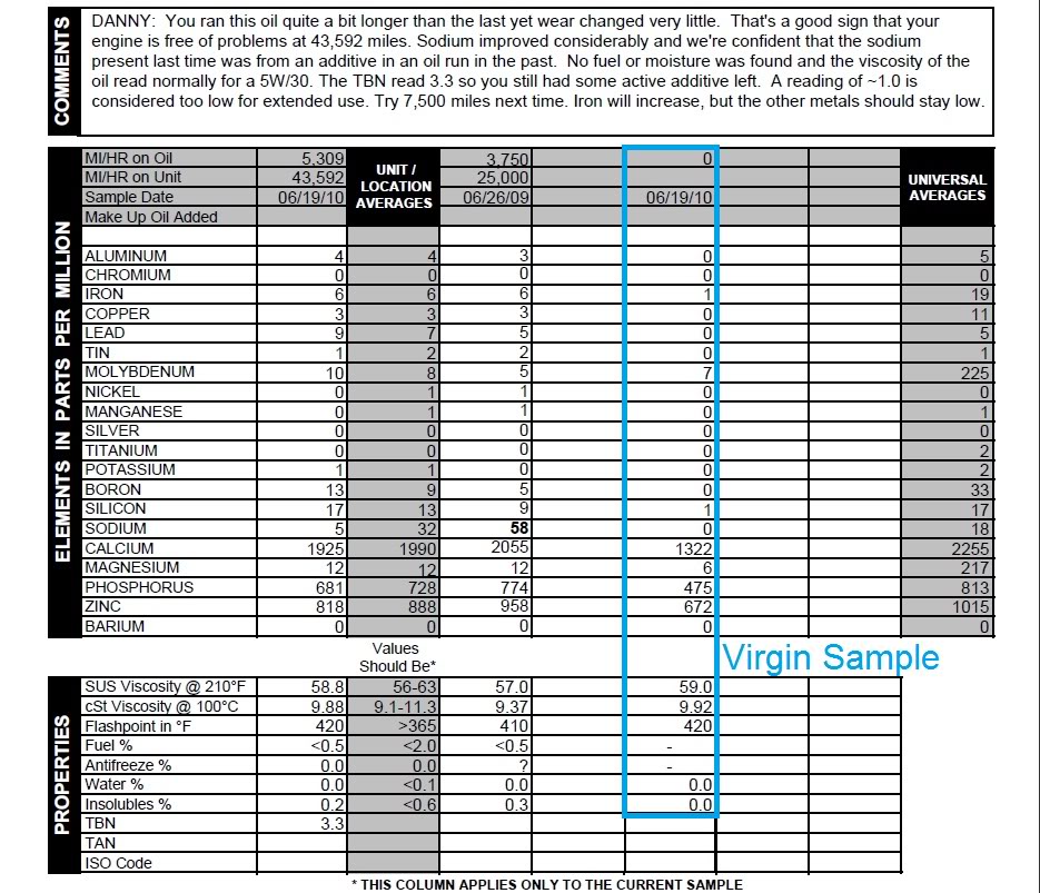

Combined.
Looks good to me but I'm no expert. What do you guys think?

Im no expert either, but the good news is it didnt shear at all and your wear metals are all low.
Im kinda shocked at the additive package, its pretty simple and pretty basic. If you check out the other VOA's of other common oils, you will see that its probably the simplest of them all. Compare it to the recommended Nissan Ester oil. Its got more ppm of everything the Eneos has and a ton of Moly.
https://www.myg37.com/forums/engine-...-analyses.html
Calcium and Magnesium are detergents, and phosphorous and zinc are anti-wear additives. Thats it. Simple.
And this is also a semi-synthetic oil, correct?
If you told me that you had a semi-synthetic oil with this basic additive package that didnt shear and easily held up and looked good in our cars for 7500 miles, I would have called you and BB a liar.

As another pure amateur who for some reason has read a thousand of those UOAs in the past year, I like it . Looks like it maintained viscosity for 5000+ miles.
The website stats Mike posted in the other thread claimed an initial TBN of 6.4. So that's looking good too, like they said.
Glad I just put the stuff in my car a few weeks ago. I'll get a UOA done when I change it -- I'll be running 5K also.

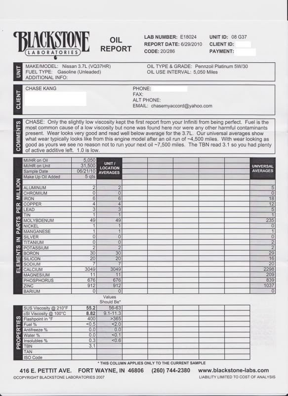

So here's a recent 5000 mile UOA on PP on a mature G37 engine:
Wear metals even better than ucla bruin's latest report. But ending viscosity thinner. TBN about the same.
PP at Walmart costs a lot less than Eneos at Amazon. Is Eneos worth the extra money?

Are there any other PP UOA's around or is there just only 1 to go by?
BB showed the Eneos can go almost 10k miles without shearing, has anyone driven the full 7500 on Platinum with a UOA?
I never trust just one single piece of data in a data set because as we have seen with many other oils, UOA's can vary dramatically from driver to driver depending on how the car is driven...... although I feel like a broken record and have said this in other threads before.
And when you say "even better", we are talking about a few PPM here. Depending on WHERE and WHEN you get your oil from to send it for a UOA, it will vary a few PPM.
When you are draining your oil, if you take the oil out immediately and compare it to the oil which you take out at the end, you are going to see a difference in PPM across the board.

Originally Posted by ucla bruin
Sure looks like your VOA lab report is way off. Boron, Calcium, Zinc, Phosphorus and Magnesium are all significantly higher on both your UOAs (and both Black Betty's UOAs) compared to this VOA.

Danny,
Send an email to Blackstone and have them re-run your VOA sample. Re-send them your VOA and UOA and point out the calcium, phos, and zinc. They will re-run it for free because its not right.
