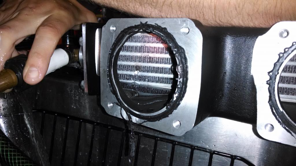

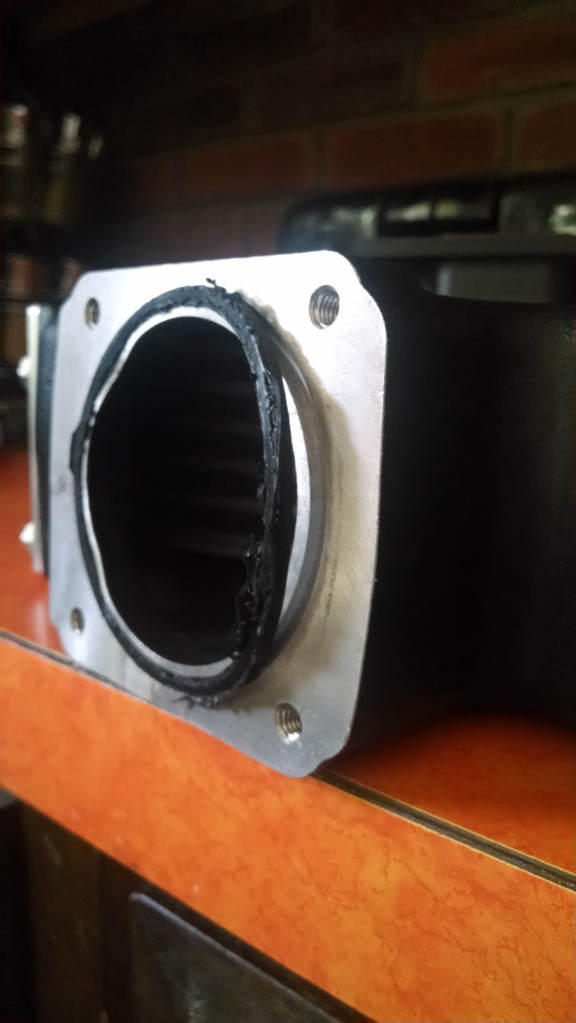

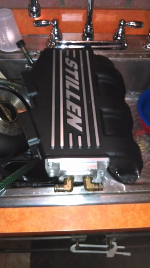

Okay guys who have this system LOOK OUT!!!!
Long story short I have 18k miles on the kit I bought new from Stillen in 2010 so warranty is up. Well the other day my car hydro locked from Stillen's manifold inter cooler. they told me this is the first that they have seen this issue and I need to buy a new replacement for with with the whole manifold for over $1100. Is it me or is this unreasonable? At this point I think this maybe a flaw in the inter cooler and can cost you a new engine. Buyers beware. .
install was correct according to trent and the valve bodies have no connection to hydro lock as you can see this is an inter cooler issue not valve body. the install was done through a stillen dealer they sent me to get the install done in the first place. the o rings as see in this pick show the rings where in fact installed correctly and somewhere along the line of going to local shops stillen paid for trying to get the car running right may have added it at any point. the car took three years to get running without limp mode with verious tunes. Stillen has been great to me and I am now way saying they are bad. Im clearly posting my newest issue and think all should be aware and give me input on the issue as stated in post.
Originally Posted by future370zzz
How can you tell if it's RTV silicone or just the o-ring that has melted from the heat-soaked manifold?
I'm not a mechanic so that's why I ask.
its the o rings that were in the kit. ill get a better pic but her is one i got before i cleaned the peals off.
