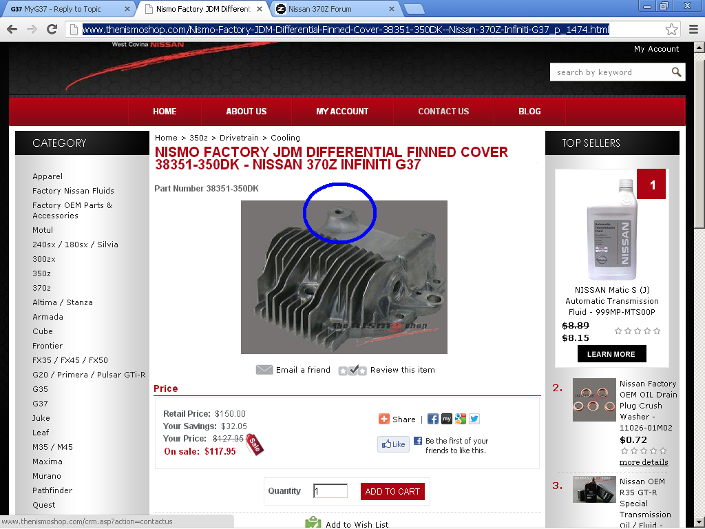

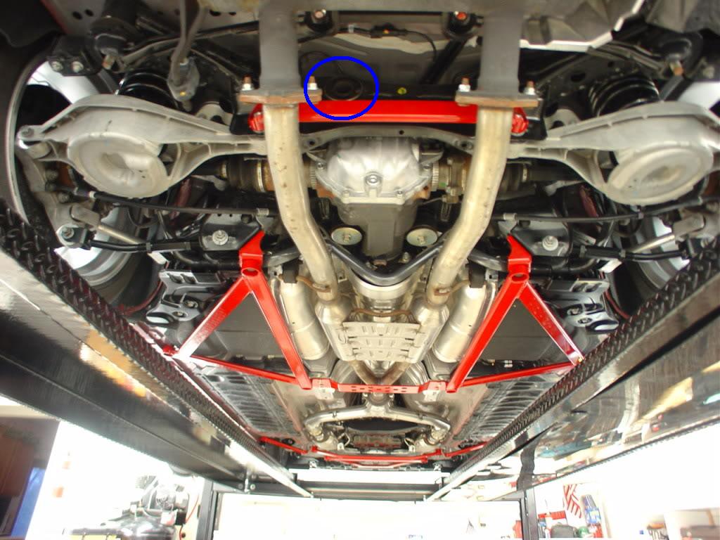

When I installed the 4.083 gears in my 350Z I had to drop the entire pumpkin out of the car to get the rear diff cover off. So I'm assuming the same has to be done if you want to put on the finned cover. There is a bolt that goes through the rear diff bushing and into the cover. You may be able to squeeze the old cover out the bottom by taking that bolt out, but I doubt it.
I've circled the bushing that the bolt goes through and goes into the diff:
Here is the Nismo diff cover with the same bolt location circled:
Here is the link for the cover: Nismo Factory JDM Differential Finned Cover 38351-350DK - Nissan 370Z Infiniti G37
If I ever put the 4.083 gears in my G then I would want to install the finned cover just for looks lol.
