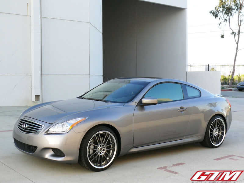

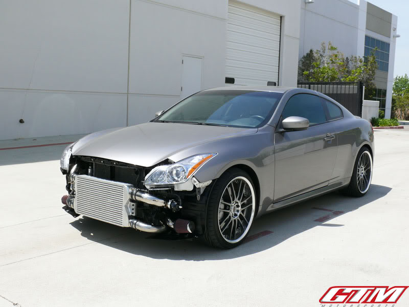

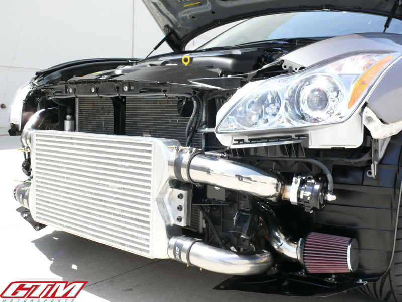

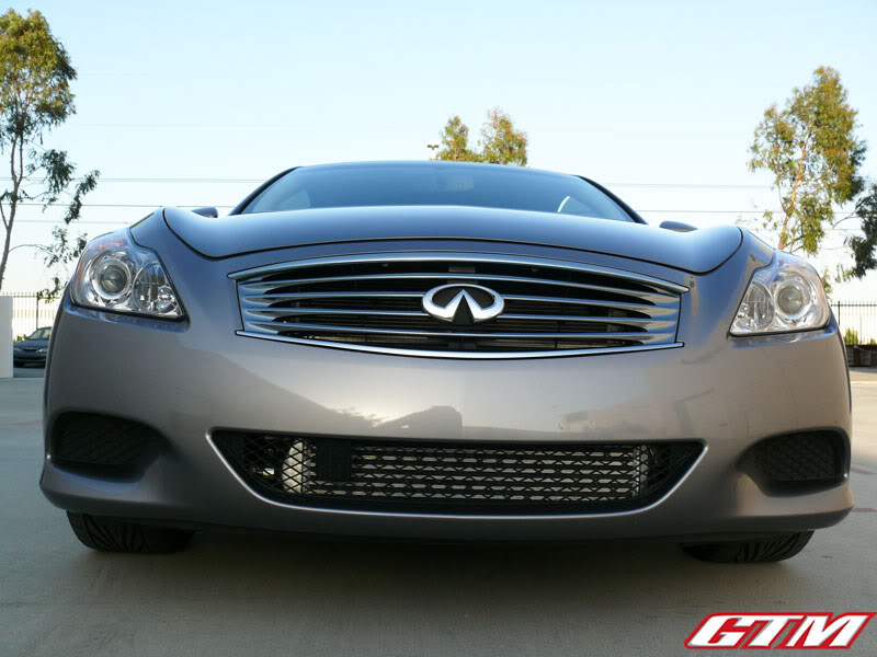

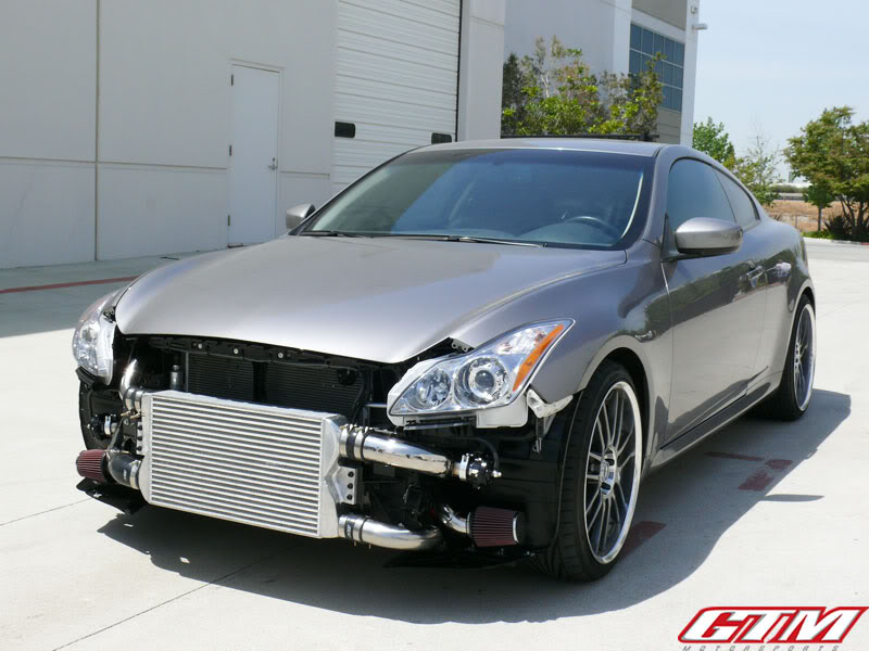

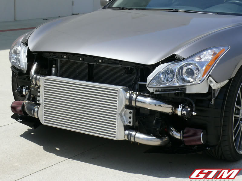

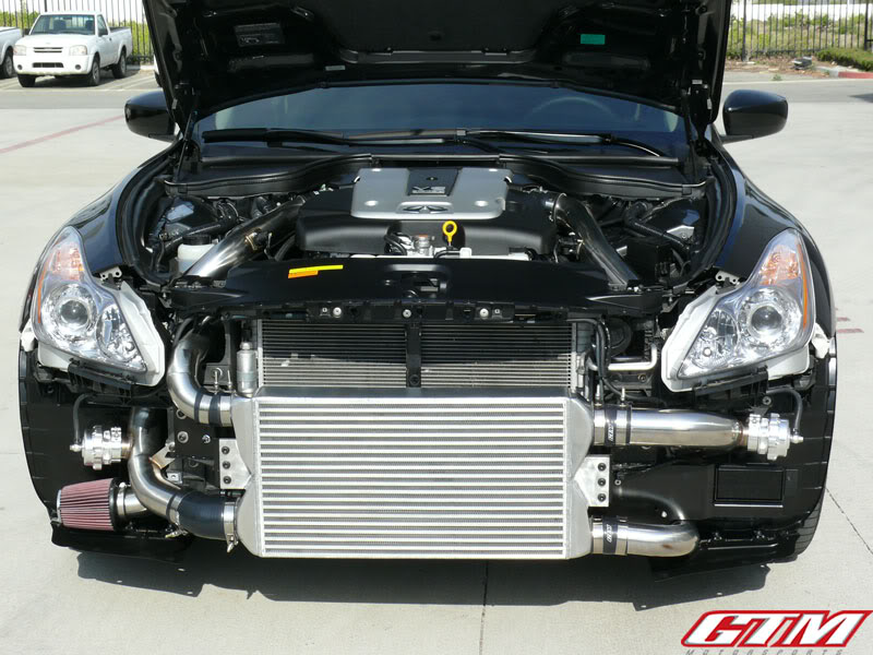

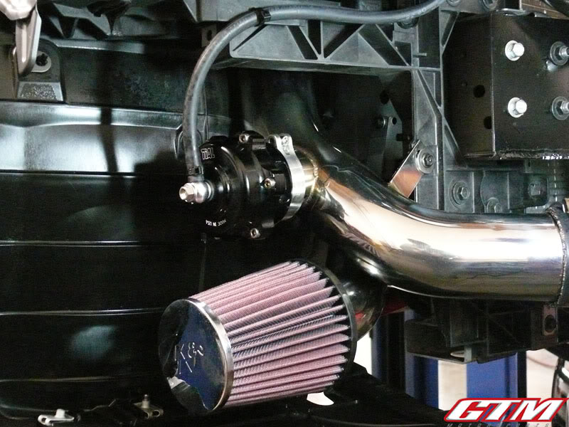

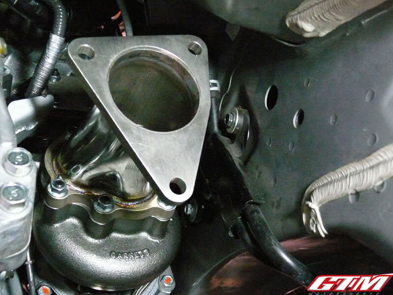

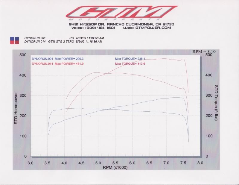

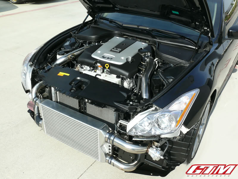

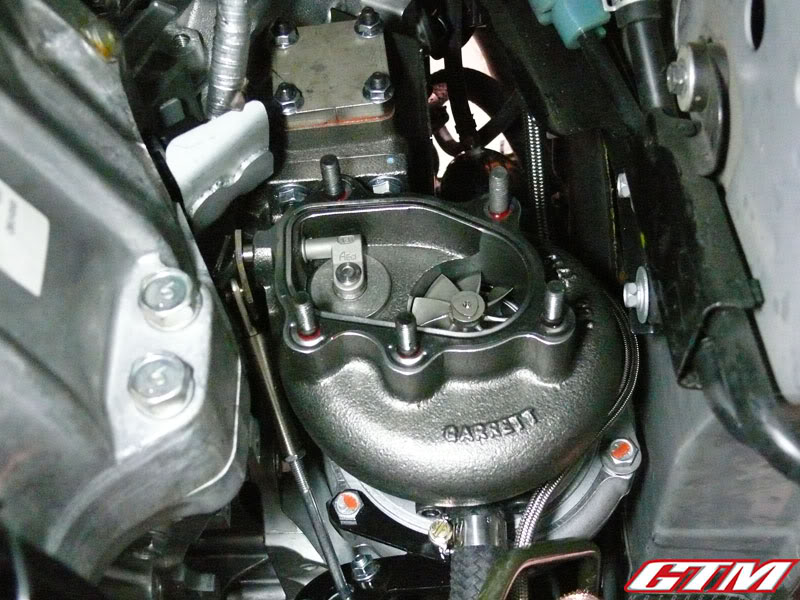

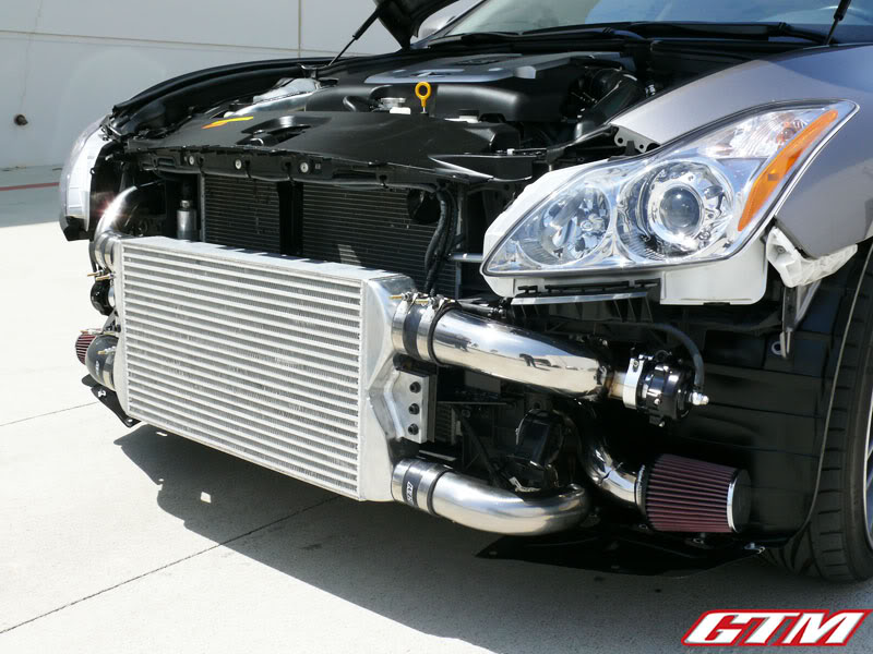

This car came in pretty much stock except for an exhaust and wheels. Another great example of what can be done with our out of the box kit and pump gas. This is also one of the first cars to have our GTM Resonated test pipes, and they sounds great! Not bad power for an automatic transmission either!
GTM Stage 2 Turn-key Twin Turbo kit
-Internal waste gates
-GT2860RS .84 A/R
-GTM ECU Flash
-GTM A/T Supplement kit
GTM Resonated Test Pipes
GTM Valve body Upgrade
Fast Intentions cat-back (already on car)

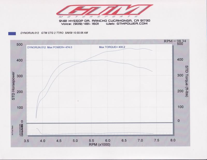

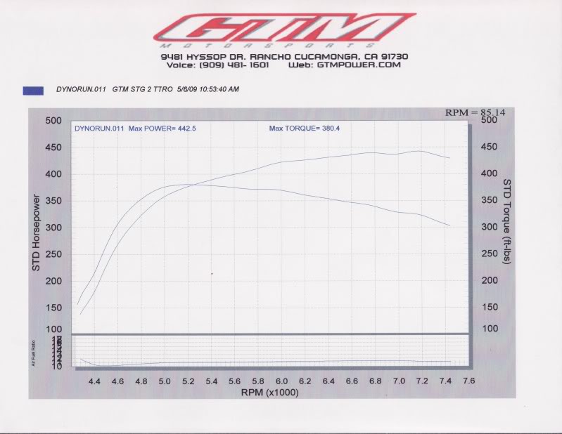

91 Octane, 10 PSI, before and after:
91 Octane, 9 PSI:
91 Octane, 6 PSI:

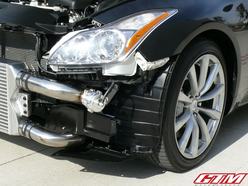

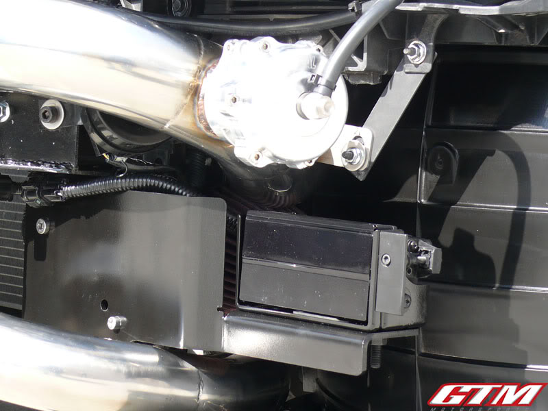

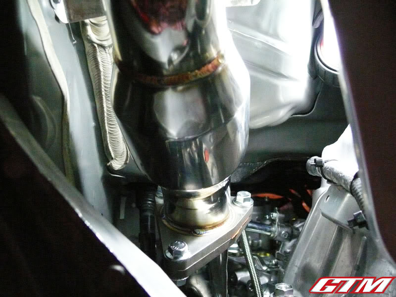

Will you be able to keep full functionality of the ICC and preview braking on cars equipped with the Technology package? In notice that the FMIC is directly behind the location of the sensor for these in the loser center grille.

Originally Posted by IvoryG
Nice. Is this on the flash tune or are you guys tuning each car?
This is on the out of the box flash, we did not change one single parameter on the tune. It is always a good idea to have the car dyno'd after installation to confirm that everything was installed correctly and everything is operating smoothly. It is also nice to know how much power you are making
What allows us to package our turbo system with and engine management solution that does not have to be tuned, regardless of elevation or location, is the fact that we are utilizing the factory ECU. Since we are doing so and retating the factory MAF functionality the tune is always spot on. The ECU flash also utiliziles the factory wide band 02 sensor feedback to make sure that the A/F ratio is always inline with our target map.
The map included with our turbo system is tuned up to 1bar of boost pressure (~14.5PSI), although we don't recommend running this high amount of boost on a stock block, running boost over ~10PSI should be used in conjunction with 100 octane fuel for maximum safety.
Yes! For cars equipped with the ICC we offer and supplement package that will relocation the sensor and still retain all factory functionality, below are pictures of another G37 we are finishing up that has this supplement kit installed.
Note: This will require the ICC to be re calibrated via the Consult III, if your installed does not have this tool you will have to have this done at your local dealership. (or send the car to us )
