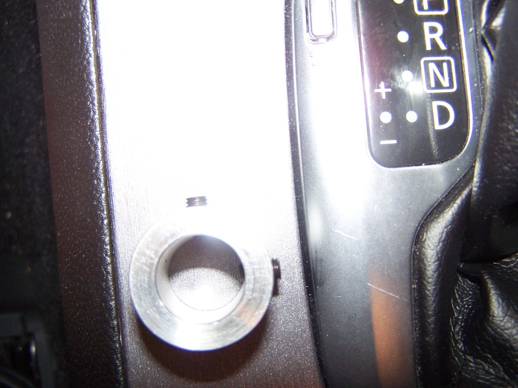

First off, want to say thanks to Charles @ B2 Autodesigns for getting us a nice price on this high quality part. The shift **** comes well packaged and is machined to a high quality fit & finish.
This is my version of the install, there are a few ways to handle the mating of the shift boot.
Keep in mind, if you cut the OEM boot I'm not sure you can buy just the boot from Infiniti/Nissan, the whole shift column/panel is quite expensive, just want to give a heads up. If anyone can verify if you can indeed just buy the boot, let us know.
Here's some install pics & info~
To remove the OEM ****, just hold the collar on both sides and firmly press down, the collar will snap off and you can slide the boot down to expose the "U" clip.
Just pull the 2 outward prongs out and slide the clip back, then just pull up on the **** to remove, then replace that clip back on the **** since it's very small (and probably costly to replace).
Attachment 136723

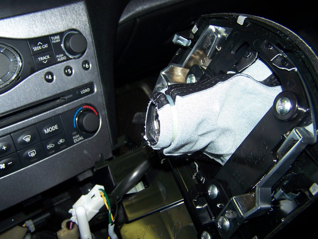

Once you get the **** off you need to remove the shift console cover, this is simple but you MUST use a plastic pry tool of some sort, I have a variety of these cheap Harbor Freight body panel tools that I use. If all you have is a small screwdriver try to protect the panels by using a couple thin credit cards on the outside of the screwdriver head. You then just pry up in each rear corner to release the pawls.
Attachment 136724
Once you get the back of the panel lifted you then need to pull down on the front (above the ashtray). You then need to move the shifter into neutral, just push the white release rod to get out of park. Once in neutral you can then get the cover up and over the shifter, just be careful not to pull on the wiring. Just set it on its' side and pull the boot inside-out so you can cut the zip tie that holds the collar, need a sharp exacto blade to cut it clean, be careful as you don't want to cut the boot
Attachment 136725
After you cut the zip tie you can decide what you want to do w/ the mating of the boot. After some trial & error I decided to remove the OEM collar and pull the boot up to the straight section of the shift ****. This setup allows the boot to be in the best place without interfering w/ shifting.
The black plastic sleeve goes inside the collar w/ the 2 set screws. This is a very tight fit, which is good, but you need to get it down just far enough, otherwise you'll have to use a gear puller to get the collar back up (don't ask me how I know )
Once you decide on your boot setup, put the boot back over the shift rod, then put the panel loosely back in place
Put threaded lower tapered piece on first
You set it up so the LONG set screws are at 12 o'clock and 3 o'clock when looking straight down the shift rod. You place the plastic sleeve just barely on the rod w/ the full cutout at 12 and the half cutout at 3, the cutout MUST be on top w/ the closed section facing downward, this will allow the sleeve to slide down w/ the collar when the set screw is inserted and tightened down just enough to contact the shift rod, hopefully this makes sense.
Attachment 136726

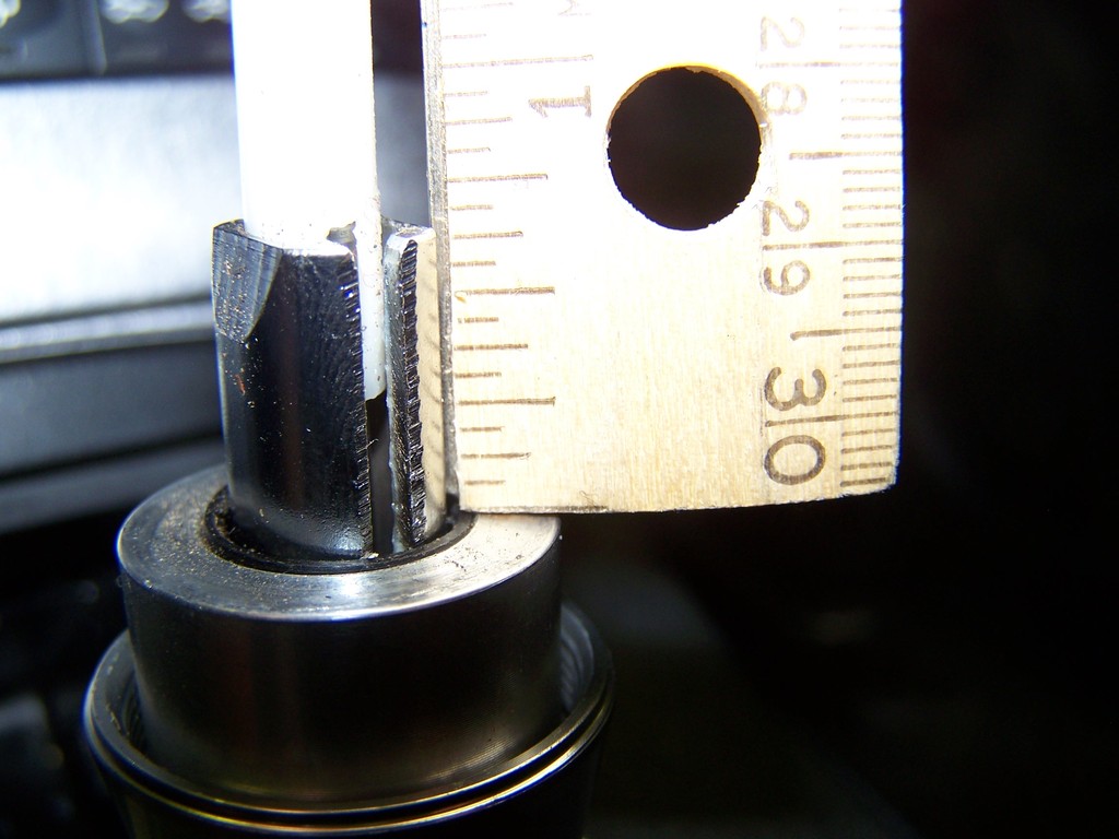

Use a extended socket to careful hammer the collar down, be sure the plastic sleeve is lined up properly and the 3 oclock set scre is in far enough to hold the sleeve as you hammer it down.
Attachment 136727
Be SURE to only go down this far (5/8") (again, don't ask me how I know).
Attachment 136728
Once you get it to the proper depth you then change the long set screws for the shorter ones, then just tighten them up real snug
I then like to apply teflon tape to the threads just to make it easier to engage and remove.
Attachment 136729

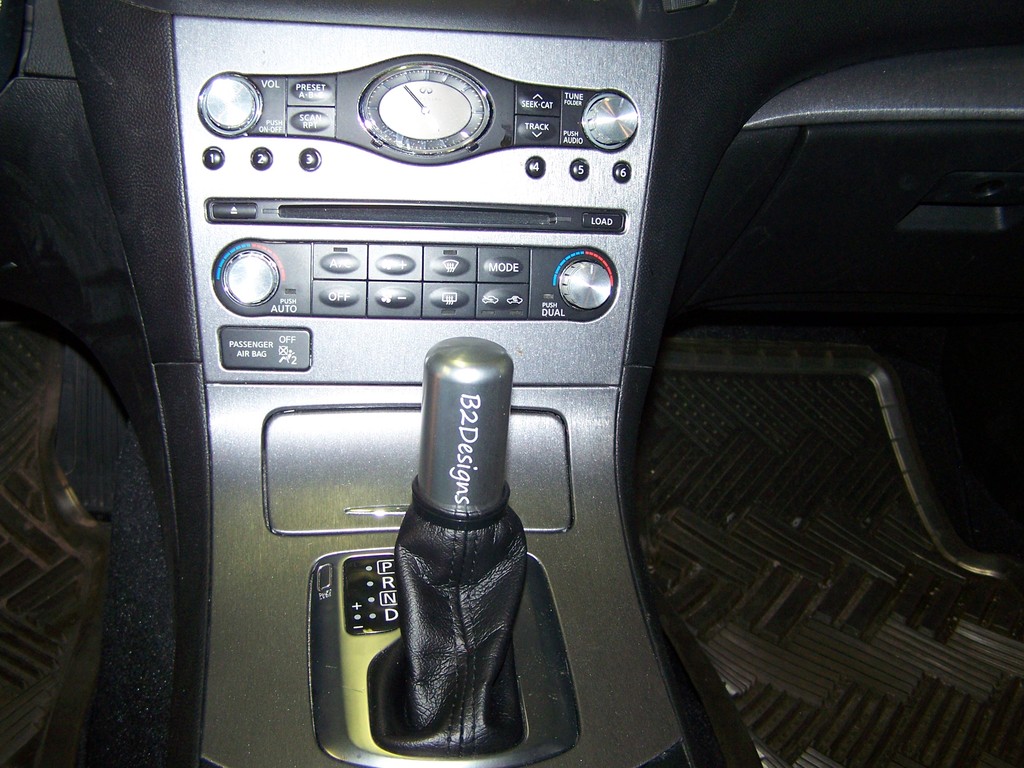

You then install spring and thread the **** on, pull the boot up, and presto! The zip tie is temporary FWIW, I think I'll be using a thin amount of the boot and put it right above the tapered piece and just clamp it down by threading the **** down on it.
Attachment 136730
Attachment 136731
Attachment 136732
If any of you get this **** and try a different boot mount please post up pics & info on this thread, would be nice to see what other options you can try.
Brad
Took about 90 minutes FWIW.

When I try to put the piece with the screws with the black sleeve then black sleeve doesn’t go all the way down it doesn’t let me. And the screws don’t wanna go all the way inside the piece so it gets blocked while going down
Old Oct 17, 2020 | 11:12 AM
  #38
hexotic's Avatar
hexotic
DIY Cheapskate/Mod
Joined: Oct 2015
Posts: 1,864
Likes: 672
From: Richmond Hill, ON
The black bit has a slot in it for the set screws, make sure thats aligned first and the screw is twisted in just enough to cover the thickness of the black piece. Thats when you can hammer it on with a socket.
