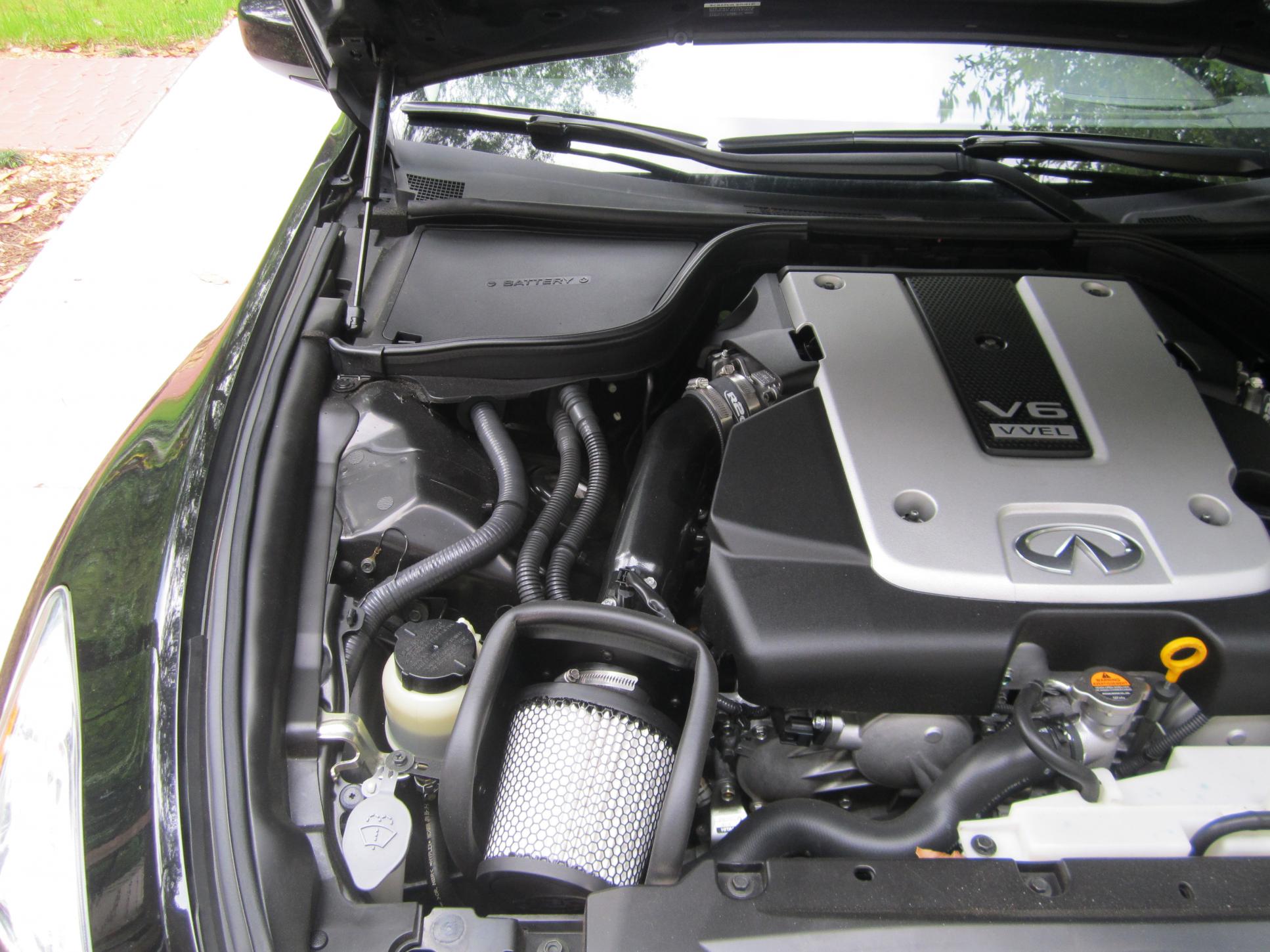

Hammerhead2501's Avatar
Hammerhead2501
Joined: Mar 2014
Posts: 4
Originally Posted by gsteigerwald
Check out my post about how I installed my sub/amp, everything you will need will be in there, from running the wire to wiring the amp up.
https://www.myg37.com/forums/audio-v...l-finally.html
Thanks but, what's under your hood and what's under mine seem a little different.Subwoofer wiring.-img_1537.jpg

gsteigerwald's Avatar
gsteigerwald
Joined: Oct 2013
Posts: 186
Likes: 26
Nah same exact thing, you have to take off the plastic piece covering the battery and take off the plastic piece covering the grommet where you have the run the wire through. They are both easy to take off.
To take off the battery cover there are push tabs where you just use a flathead screw driver and pop them off. Then after that is removed, you can remove the piece covering the grommet. Its the plastic that is right up against the bottom of the window as you can see from my picture that I removed it.
