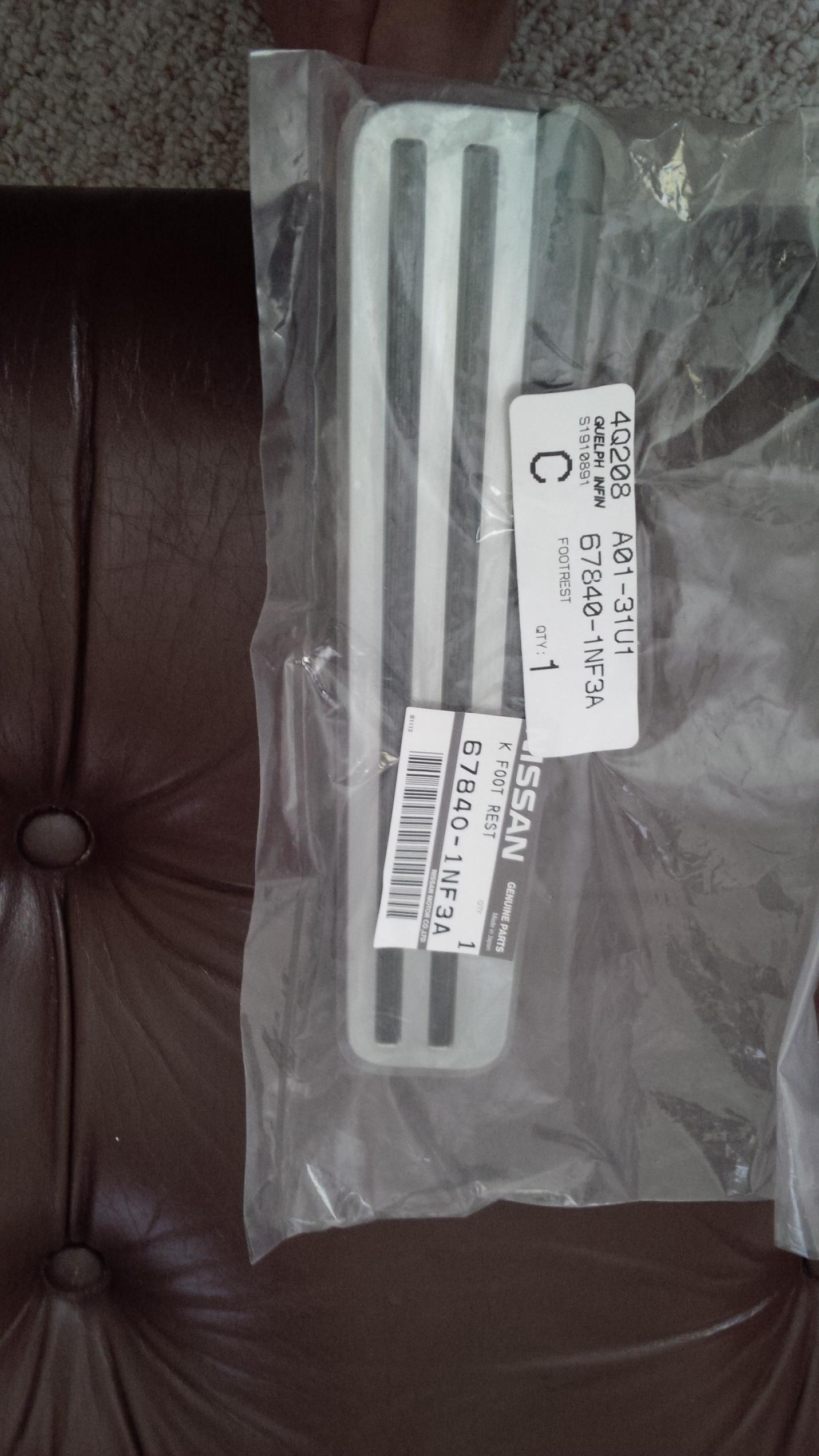

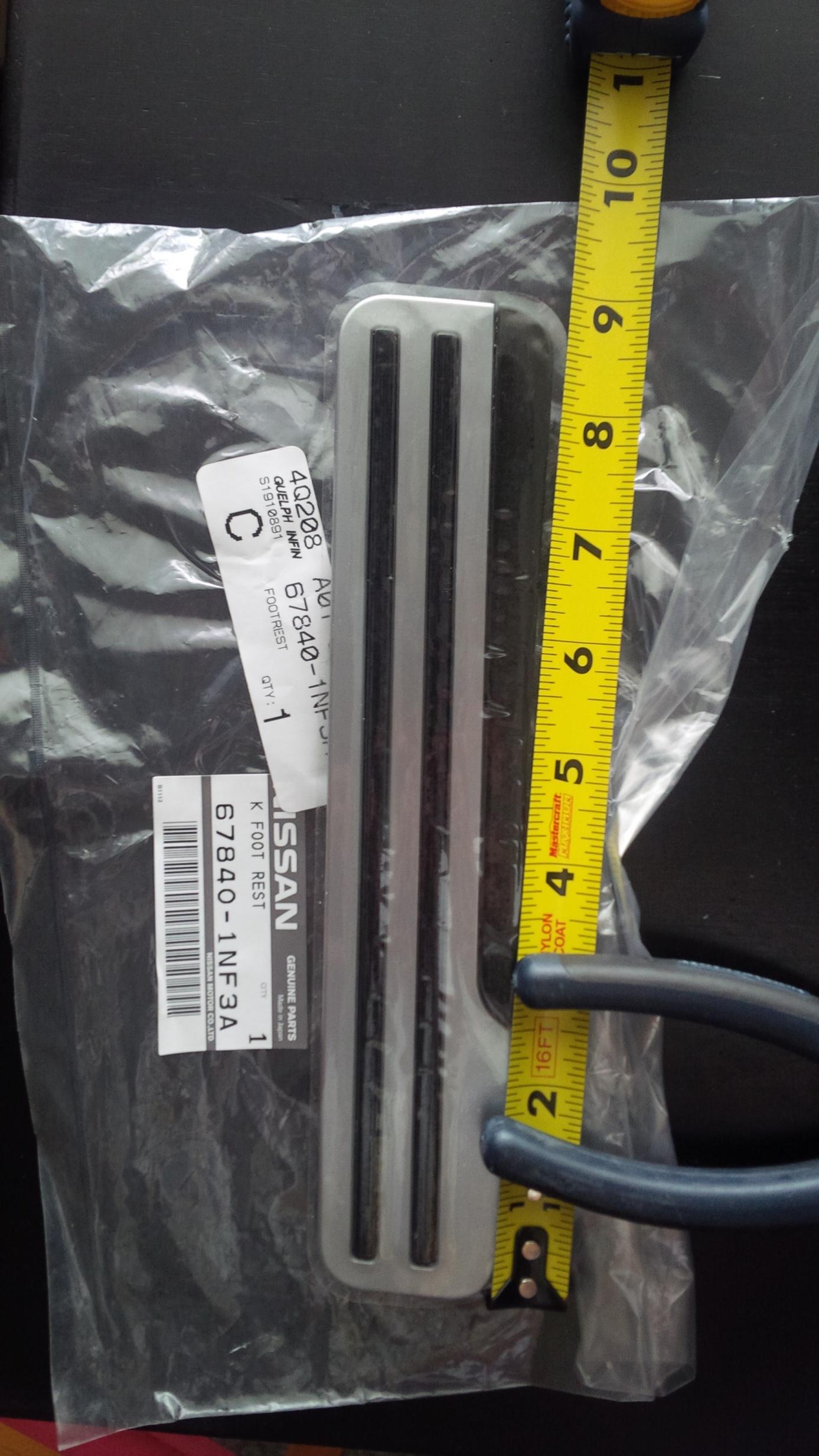

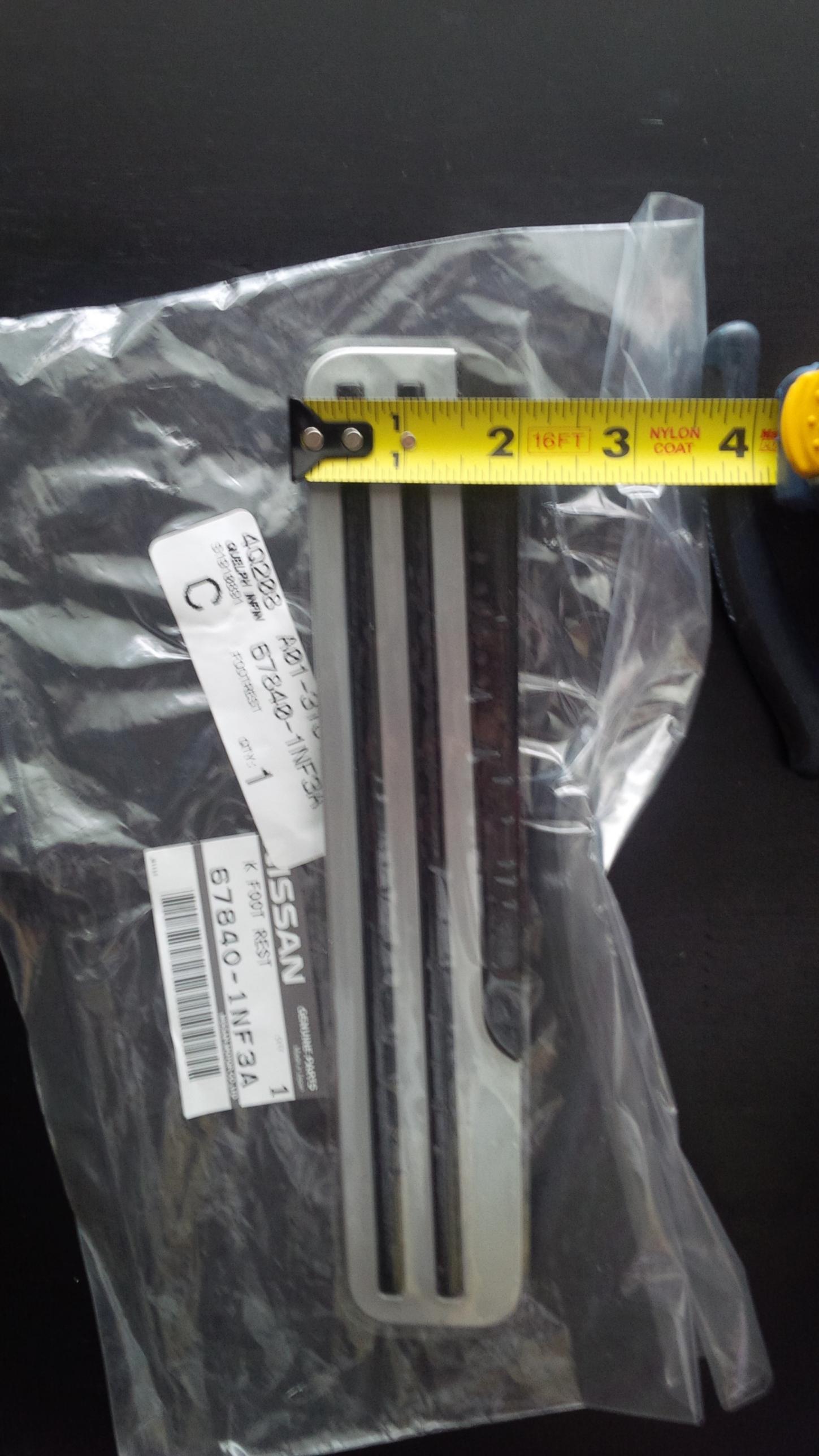

Originally Posted by Dough1397
In my 2008 6mt, the foot rest is 9" tall, 1 5/8" wide at the base and 1 7/8" wide at the top. See pics 1-3.
It is indeed removable and replaceable, there are 6 pins on the backside of the foot rest which go through the carpet. Pics 4-5 show the pins and how this would separate from the carpet. The top two pins were already loose, the lower ones were caked on and I didn't bother touching them (pic 5 shows plenty of salt stains ). I must remember to get the vacuum and perhaps clean this up properly when I get my replacement parts.
I will be placing an order for:
1x 67840-1NF3A (foot rest)
6x 74985-1NF0A (clips or pressure washers to keep foot rest in place)
I finally received 1x 67840-1NF3A (see pic). It is the right size to replace my 6MT dead pedal (pictured a few posts back).
