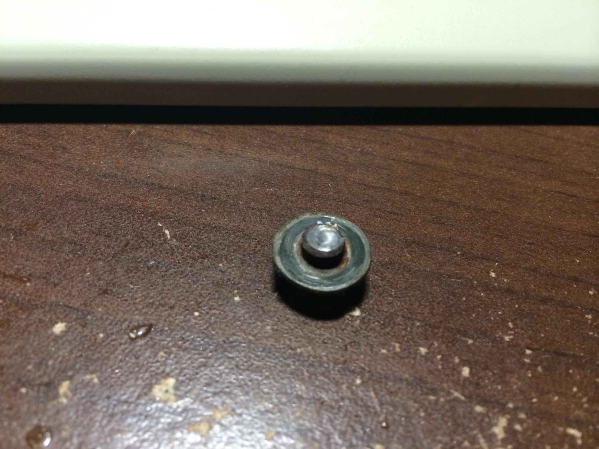

Finally I decided to follow the instructions, First off I went to princess auto and bought all the supply needed
12 ft. of 8 gauge oxygen free copper cable
6 individual 8 gauge ring terminals
3 individual 4 gauge ring terminals
Crimping tool and wire stripper
some zip ties for neatness, if you desire (I didn't use any)
also bought flux and solder
total cost over $80 well worth it plus I have
I couldn't find the 4 gauge ring terminals there and at the Canadian tire so I had to go to go to future shop, also bought the wrong 8 gauge ring terminals, best place to get them best buy or future shop in automotive section.
while i waited for the car to cool down I decided to remove the g37xs and that took a while lol.
So I followed the instructions, I added 1 inches to every wire just in case **** happen (insurance).
As I come to do step 4, the bolt broke so decided to put it where the air filter was.
Step 8 same thing happen bolt broke where I was suppose to connect F
Step 10 same fcking happen again lol bolt broke thank god I had another small bolt.
final product was great.
Now i have to get a kit and try to remove all those broken bolts and replace them

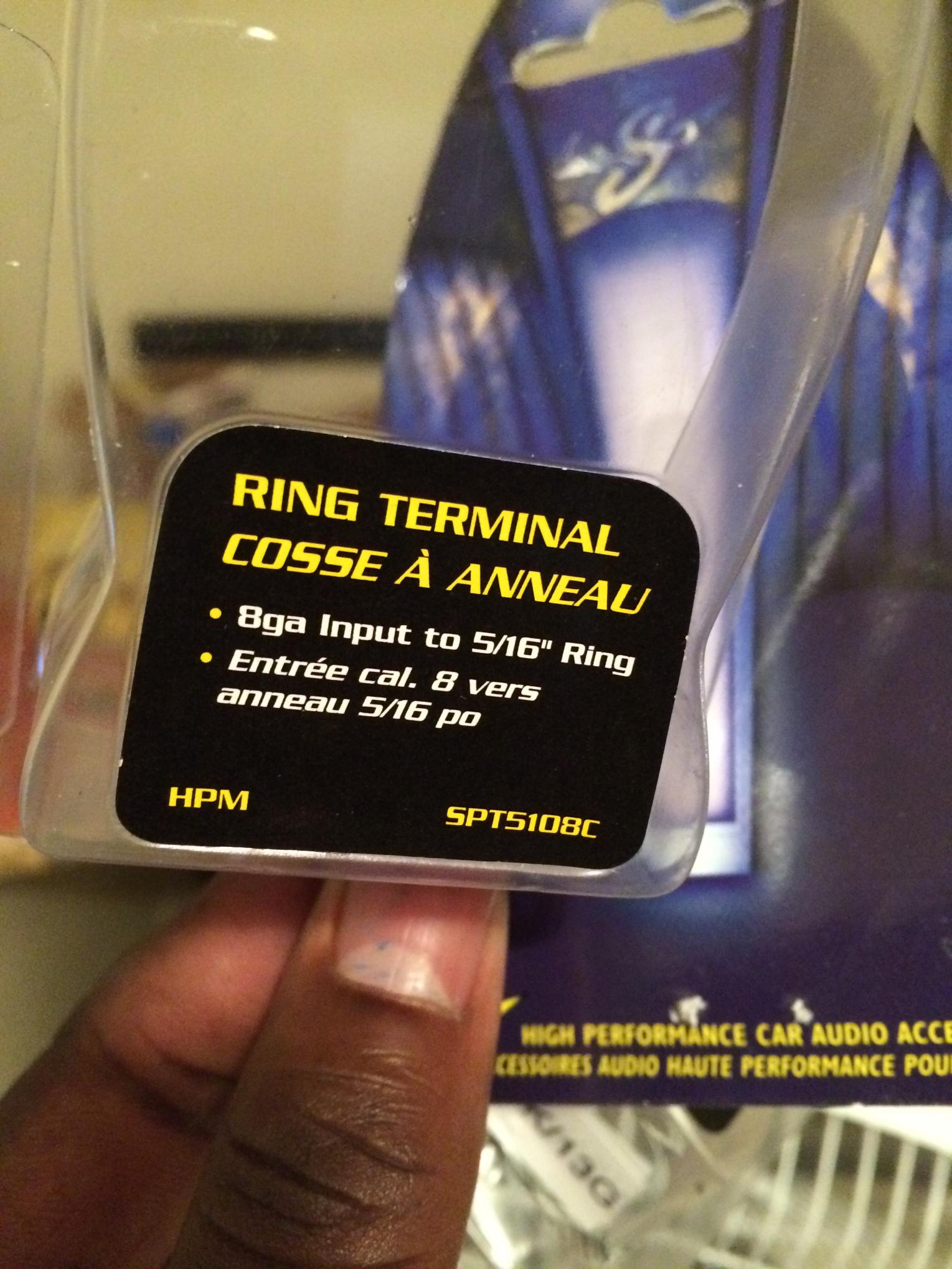

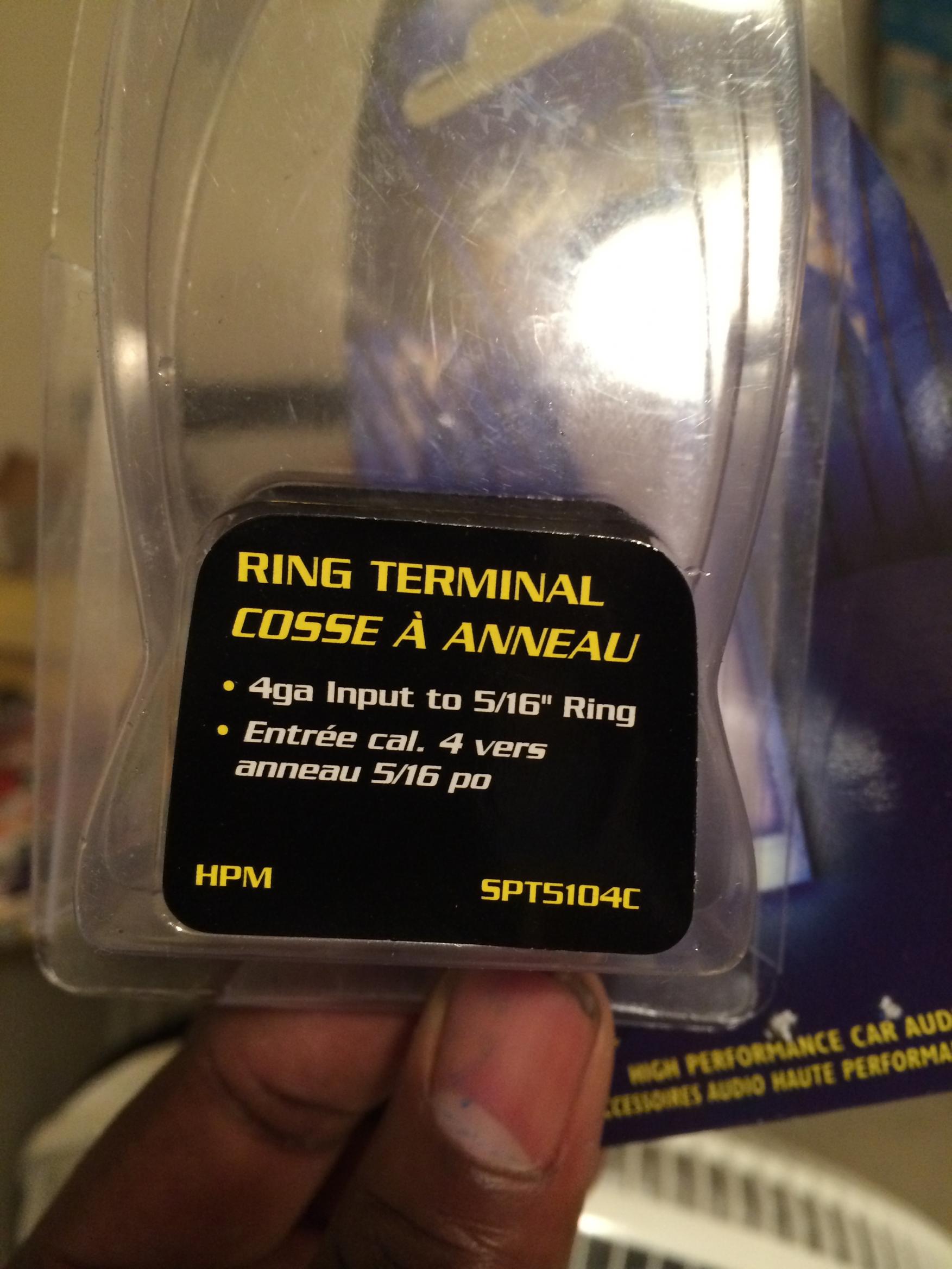

any idea what the size of the terminals actually are, just don't want one with too small of a hole. don't wanna have to drill everyone out further,nor do i want it too big where i'd need to add a washer or re-crimp with a smaller one...
mcmaster sells 4 & 8 gauge ranging from 1/4" to 3/4" screws diameters

I got those at future shop and best buy in the car audio department and they work like a charm.

ah canada, where everything also has french (lived in mississauga for 3 months)...thanks for the pics...5/16" it is
