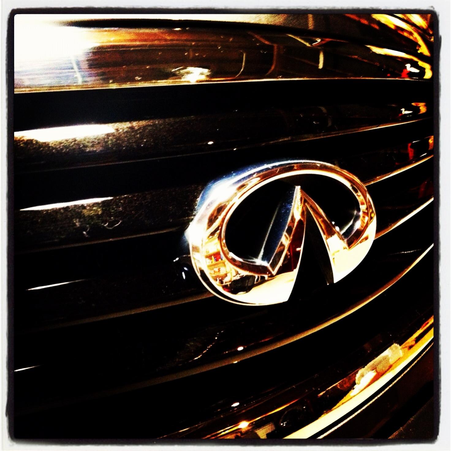

I shall be attempting this tomorrow. Thanks for the write-up, and the photos.
/edit a very simple install. unbolting the radiator overflow reservoir made it a LOT simpler.
