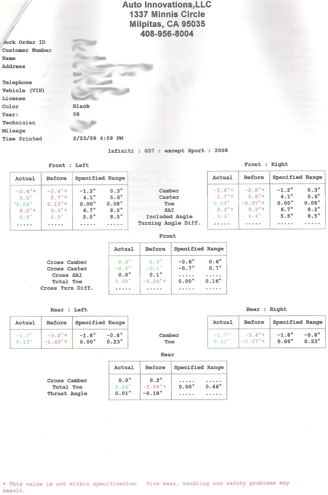

remember to get an alignment as soon as possible after a rear camber kit install...
i waited for 1 day and in between those times.. my car was pulling from side to side.. totally unpredictable driving.. and when i change lanes the car gets sucked into the other lane.. and when u start driving fast (55mph) u will start to "lose control" of the car. also, every bump and potholes u meet will make u swerve abruptly.
not a good experience at all.. i did the alignment and everything is good. Here's my alignment specs.. looks like i should consider front camber kit as well, front is off by about 2 degrees
edit: i'm dropped on KW.. a little bit slammed.
