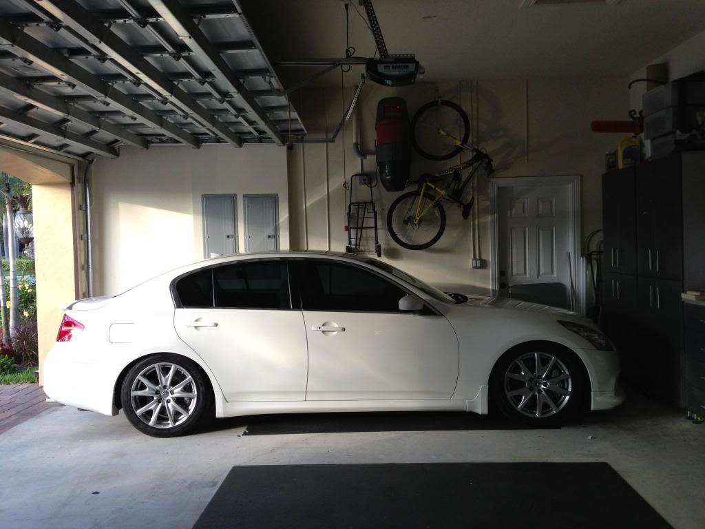

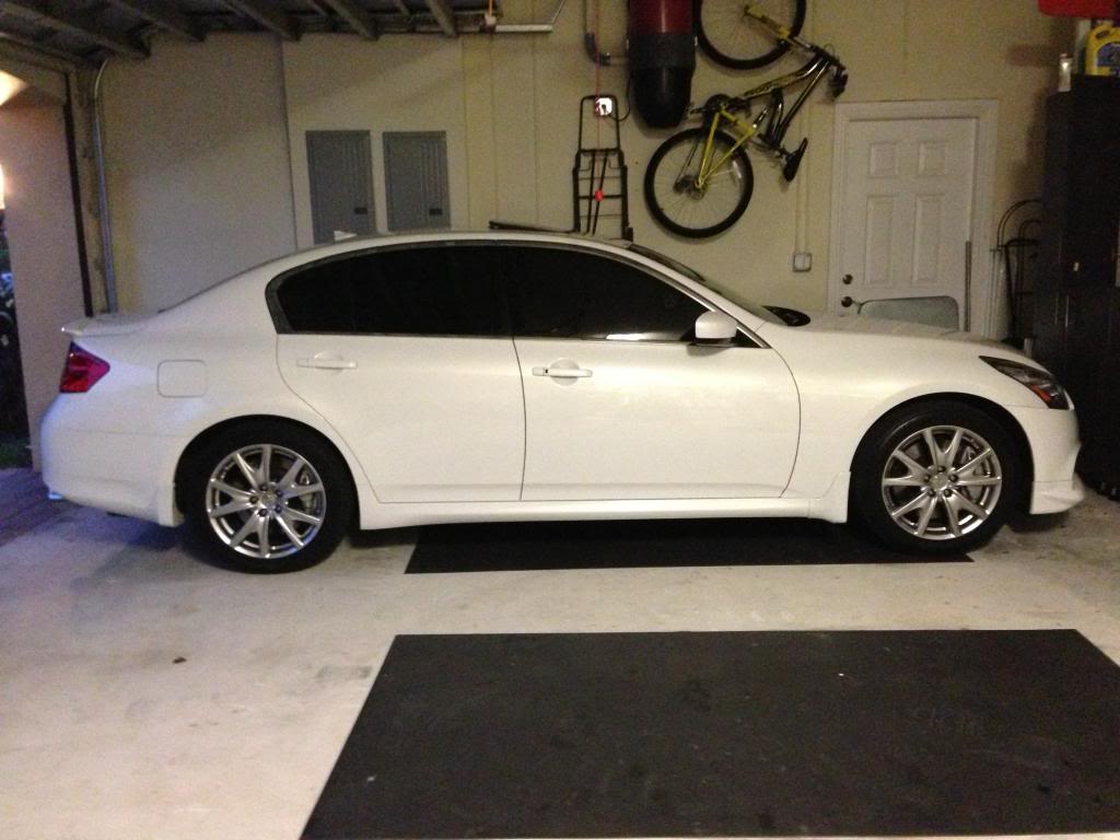

just accomplished this last night...for a 11g37x Sedan on Eibach springs
Backs were cake only took about 10 mins with air tools...
Fronts were a PITA...With the X models you have to remove your cv joints an remove the top control arm...
On one side though we removed the Strut Arm (towards the bottom of the strut, one bolt) and it came out much easier...
But heres some pics...I f*ck'd up my cv boot
Before
After
I'll post more later...
