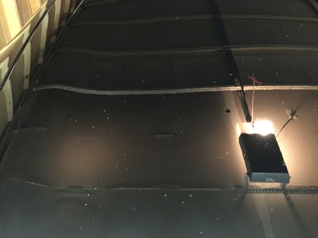

I washed the whole car, of course I dropped the clay... i tossed that piece... anyways, I did the IPA and I had a LOT of clay residue, dried the car again and started polishing
This is where it went wrong

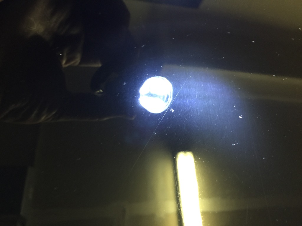

I started with the front fender passenger side
I started with compound / orange pads and I saw the swirl marks go but the scratches were still there, so I switched to the yellow pad
It wasn't really better so I said to myself "maybe this scratch is too deep? I don't feel it with my finger, but the rest looks ok... well, i should continue and then i come back for the scratch"
Ok, I continued and started with the hood. OMG, I'm trying to get some pictures, it's really hard because it's night time and the cameras don't pick it up. With the naked eye you can see a lot of "spots" in the paint. They look like rust or something weird but even if I had a couple of these "spots", now there are a LOT more and the scratches are STILL there.
I really need help, I don't know what to do and I don't want to keep applying these things!
What I did?
What I did?

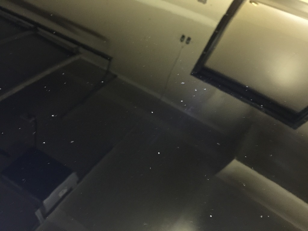

Thanks man, but let's see:
I could see the roof in the reflection even before beginning. I did this to get rid of the swirl mark and scratches. I got rid of the swirl mark but didn't get rid of any of the scratches and got these spots that you can see everywhere. Now I have to basically wetsand the whole car to get rid of those??? and I'm not sure I had these many imperfections before I started --> scratch that. I went down, looked at my car and definitely, the area where I worked looks worse than the rest of the car. It didn't have those dots!!!!
My wife took a look at it and said "WHAT IS THIS???"
I'm freaking out :S
I'm freaking out :S

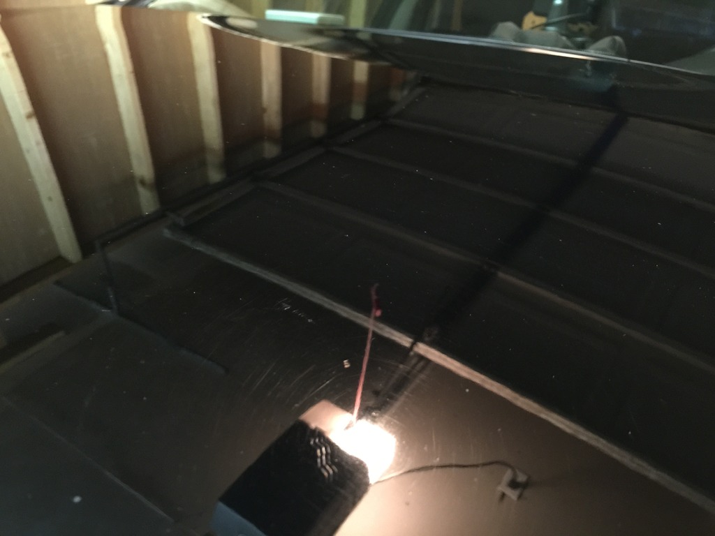

Ok, another update:
I went crazy and I tried everything.
First I thought that maybe it was compounding residue stuck to the hood (???) so I tried IPA with MF towel. Nothing.
Then I tried clay + QD. Nothing.
Then I tried orange pad + M105. Nothing.
I think that I ruined my paint :S
I'm not sure what that is. They almost look like pits but I can't figure out how you would get them from paint correction. I could see burning the paint (VERY difficult with and RO), and if they are pits, how you would not have seen them prior to the correction. I am baffled and, to be honest, it's difficult to fully diagnose without being able to touch and mess with the paint in person. Hopefully DI can have some solutions for you.
Thanks man
I have a couple of those scattered through the car, but nothing like what I have here. I don't know what to do anymore. I don't want to continue out of fear of creating more of these things.
I literally feel like sh*t right now
Edit: you know what? after further inspection in the sun, they ARE on the other side as well, but they don't look as white. Compounding really makes them pop.
This is not good news as now it looks worse than before :S

Diego - the chances of you ruining your paint are very slim, so take a breath and let's work through this. Paint correction is an art that requires practice and patience, so take a step back and consider your entire process and how your actions may have led to the results you've achieved and you can start to develop ideas on how to tweak your process, technique, etc for next time.
First - the scratch you show in your last picture is likely too deep to remove with traditional detailing/paint correction and would likely require either heavy cutting via rotary polisher and wool pads, or spot wetsanding to remove. I can see a large amount of micromarring in the paint in this photo that needs to be removed with polishing.
Second - Regarding the spots on the paint... let's first start from the beginning. Were these appearing after your very first section, or did they start appearing later as you continued working? Were you cleaning your pad frequently? (after every section) You mentioned M105 being difficult to wipe away... this is a common complaint and the usual root cause is either using too much product, not cleaning your pad, or overworking the product.

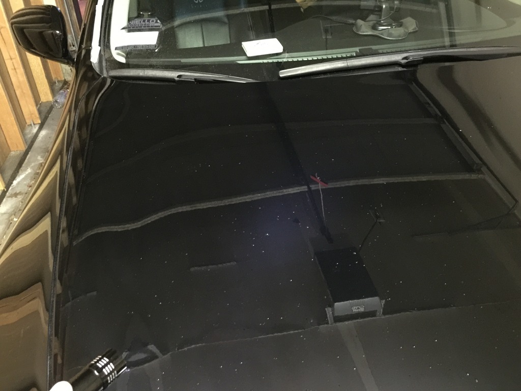

Hey guys, i'm sorry i didn't reply before. I wanted to work on my car this past weekend because I knew these next weeks are going to be hell for me. I have to work a lot more for the next 3 weeks, that's why i didn't reply. Yesterday I was working until 9pm (from 8am) so don't hate me for that
Now, about the car, first talk about those freaking spots:
I don't know what they are, most of them you can't feel them, some you can and are all around the car. Most of them are on the hood, some are on the trunk, less than that on the rear fenders. I'm going to take a couple of hi-res pictures to show you because clearly my cell phone doesn't do a good enough job to show you what they are!
Those spots are dull, so they are not very noticeable UNTIL you compound :P
When I did compound, now they show up very clearly as you saw in the picture I sent.
That's why I thought they were not there at the beginning, but they were, just they didn't show as white

I provided some ideas in my previous post... when you get a chance, you should thoroughly wash the car and agitate those specific areas with a small brush. Let us know what that does.
Additional pictures won't help... unfortunately the issue with trying to diagnose things over the internet is that sometimes you just have to be able to see them in person to fully understand.
I am still almost certain that it has to be product that is simply filling a small void in the paint. If it is indeed an issue with the paint, that would lead me to believe your vehicle has been repaired poorly or something to that effect. I've worked on many, many vehicles and have never seen what you're describing... but I'll try to work through it with you.

One thing about Infiniti paint, it is some of the most chip-prone paint I've ever seen. Before I had my hood repainted (from an accident a couple years ago) I had over 60 chips in my hood alone. Like Zach mentioned, get some light brushing into those spots (just a very small area just to see) and notice if it is indeed a chip. I'm thinking it is.
