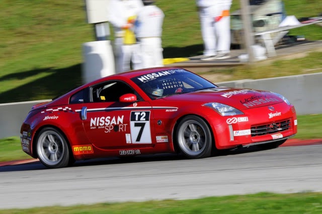

Hi George- I've got an unusual question for you: I've got a lot of work to do on the Nissan Sport T2 SCCA racecar, and thought I'd also use the time to wash, clay, polish and seal the exterior. Now that the detailing is finished, I left the Blackfire sealant on the redline Z without buffing it out. Since the Z will be on jack stands in my garage for the next four days, is there any problem with just leaving it on until I get everything done? Will there be any better bonding to the paint leaving it on like that?
Sure, it's a racecar, but I like to keep it looking good!
