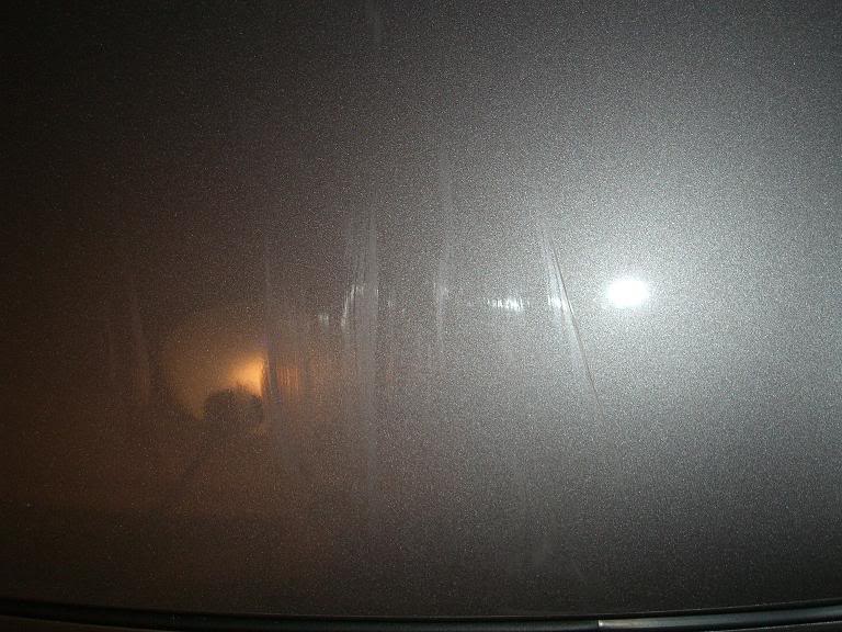

Any ideas on how to work the clear bra.
(This is on Clearbra not the car) Was able to get some of the scuffs off the hood with some wax but a lot of it is still there. I'm not sure if the clear coat on my venture shield was taken off or whats still on the hood is rubber. Can't get it off. This is what it looks like now

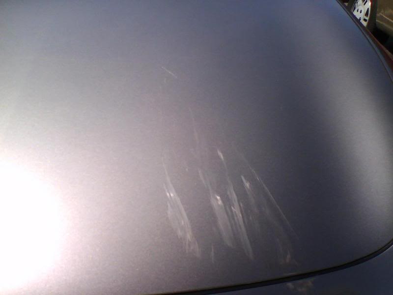

Any help would be great...is there something i can do to try to get rid of the scuffs on the clear bra where the marks are. Recommendation on what to use?? Should i just replace it or just live with it for a while then replace it.
Thanks!!!

PG35 - You could try out an abrasive polish as bigbadbooda mentioned in your thread on how it happened. Other than that, there's not much you can do, either live with it and be happy it was there to protect your paint or get that clear bra replaced.
Let us know how things turn out.
