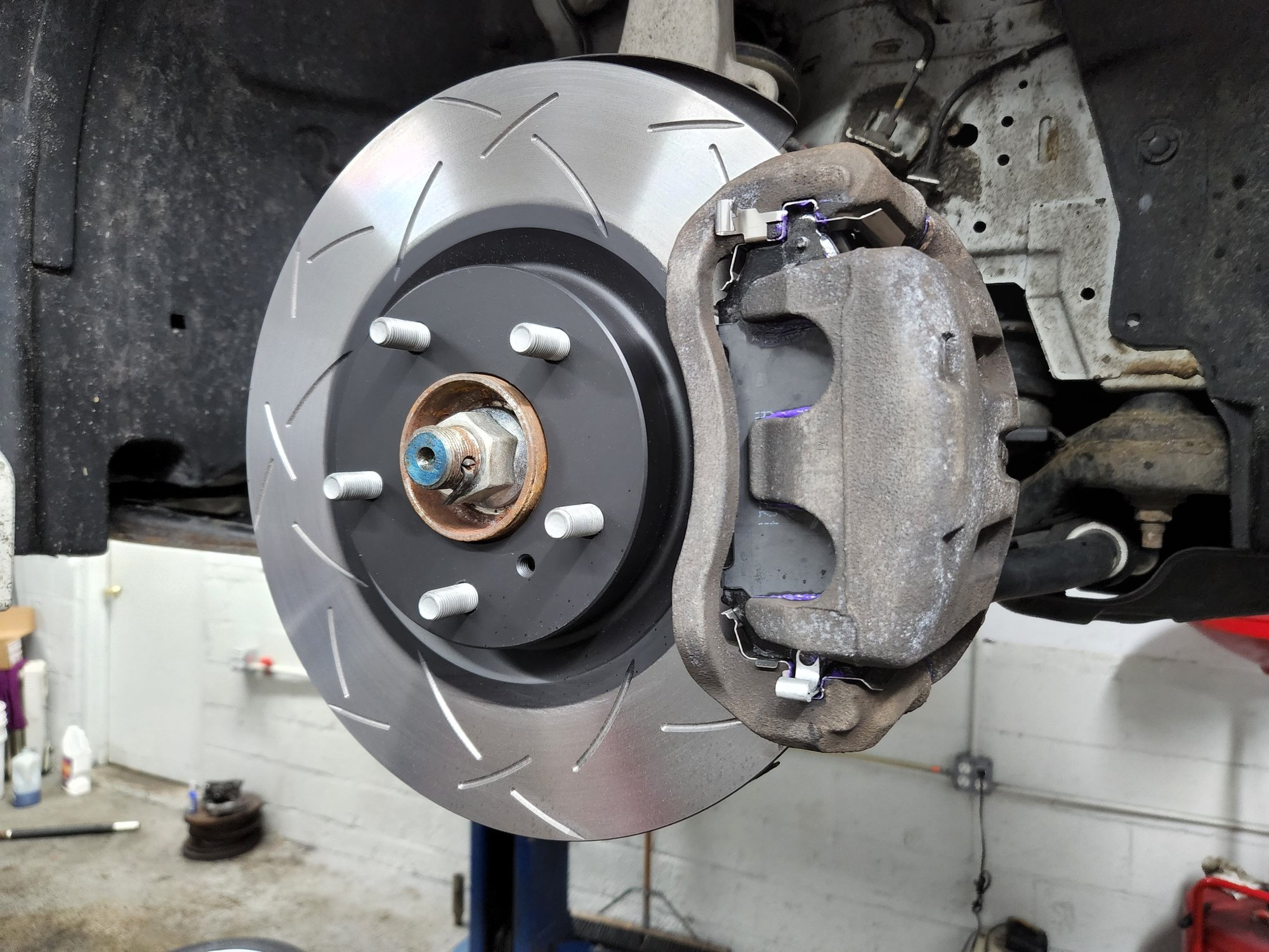

It's brake day! This is my first time doing my own brakes. I can't believe I payed shops to do this kind of work after realizing how easy it was. Mind you I had a little trial and error throughout but still an easy job. Very happy with myself.
I've been anxious to see how bad my rear right caliper was ever since I found out that it was seized and causing massive amounts of rust on my wheels and other components in the rear. Got the car on the lift, removed the wheel and saw the horror. Rust city!!
Took a look at the caliper and found what went wrong with it. The boot that goes over the guide pins was m.i.a. Thus causing it to be exposed to the elements. Seized right up. I had to use some serious leverage in order to break the bolt loose.
Replaced the old with the new, lubed up the guide pins like it's going out of style and reassembled. I had some issues here and there but it was mostly novice issues. Nothing major. Here's the after,
I noticed I put the inner pad on the outer side after I took these pics so don't worry, it's taken care of.
While working on the opposite side of the rear, I found out that that too had a bad caliper. I ended up snapping the guide pin because it too was rusted. The inner pad had horrible wear. Uneven, angled wear to be exact. Luckily a local parts store near me had a new caliper in stock so I ended up replacing both rear calipers. Go figure. I started to ponder if the shop that did my old brakes actually rushed it or were just careless. One caliper is bad enough, but two? Both rear and both with similar issues? I've never had this happen and it's very frustrating. Definitely not going to them again.
The fronts were a walk in the park by the way. Almost like wax on, wax off. Lol.
Here's what I installed:
Rotors: DBA 4000 Series T3 Rotors
Pads: Akebono Performance Ultra Ceramic Pads
No break in procedure required with Akebono's btw. They recommend you do 500miles of light to medium braking and refrain from any harding braking if possible. Once the miles are up, pads are "broken in" for all types of use.

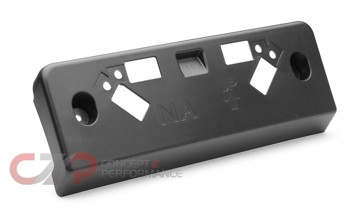

On today's episode of things I don't need. I made a custom Japan plate courtesy of customjapaneseplates.com. Figured it would be unique and add a little extra JDM flair to the car since this whole thread did start from wanting to do the JDM conversion. The plate was inspired by Han's Sylvia in Fast and Furious Tokyo Drift. This movie came out when I was in the 10th grade. I was a young little adolescent teen falling in love with the Honda car scene when I realized what a power house of an engine Nissan had with the RB26DETT. Been a Nissan fanboy ever since.
Plate netted me a total cost of $57.99. Not really cheap and I don't feel like it was worth it but whatever. Now it's made in true JDM spec so they offered me a JDM to USDM plate bracket. If you don't know, the difference is size and screw hole spacing. USDM is smaller in size and closer in spacing so the bracket helps with that. It's a clear hard plastic that attaches to the car and the front side is made for the JDM plate to screw into.
While getting it all together, I realized the OEM plate bracket can actually be used with JDM plates. You can take the clip that holds the nut and move it to the slanted hole. This lines up with the JDM spec plate perfectly. (See pic below) Guess it's a savings thing for Nissan so they won't have to spend manufacturing two different styles. Tested it and it works but the original screws I used for my plate were too big and scratched the new plate a bit. Oh well. Guess the bracket makes sense.
Was considering removing the whole front plate bracket and doing a tow hook setup but that requires to fix the drilled holes and paint. Don't really have time for that right now. Maybe in the future.
