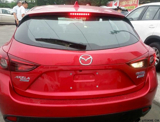

As for the legality issue, not really sure if NYS has any law, or US, that mention having two reverse lights as a requirement. Do correct if I'm wrong.
Originally Posted by 4DRZ
I'm aware of all that. Don't we normally have both sides as back up lights? So he is effectively eliminating the reverse light on the driver's side to turn it into a rear fog light?
Yes that's exactly what I plan to do. I even might cover the light with red vinyl tint. Not sure how that'll look on the G but here's an example on a Mazda

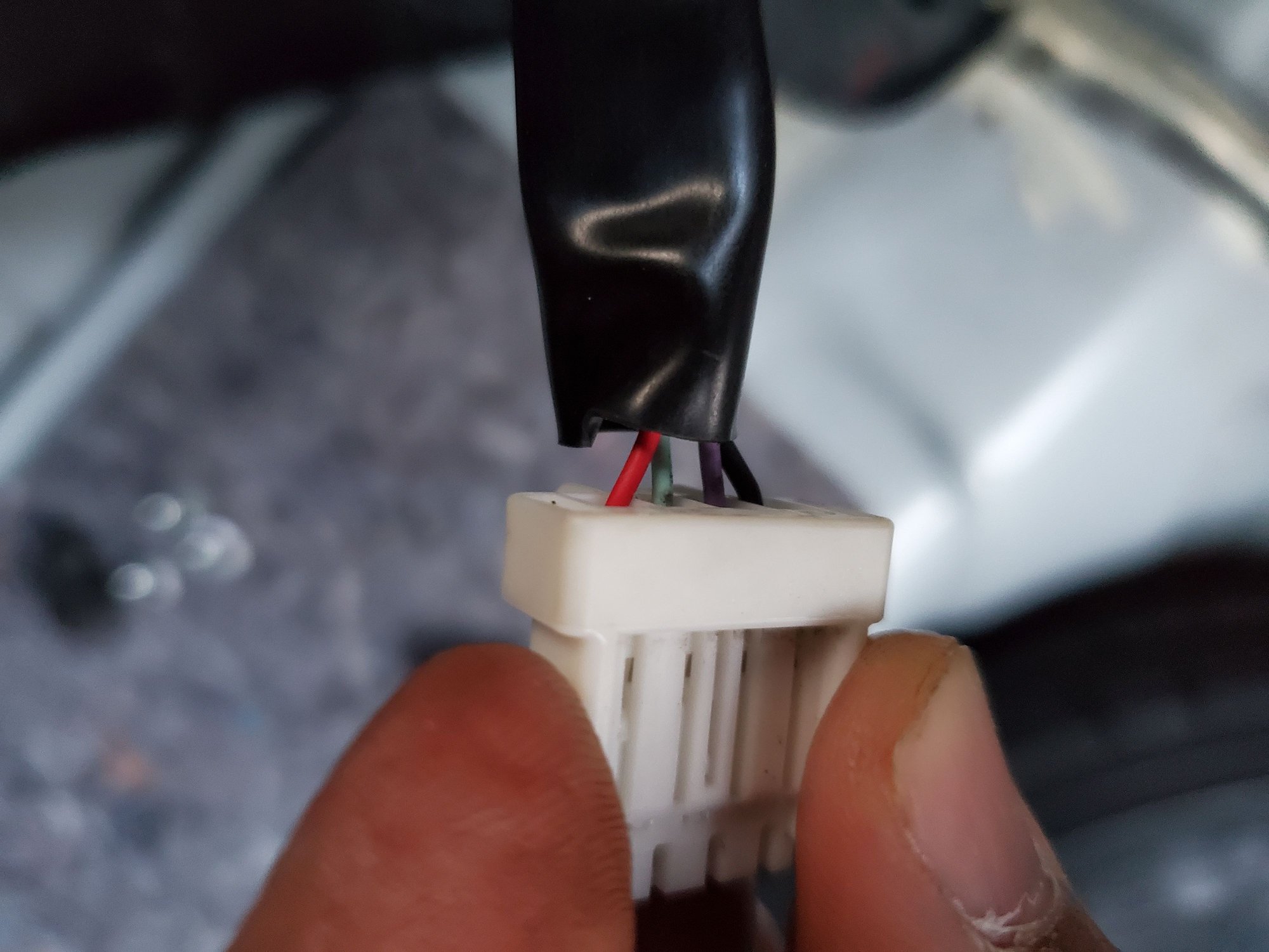

Had a bit of nice weather on my recent day off so I decided to take a look at my rear fog project. I'm not to sure when it comes to wiring so I'm still looking at the wires like a 1,000 peice puzzle. The reverse lights have black and red wires. I think black is ground and red is power. The tail lights have 4 wires. I need to know which one is power for the taillights? I know I can PM a few people but I'd like to post the info here in the thread incase anyone else might need it.
This is the right tail light plug. Red. Mint green. Purple. Black.
This the left tail light plug. Purple. Teal. Mint green. Black.
I think a voltage tester should be in my Amazon cart.

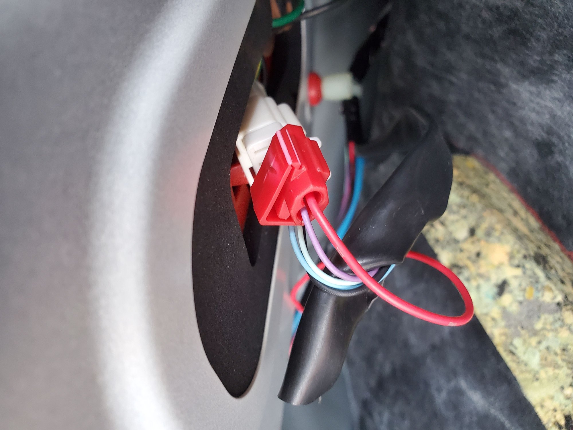

For the LEFT side: B60 connector, pin 1 (PURPLE) is (+), and pin 4 (BLACK) is ground (-).
For the RIGHT side: B67 connector, pin 1 (RED) is (+), and pin 4 (BLACK) is ground (-).
For reference:
Pin 2 (LIGHT GREEN (both sides) are (+) for your STOP/BRAKE lights, and
Pin 3 (SKY BLUE/PURPLE) are (+) for the TURN SIGNAL LAMPS.
Pins 1, 2, and 3 are (+) when energized;
Pin 4 is a common/shared ground.

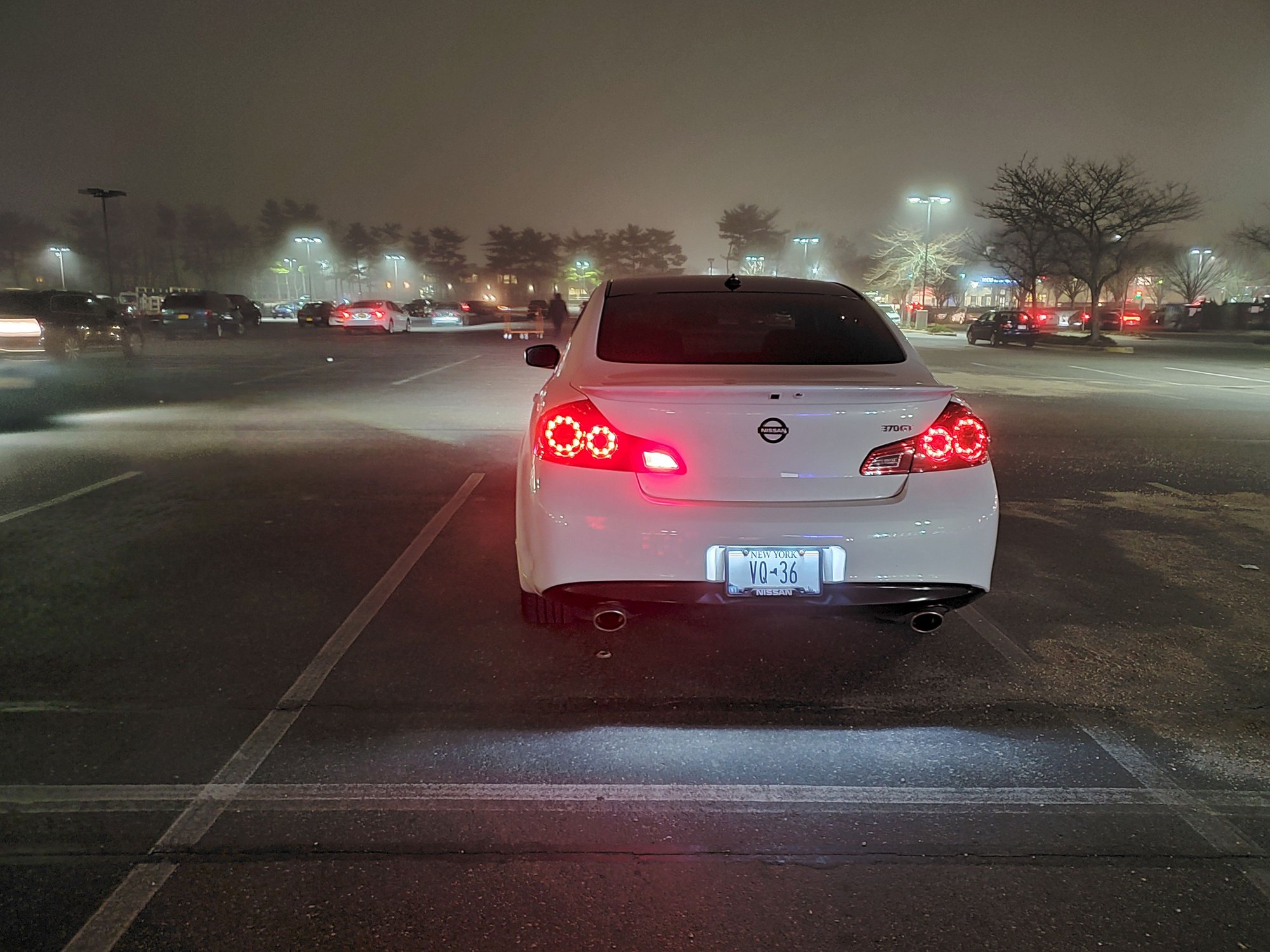

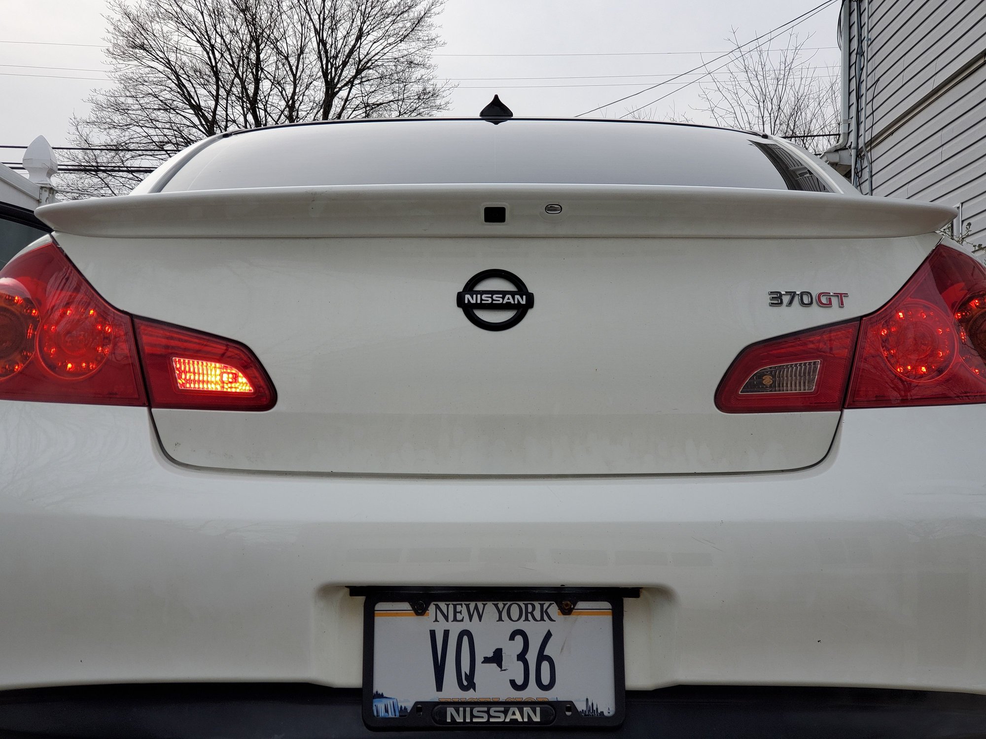

Rear fog update: I think I finally got it!
A quick background for anyone who is interested in doing this mod. I'm not great when it comes to wiring. If my confused self did it, I'm sure you can as well. The diagram posted by ILM-NC G37S helped a lot and makes me wish more technical manuals were this easy to read. "G37 for Dummies" should be a book.
My goal was to have an always on rear fog light utilizing the rear left reverse light. I've considered doing the EU fog in the lower bumper and the infamous red LED strip that everyone puts behind the Autokits X rear diffuser. EU fog wasn't easy to find and expensive at the same time. Cheapest I found was $550 shipped from a UK website. The autokits idea was a good idea too but I didn't like what was available in regards to the red LED strip.

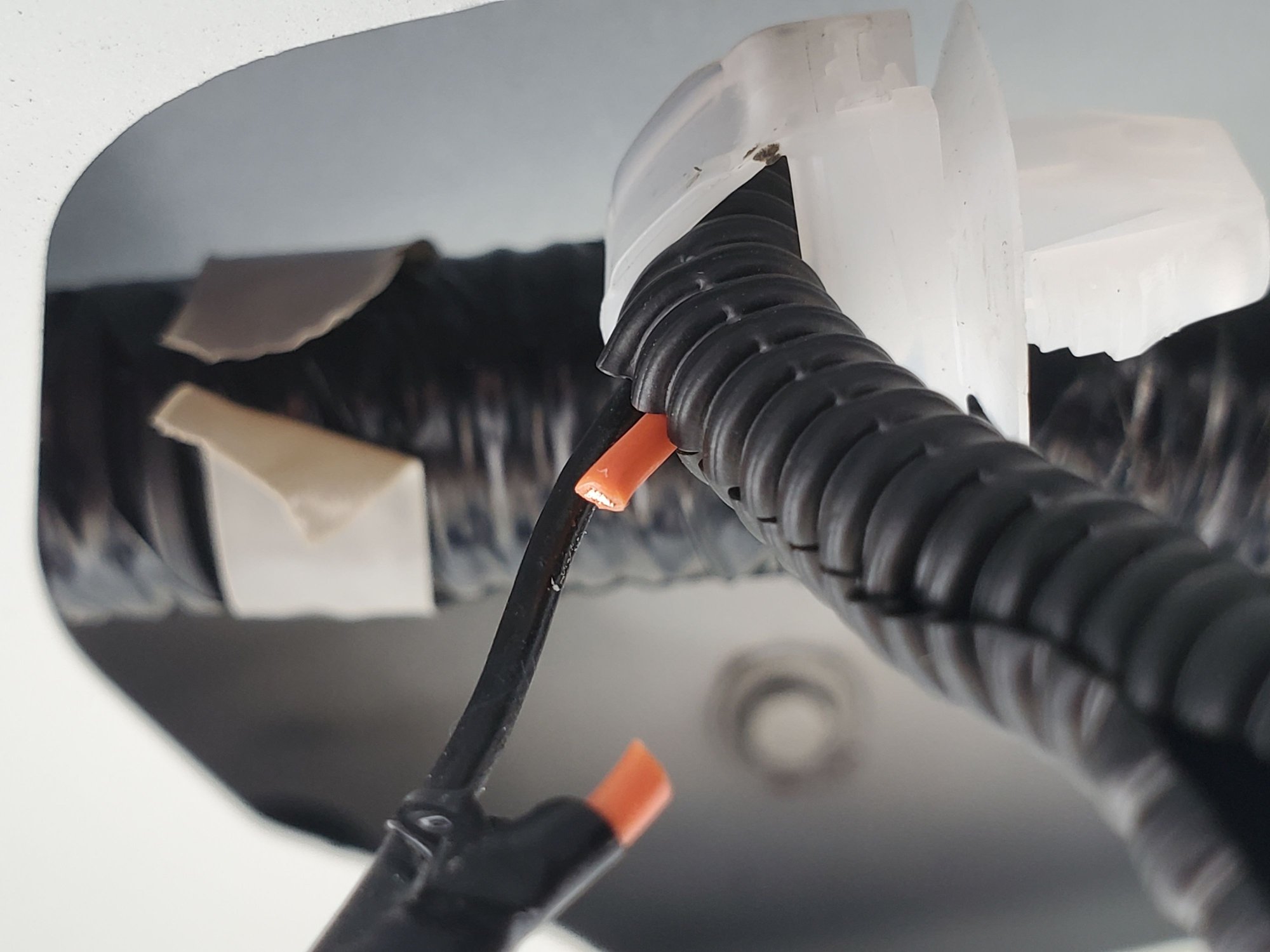

I settled on the reverse light option. The idea was simple. Run a steady power wire to power the reverse light and replace the bulb with a red LED bulb. I had extra wire laying around from my illuminated kick plates. I cut the red wire from the black wire and used it as a power source.
I started first at the reverse light. The orange light is the power. Black is ground. My method of connection was via red wire taps. The wire taps came from a resistor pack. Fairly easy to use and can be removed easily by prying the taps open with a flathead.
This is the left rear back up plug. I tapped into the orange wire which provides power to the bulb.
Next was to run the wire to the rear left taillight. Tucked the red wire from the left rear reverse light through the trunk lid, down the left through the rubber tube, which was a pain in the a**, and through the trunk towards the tailight. Once at the tailight, I again used a red wire tap and tapped into the purple wire. Purple supply's power to the rear tailight.
On the other end, used the same tap and tapped into the the purple wire. This is on the left rear tail light
With both ends connected I installed the red LED bulb. Its a 921 LED to be exact, purchased from superbrightleds.com. Lumen rating was 170. Once installed, I turned on my lights and was satisfied with my wiring until I realized the right reverse light was also illuminated. Great.
Tested my wiring job and found out both reverse lights were illuminated.
I was stuck and a little disappointed. I didn't let it defeat me and started to think of how else I can make this work. I stared at the wiring for a good 45 minutes and figured it out. That orange wire powers both right and left reverse lights. The good thing about the left reverse light is that the orange wire branched off from the main orange wire which ran to the right. I decided to cut that orange wire a bit past the where I tapped into it originally and hoped for the best. I was timid at first. I marked my cut point about 5-7 times and hesitated multiple times but I finally gave in. It worked!!
Here it is with the lights on and rear left illuminated.
Lights off and car in reverse.
Felt satisfied with my work and cleaned my trunk back up. Reinstalled all the carpeted panels and clips and waited for night to fall. Wifey wanted Applebee's that night. Perfect!! Let's go so I can take pictures of how my new "fogs" look. So far I'm enjoying it. Also enjoying the fact that my car is becoming more unique in a city that every 1 in 5 cars on the road are a G35/7. Stay different my friends!
