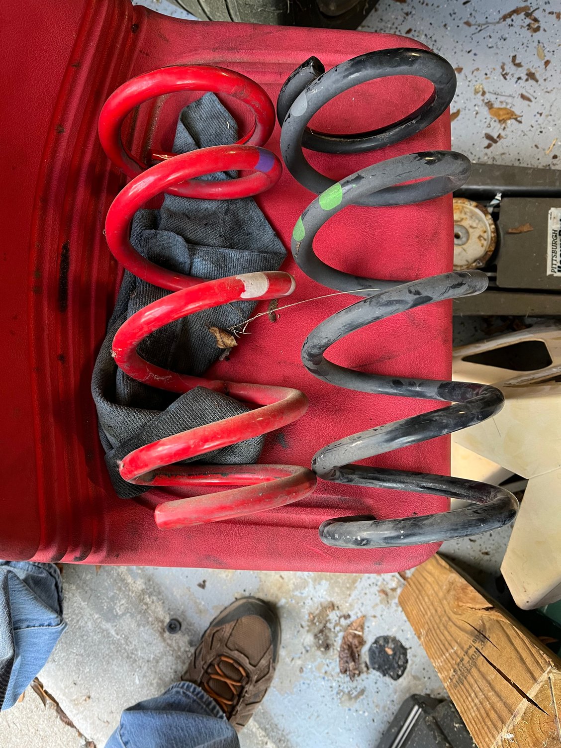

Put the oem sport sedan springs back on the rear of the car. The red Z springs were way too low and the ride was a little too harsh. Length comparison of nismo (red) and oem (black).
next, need to swap non- nismo front Z springs for the nismo ones. For now I’ve given up on fixing the under-quarter-tank no fill issue as that really needs a lift to figure out.

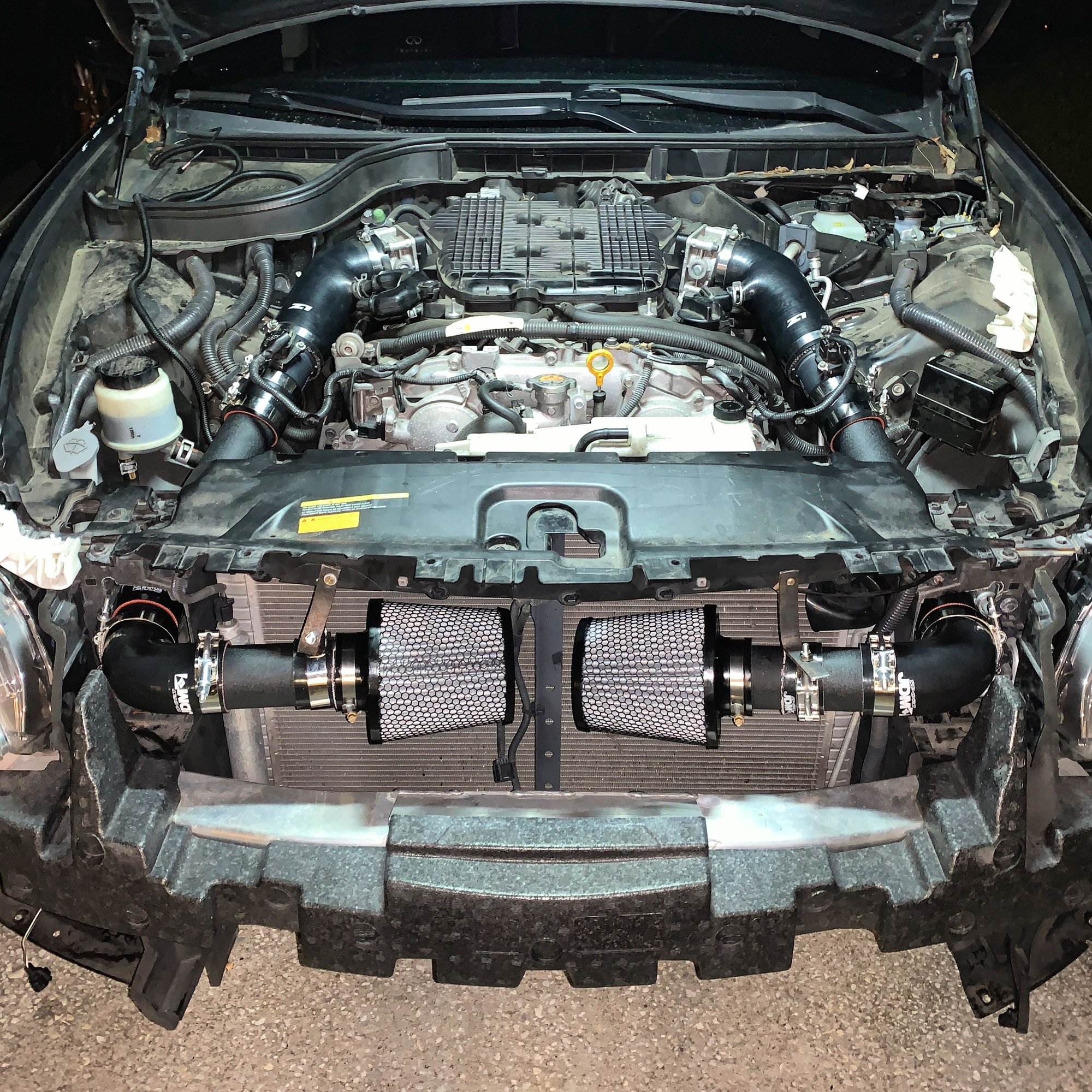

Back in (fillinyear) I built a custom CAI for the G. I used older Z1 throttle body silicone, air flow meter housings from an Altima or Sentra, and a cheap(ish) intercooler piping kit from ebay. I added R2C Black Hex filters as those seemed to be the most popular with the performance folks. The thing was all black, even the piping was crinkle-coated black powdercoat. All 2.5" outer diameter.

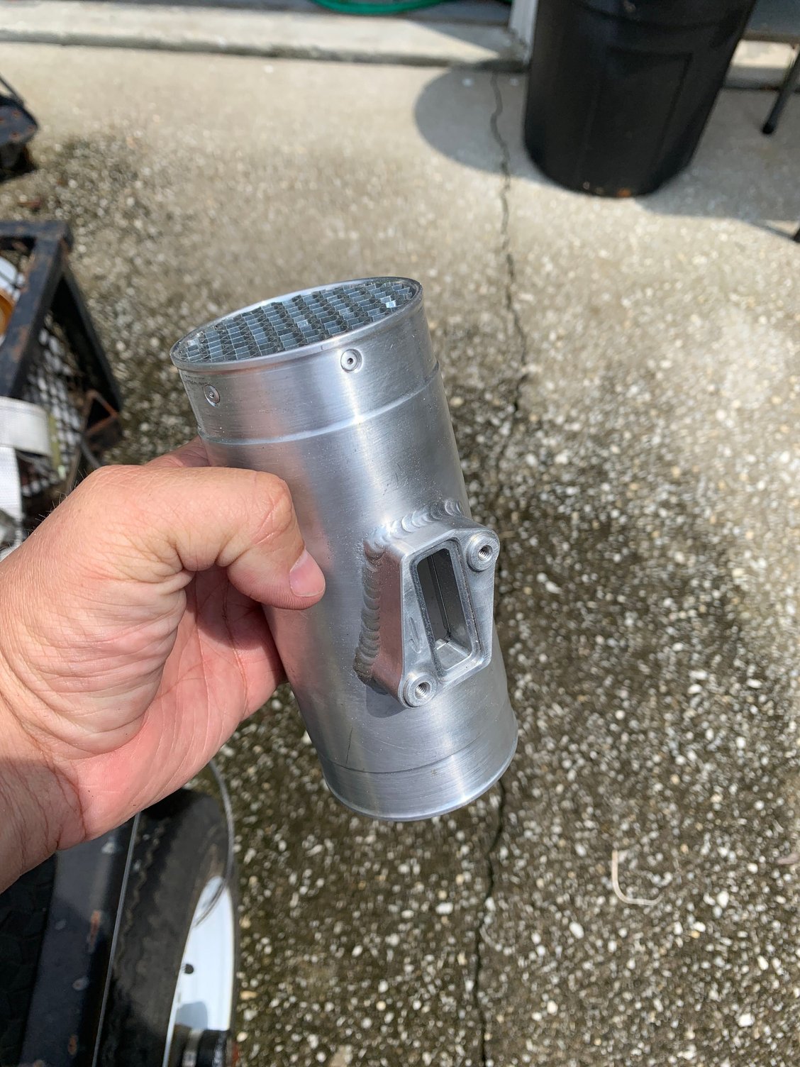

THEN, I scored a deal on some fancy air flow meter housings that were solid aluminum and had a honeycomb air straightener, but were big enough (2.75 OD) that I had to have the car dyno tuned to account for them. I patched them in the day before my tune at Z1 October 2021 - less pretty, but functional.

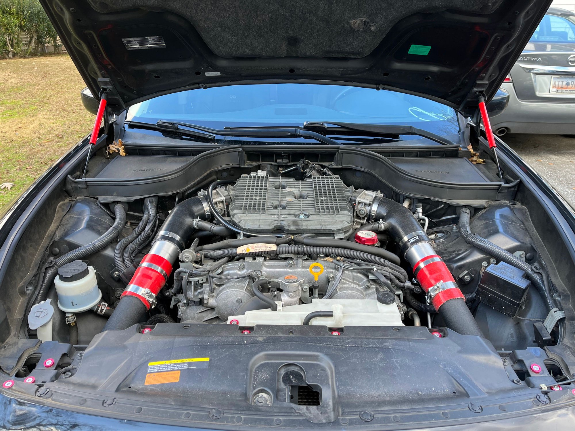

Since there was a clear air restriction, I decided to revamp the system to be 2.75 all the way. I couldn't find crinkle-coated black tubing in the right size, so I went polished. I'd already started doing some trim in red, so I went all red silicone too. New Z1 throttle body silicone, couplers and elbows from ebay and Amazon, pipe from a Summit Racing seller (only needed the 45* bends, much cheaper than a whole kit), and since R2C is gone I recently mathed my way into some AEM 21-2029 filters. As you'll see below... those filters may be a *wee bit* overkill.
While the car runs fine with the new setup, I haven't had a chance to see what it does (if anything) performance-wise, and likely won't notice - I haven't driven the car since June 2022 at this point, so the butt-dyno isn't really calibrated for the car any more. Also, I replaced the radiator hoses with Z1 silicone at the same time, so I have to burp the air out of the cooling system.

This is what I started with (piping setup shown off the car for clarity):
Here's the fancy AFM housing:
And here is CAI 1.5 with the less-graceful transition from 2.5 to 2.75:

On to new stuff. Had to open up the radiator support substantially more; issue there is that on the driver side there's these delicate HVAC pipes running through there too.
OK, pics will take a while. They're all HEIC apparently and the forum doesn't work with that format. Off to find a converter...

I will note - not just responding to John - that the stance is Nismo red springs up front and OEM Sport Sedan springs in the rear. I've got non-Nismo 370Z for up front when I get a chance to install them - the Nismo rates are NUTS. I've ridden in children's wagons with more suspension play. OTOH - great for a track-only car. Not so great for real world road conditions.
I've seen a post somewhere that has the rates of the 370z base, Nismo red, and black springs and the Nismo black front rates are very similar to the G37S sedan.
I've had my stock G37S sedan springs in the back and 2015 Nismo black springs in the front paired with koni yellows and it rides similar to stock with a better looking rake.
