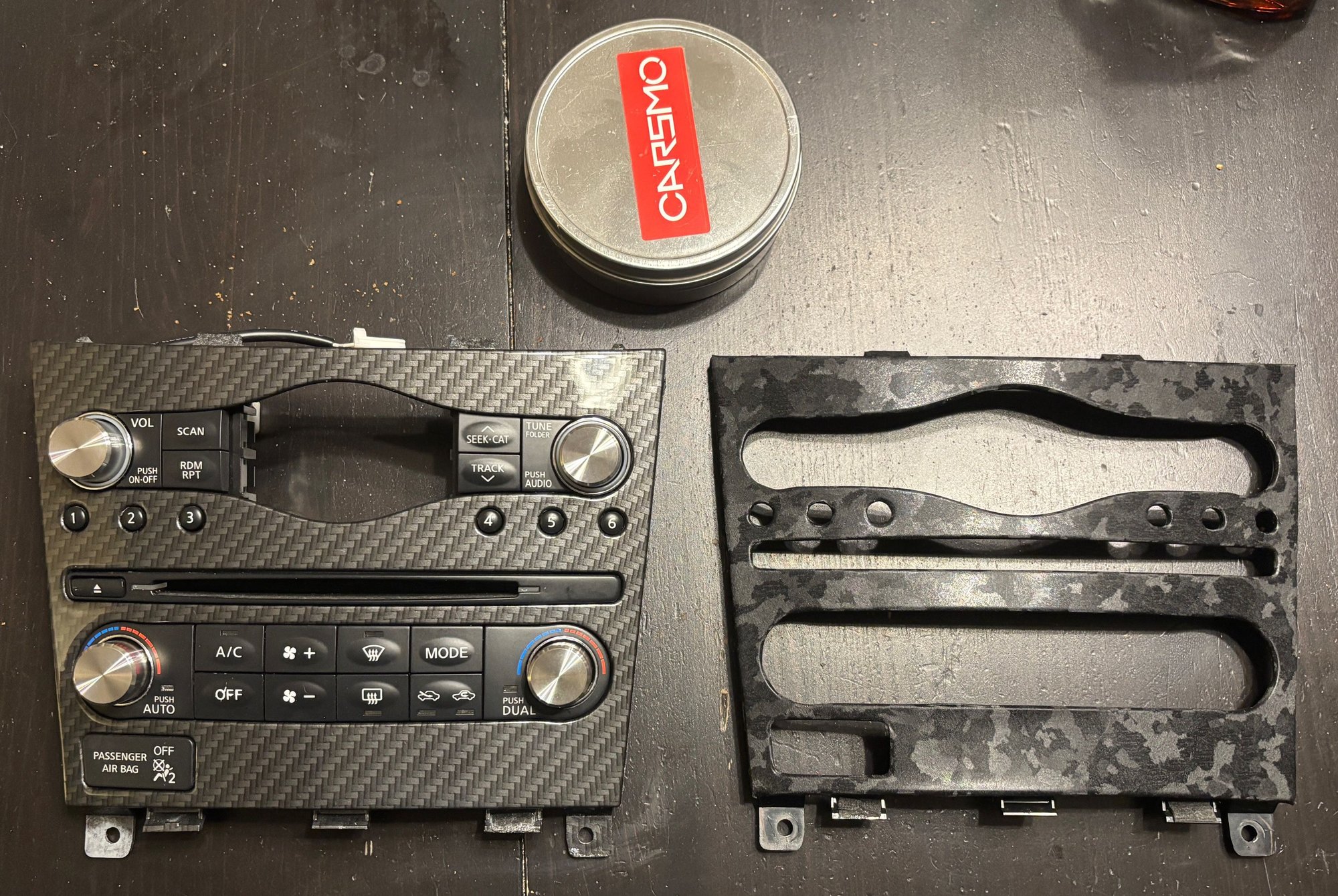

OOH boy it has been a WHILE since I updated this page. Not much happening until of late but I did some stuff other than just rinse off the pollen.
Around mid-January I swapped the carbon-flake-vinyl-wrapped stereo faceplate for a hydrodipped one. Apparently from a slightly different year so the CD slot is in the wrong place... I more or less deleted it internally. I don't think I've ever used a CD in this car in 8 years of ownership. I... uh... I remember *owning* CDs, at one point, but that was decades ago...
Added the CARSMO ***** I've had on the shelf forever (who knew the top and bottom ***** were different lengths? I did not). Then installed that along with the VLINE2 to get Carplay. Great success!
You'll note the clock is missing. That is, at least for now, on purpose.

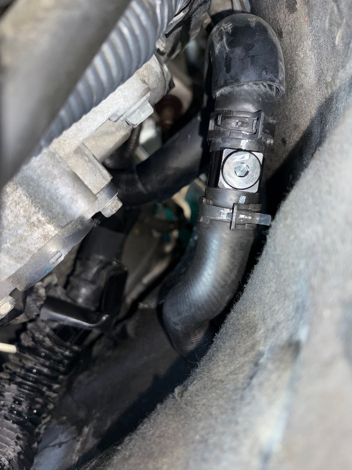

Completed the replacement of the heater hoses and connector. I decided to use the Z1 with bleeder port version.
What is required is:
92410-EY00A hose
92401-JK20A hose
92402-JK20A hose
(6) 01558-00521 clamp (these are the double-band constant pressure OEM clamps)
I only really have notes on the passenger side. The driver's side was relatively easy.

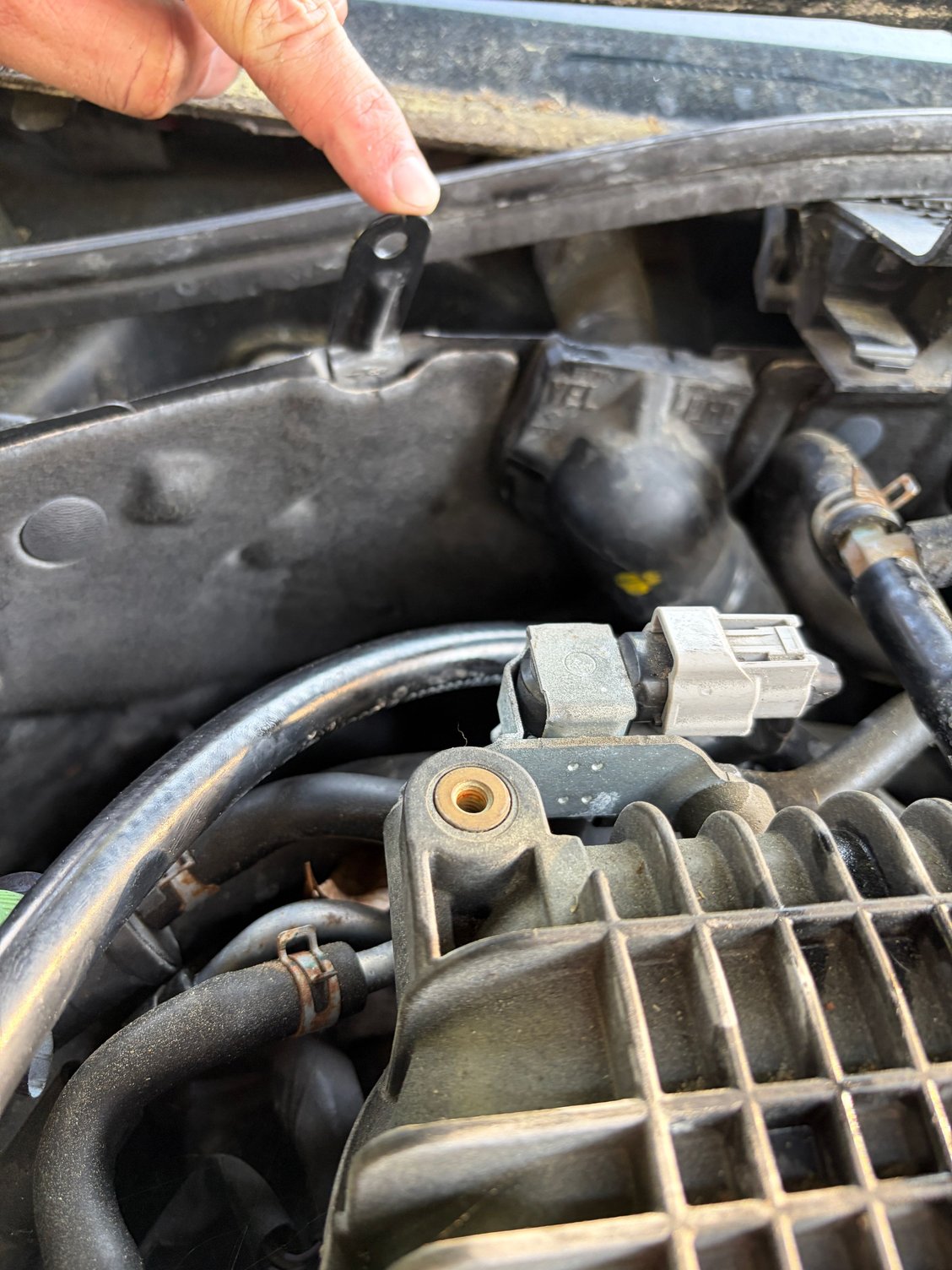

First - once you remove the battery trim and windshield trim, there is a standoff from the firewall that you will have to bend out of your way. Unless you have three elbows, a 4' long arm and hands the size of a child BUT with the grip strength of 10 men.

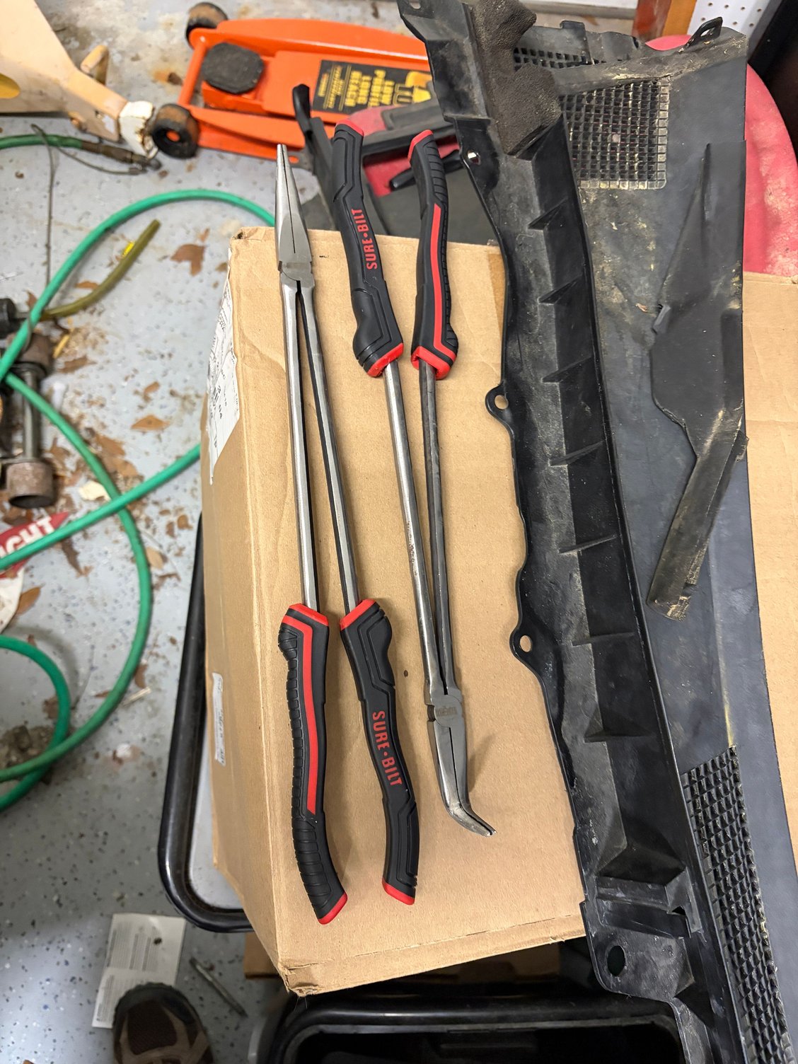

Then, you'll need an extra special tool to reach down to get the clamp on the back of the engine block...
Specifically, the one on the right. I think these are 20" or so. Walk right past the one with the 2nd joint in the middle, it can't build enough clamping force to move these stubborn clamps.
Assembly is the reverse of removal et al.
I would suggest building the hose-connector-hose assembly outside the car and putting the two clamps for the connector on that way - it just takes a (with pliers) squeeze or a tap from a screwdriver and they'll spring shut. WATCH YOUR FINGERS. I didn't get bit this time, but when doing the temp fix on the road I sure did. MAKE SURE you face the bleeder port UP lol.
Final product:
