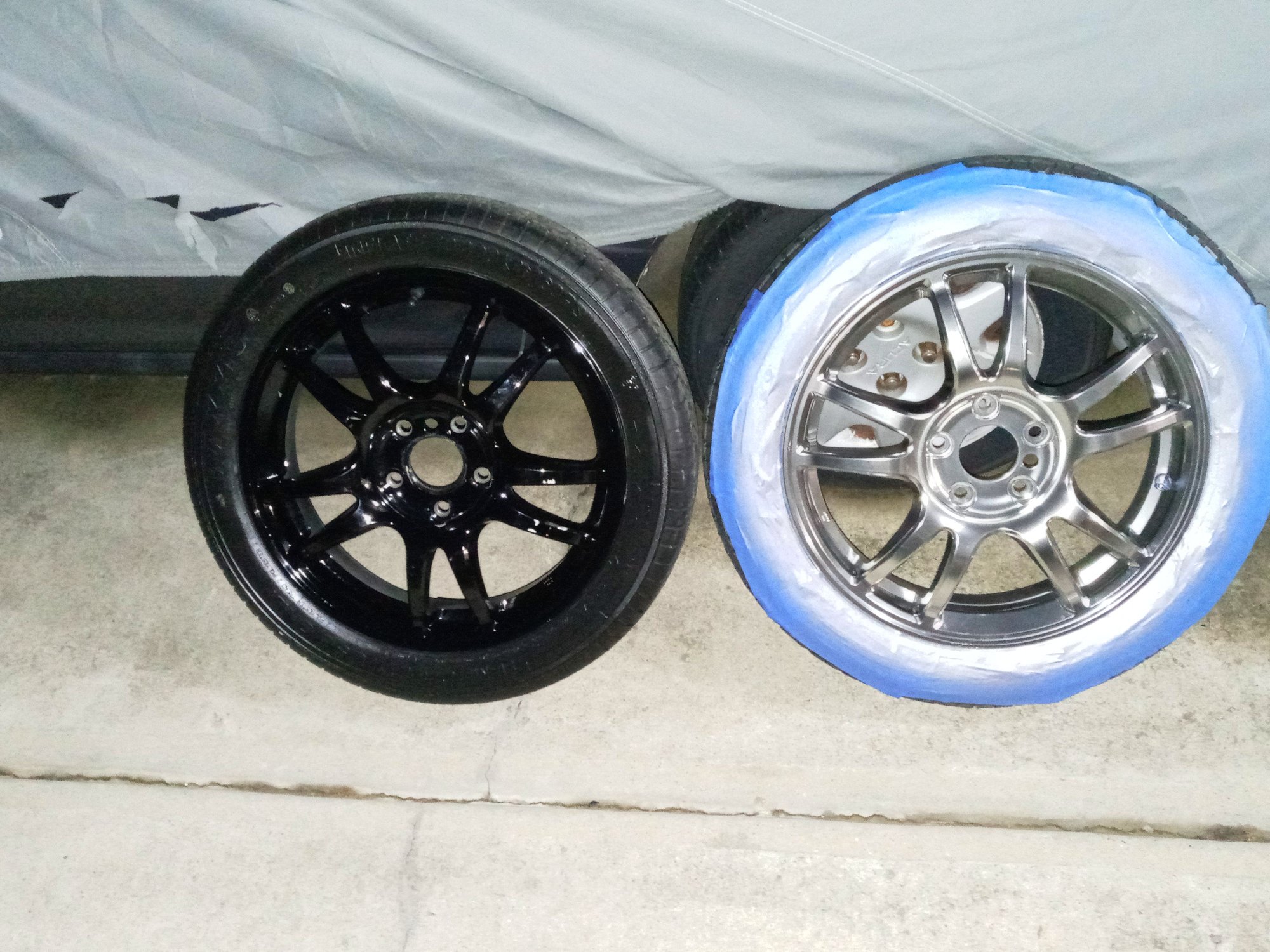

After discussions with the finance department (IE my wife) I think I'll try to swap the lens covers with the AliExpress ones and paint/mod the insides myself. Even if I got the new black-interior ones I've seen on Amazon (and talked about in the Sedan Chat thread) I'd still have to open them up for the STI lenses and demon eyes, so...

New Look!!

From: Charleston
Shiny!
What wheels are those? They look like my spare, but polished.

Looks like mismatched chrome wheels to me. Is somebody whoring your build thread, Mike?

Posts: 113
Shiny!
You are almost right. They are painted with a mirror finish that makes them look polished!! Came out real good. They make great skinnies for drag racing
