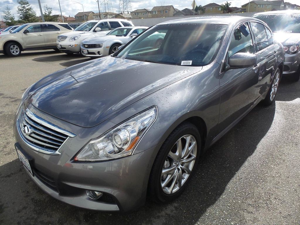

Starting late 2015 I started looking for a new car. I had a few things that were really important to me; 4 doors, RWD and a sunroof, which didn't really narrow it down. But then I added one other BIG criteria, a manual transmission. This quickly narrowed down the options once price was factored in.
I had always been a fan of the Nissan Z cars and when the V35 sedans were first released back in the early 2000s I liked the combination of sporty and reliable luxury at an affordable price. This led me to look into the G37 sedans. I wasn't in any hurry and so I spent time looking for a nice example available within California. I knew I wanted a low mileage, well maintained, and COMPLETELY original car so I reduced my search to just 2012 and 2013 examples.

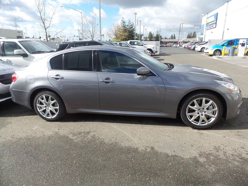

I found a few cars that were fairly local but they didn't seem to have been well cared for. Then just a few days before Christmas and a spontaneous search of CarMax.com led to a sedan with under 33,000 miles on the clock and located about 75 miles away in the Central Valley. The pictures showed a pristine car with lower than average mileage and a beautiful color which I hadn't originally considered. I placed a hold on the car and scheduled a visit and test drive (a great FREE feature of CarMax which prevents your dream car from being sold to someone else before you get to check it out).
I made the trip to see the car in person and after a test drive I knew it was the one. I went ahead with the purchase and after the easiest and fastest transaction ever, I was the proud new owner of a 2012 Infiniti G37S 6mt sedan in beautiful Graphite Shadow exterior with Graphite interior.

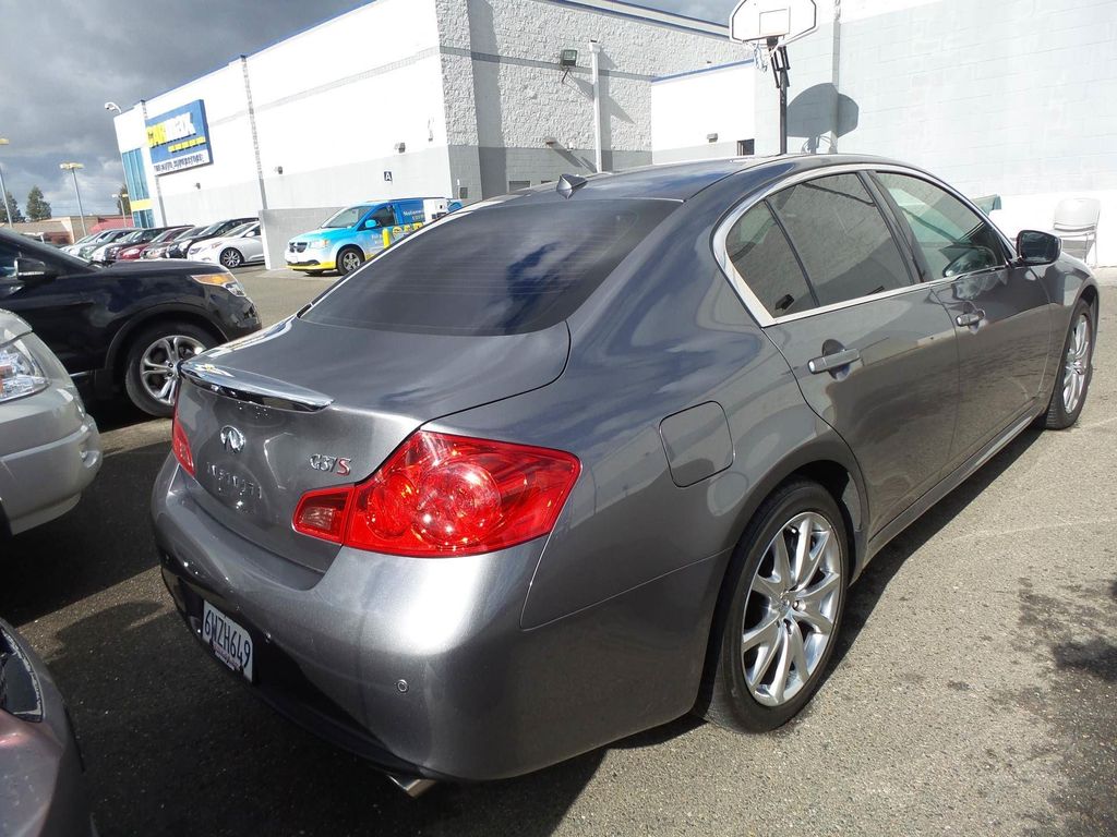

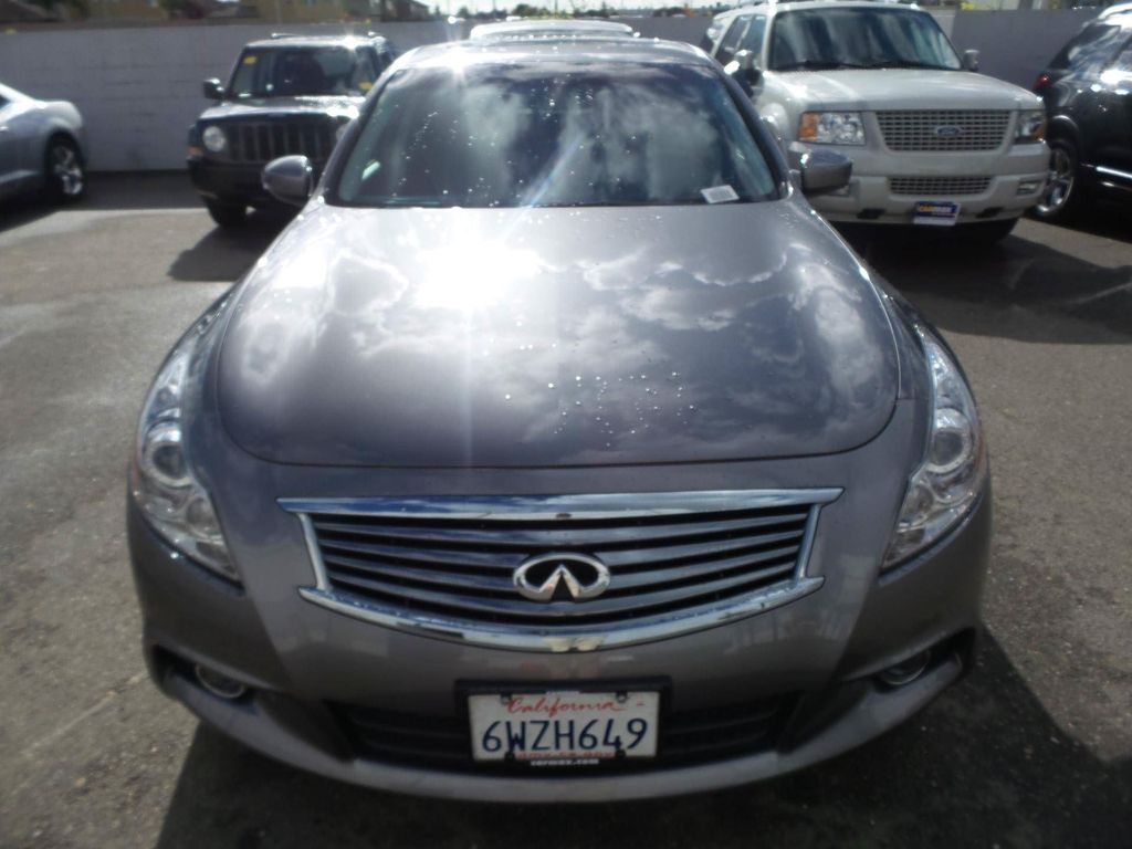

The following pictures are from CarMax so please excuse the quality as they're the ONLY stock pictures I have

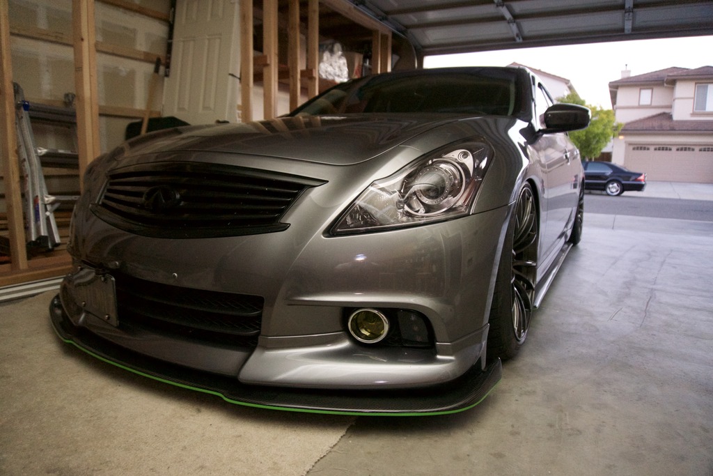

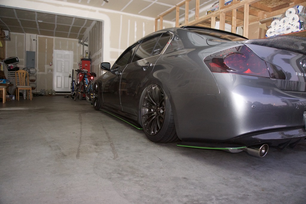

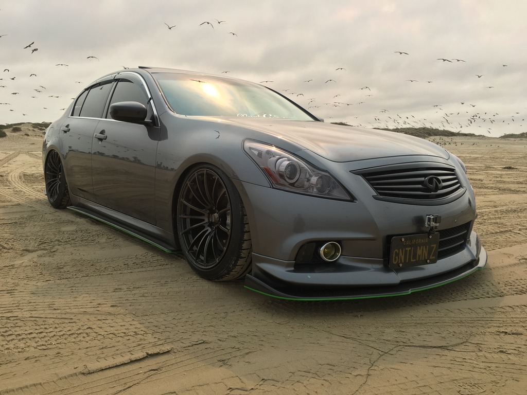

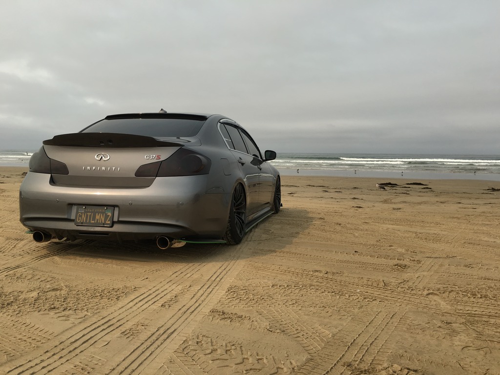

Below are a few pictures of the car as it currently sits (I'll continually add and remove pictures from here as things change):
Thanks for taking the time to view my thread!

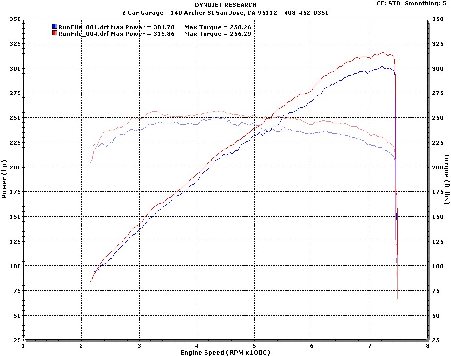

Thought I'd use this section for a little dyno action!
and here's the dyno sheet
Run 1 -
Mods - Stillen Gen3 intakes
Results - 301whp/250wtq
Run 2 -
Mods - Stillen Gen3 intakes, Motordyne ART pipes, Fast Intentions 2.5" cat back exhaust with 18" resonators
Results - 315whp/256wtq

Way to go Jimmy, now that's the way to put a build thread together!
G is a stunner all the way around, and what a list of things you've done in such short order. Big congrats on this one, take a bow sir!
Wow looks great! Not sure im feeling the neon green stripe...but would love to see some more profile shots of this. Also get some more pics of the rear spoiler? Hows the fitment? Ive been eyeing the same one for awhile now and just curious about fitment on the sides? Also hows the fitment on the side mirrors? I know with those overlays, there can be issues.
Any plans on blacking out the fog/window trim to tie the rest of the car together?
