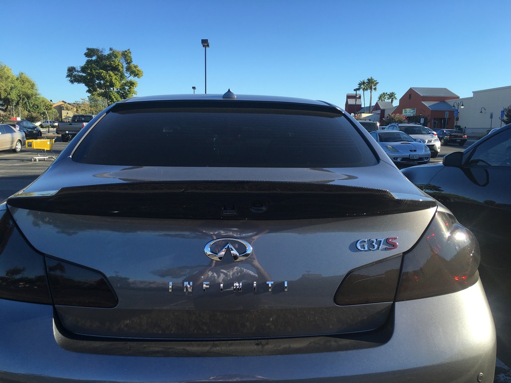

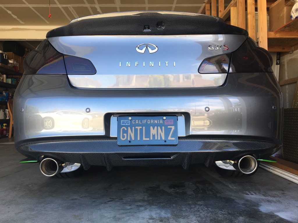

Here's a nice shot! I'll have those requested pics up in a few minutes. Sorry for the delay. Check out the awesome license plate!!

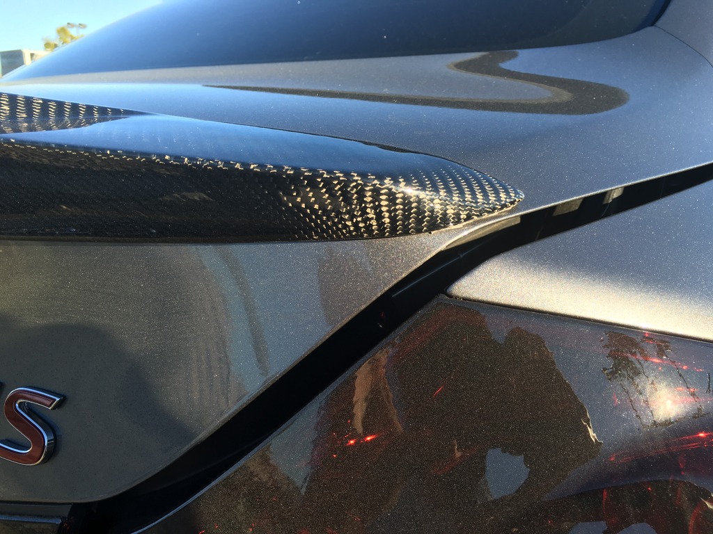

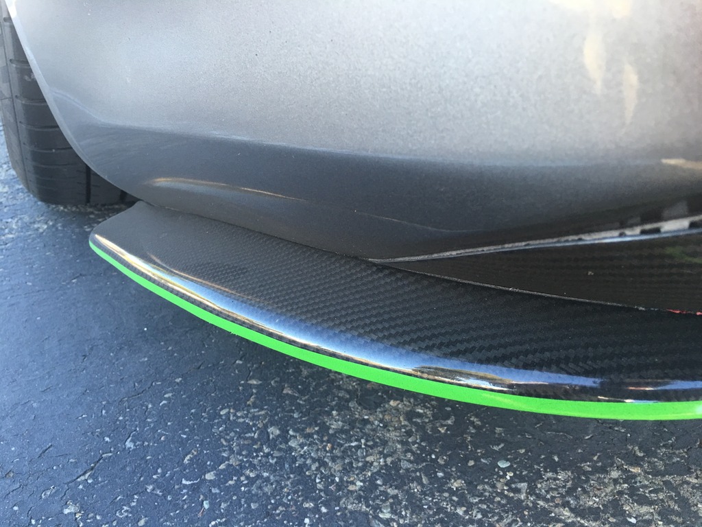

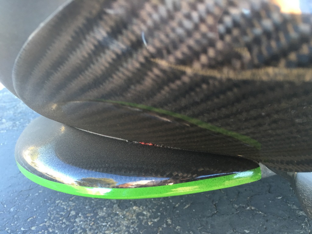

Here's the pics of the successful auto rear spats meeting with the autokits-x rear diffuser. Let me know if you need some more of different angles. Also, I haven't washed the car in two weeks so don't give me a hard time!

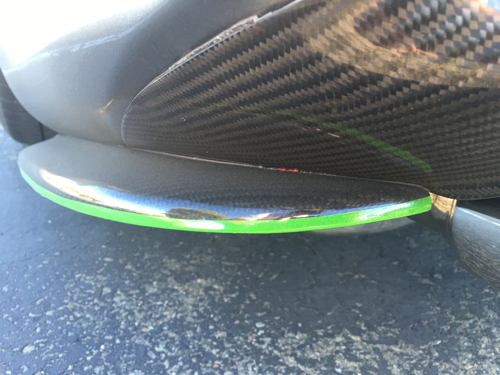

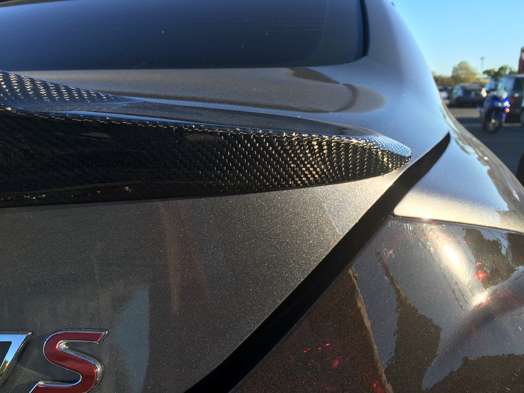

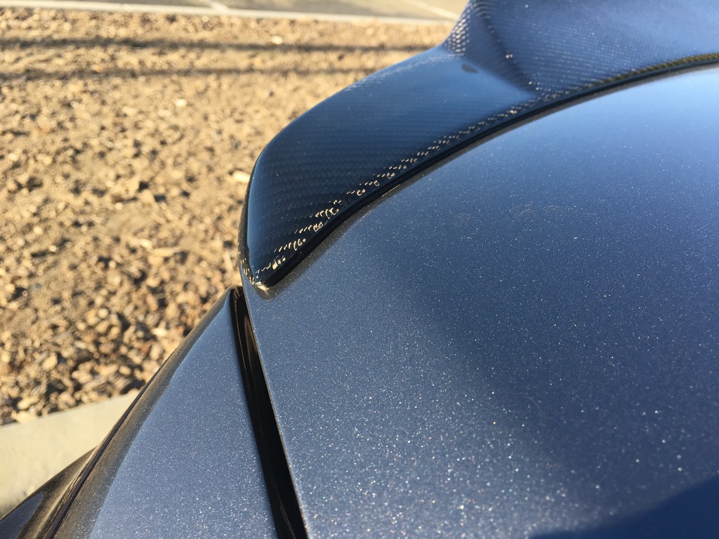

And here's the requested spoiler pics!

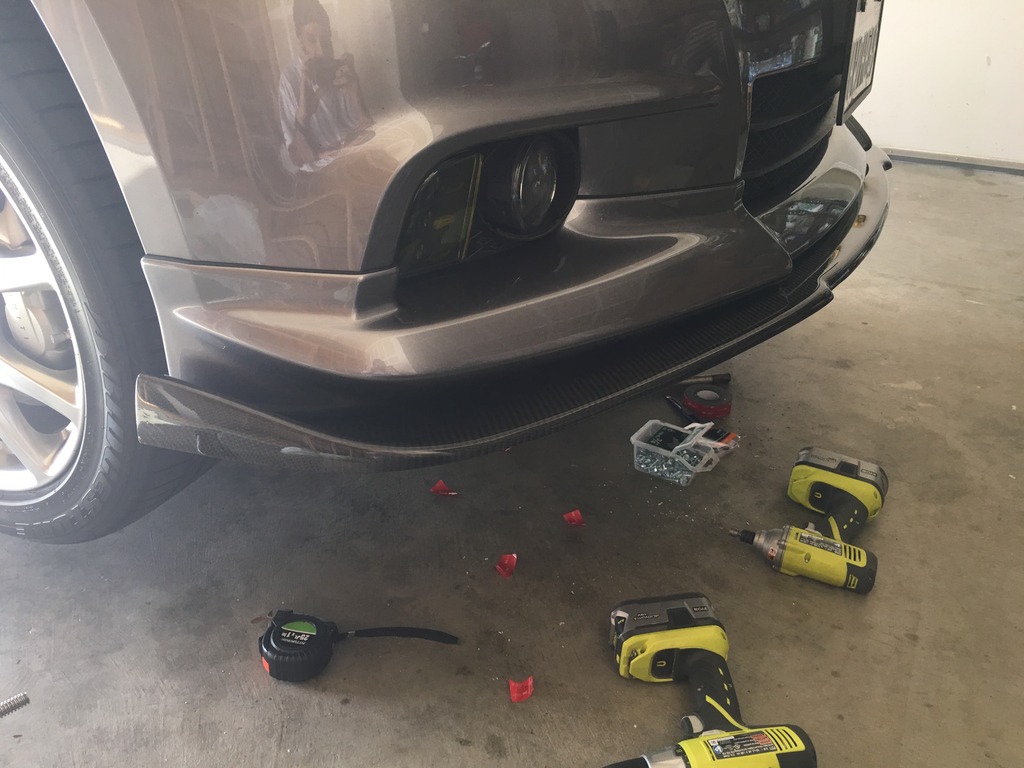

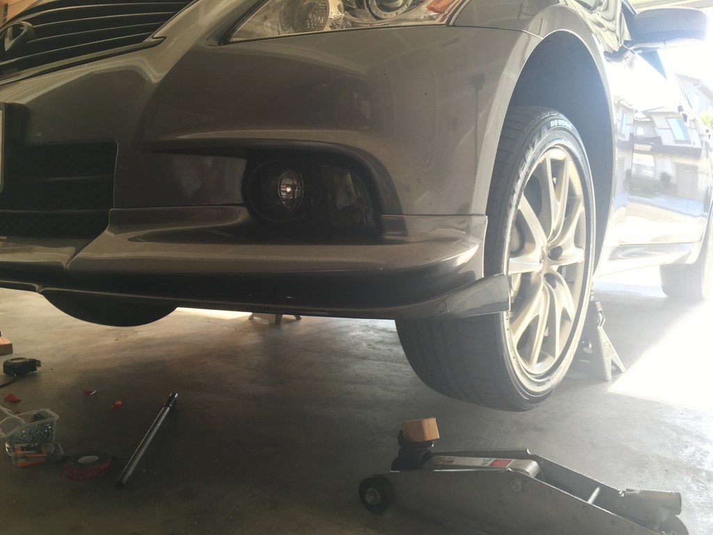

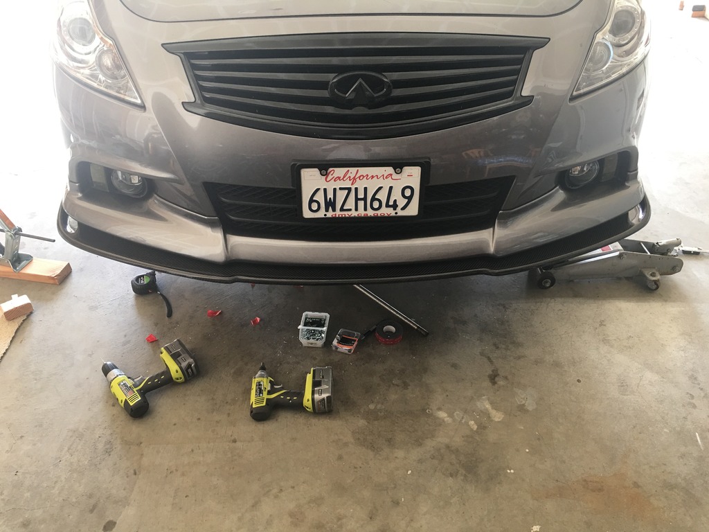

Sweet! Can't wait to see the pics in your build thread! Just get the items I've said; 3M 1" VHB, hex-head self-drilling screws and galvanized bonded sealing washers!
Then simply apply the tape, stick the parts on the car, drill tiny pilot holes and put in the screws. I also used a hydraulic floor Jack to prop the opposite side of the splitters up since I didn't have a helping hand .
