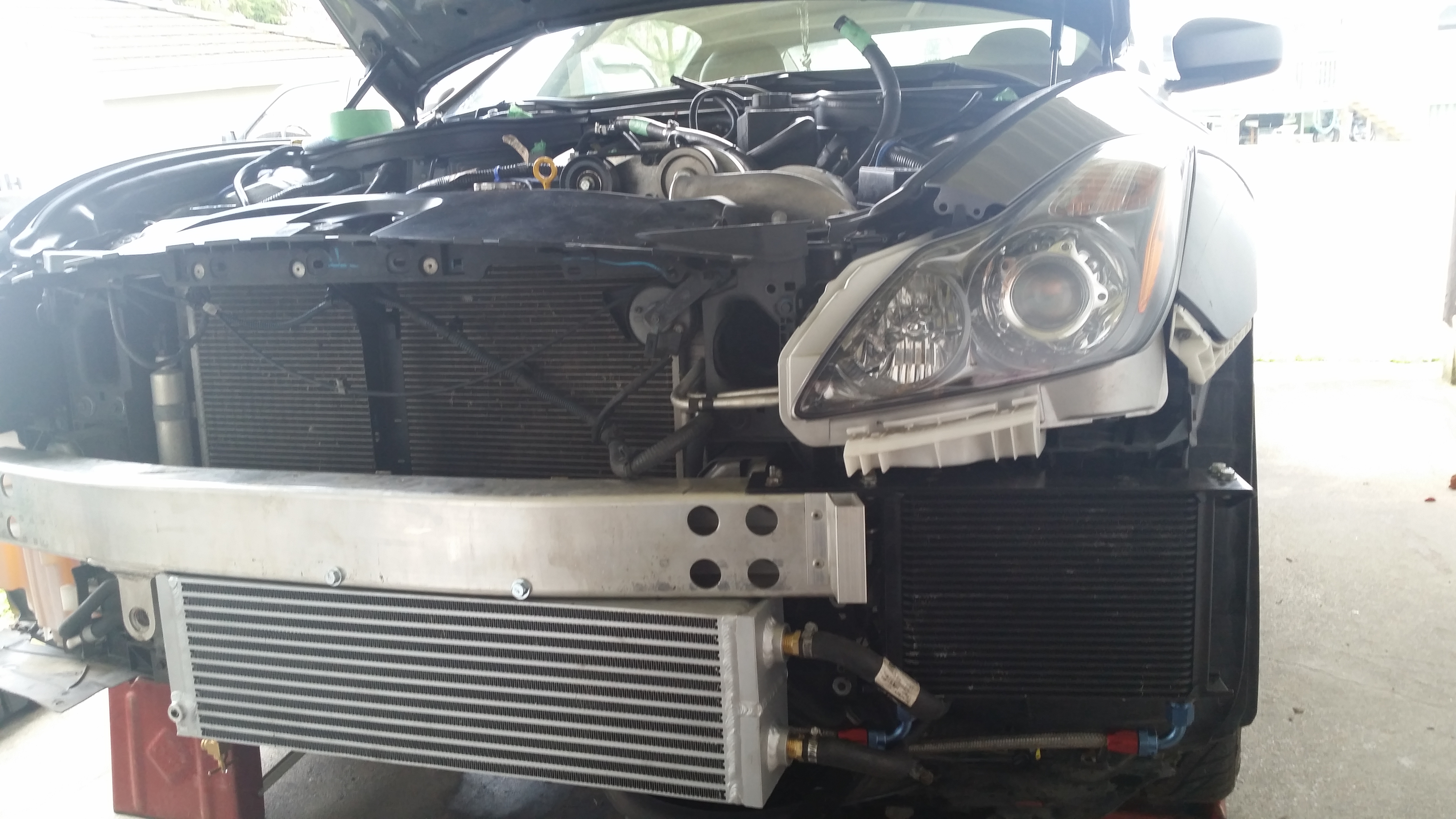

The Frozenboost IC and relocating the oil cooler I actually took care of last week so that task had already been done which was nice because I would still be putting it back together if I had to start that this weekend. Still have to mount the tranny cooler over on the passenger side. Just need to extend the lines a bit to make that happen.

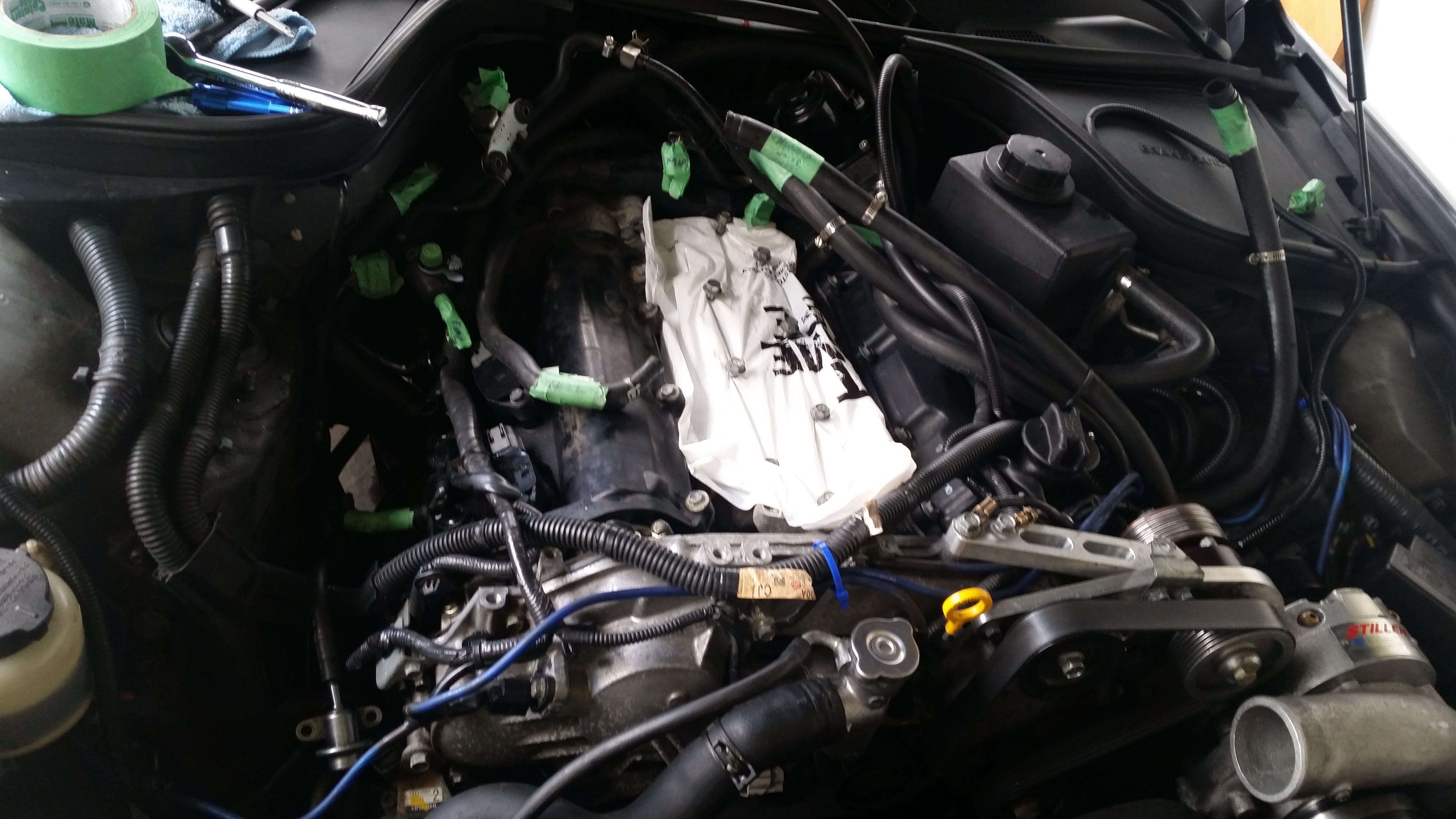

Sorry I didn't manage to get any pics up until I had the Stillen manifold off but I was on a mission and didn't even think about getting my phone out once to snap some progress photos. But as you can see I have the ports coverd by a thick plastic bag and re-inserted the bolts to keep it tight and secure so nothing has the potential to get in there that shouldn't. I have also taped and labeled everything so matching it back up will be a breeze when it comes to plugging it back together.
I will tell you one thing, that Stillen manifold is one of the biggest pains in the a$$ I have ever had to deal with and that's including removing the stock cats.. lol. The wrench supplied by Stillen to get at the 3 bolts under the manifold is inadequate at best. It doesn't have the right angle in it to allow the box end to sit on the bolt head properly to get a good enough bite to turn it without either slipping off or slightly stripping the bolt. I had to try heating the wrench to bend it a bit more to allow it to properly sit on the bolt. Didn't have a torch so I tried the stove top.. not soo good of an idea. Was able to bend the middle a little more but couldn't get the end where it was thicker and the more important spot to accomplish my goal. After wasting enough time on the wrench I went back to trying my luck at the bolts under the manifold. Still no luck and with my frustration growing by every minute I ended up undoing all the other bolts on the manifold as well as the drivers side fuel rail then grabbed a pry bar and moved the damn thing over enough to clear the bolts and remove it. Think I will need to get a blowtorch and correct the angle of the wrench in order to secure the manifold back on properly

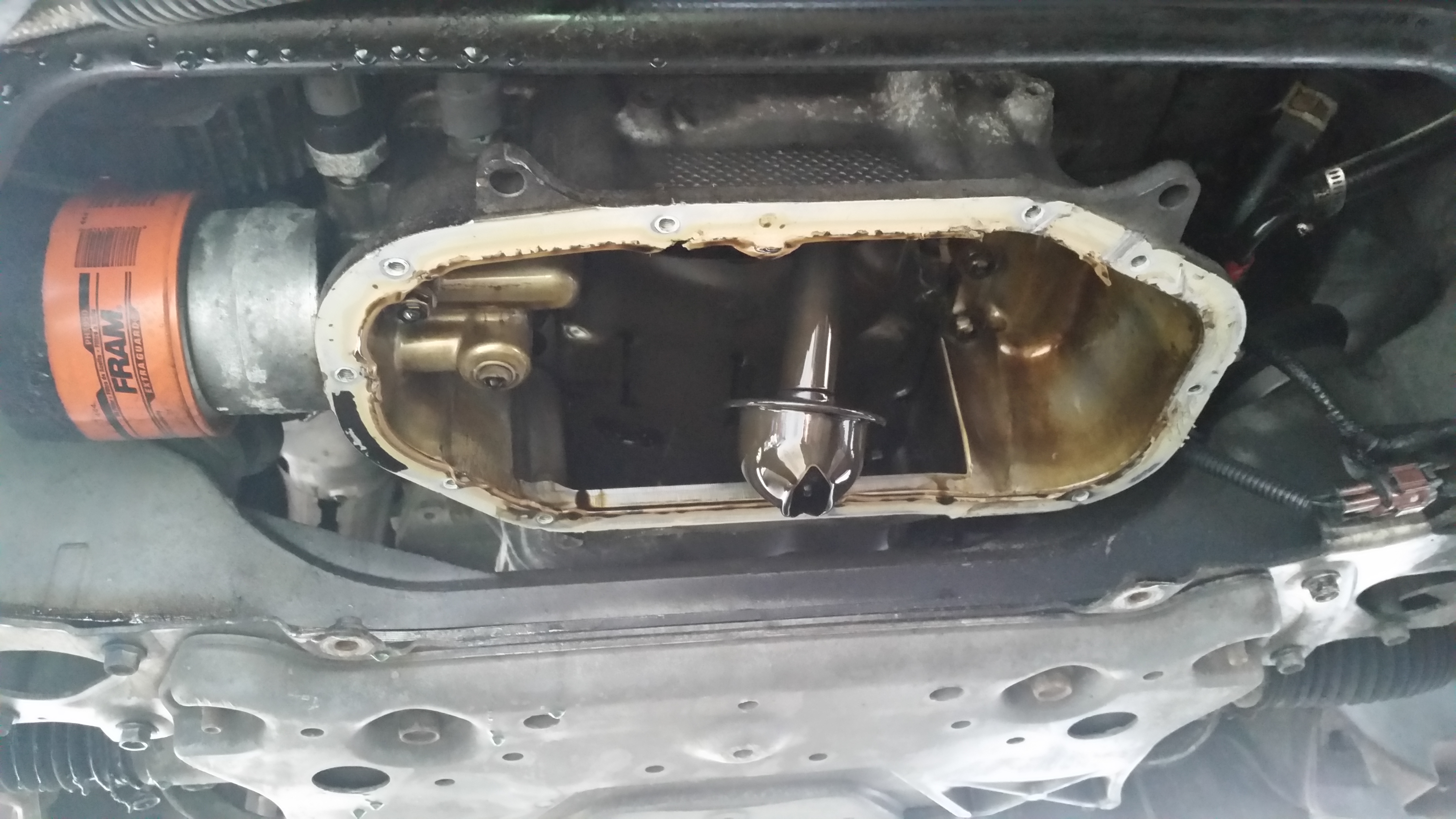

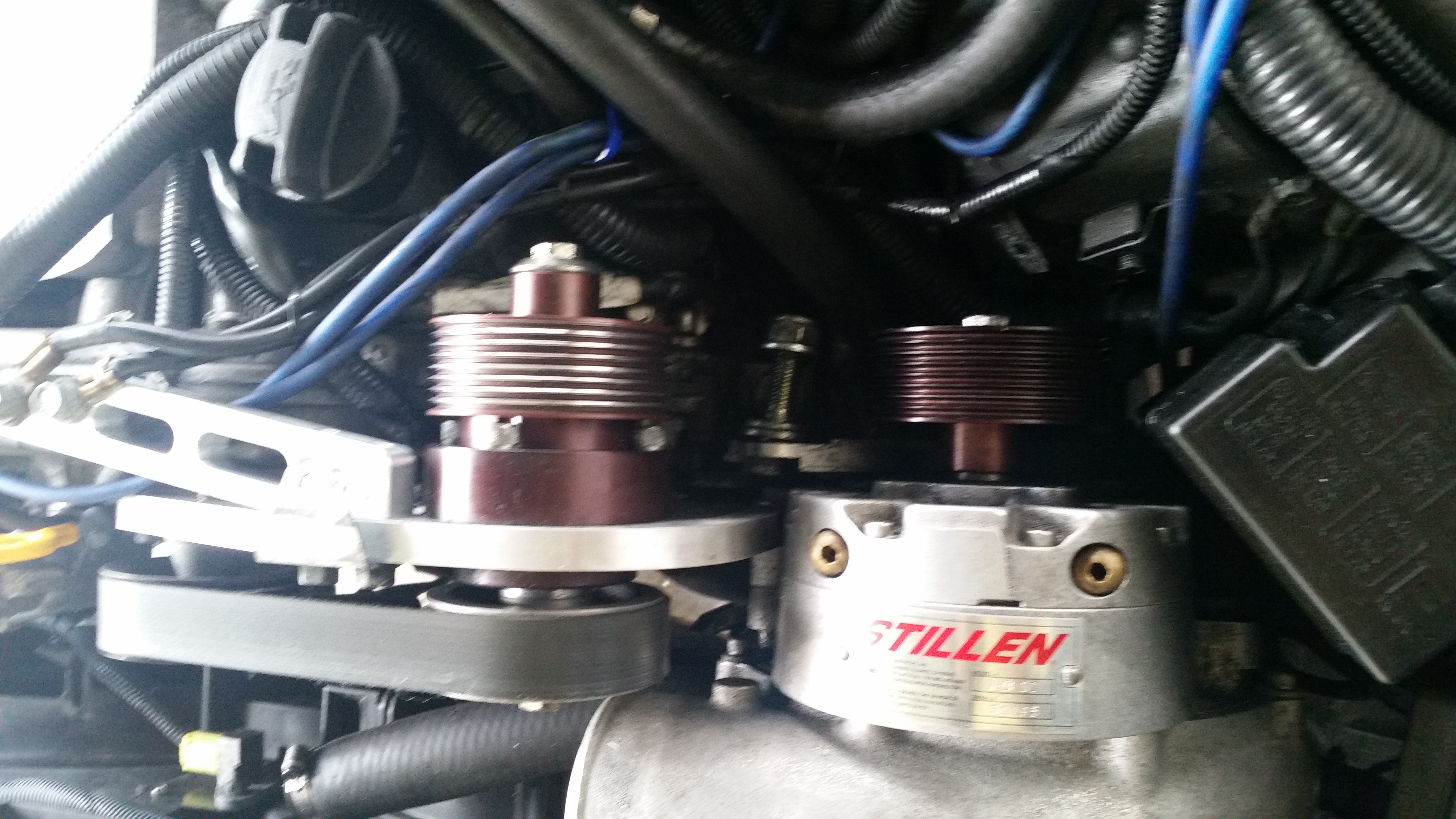

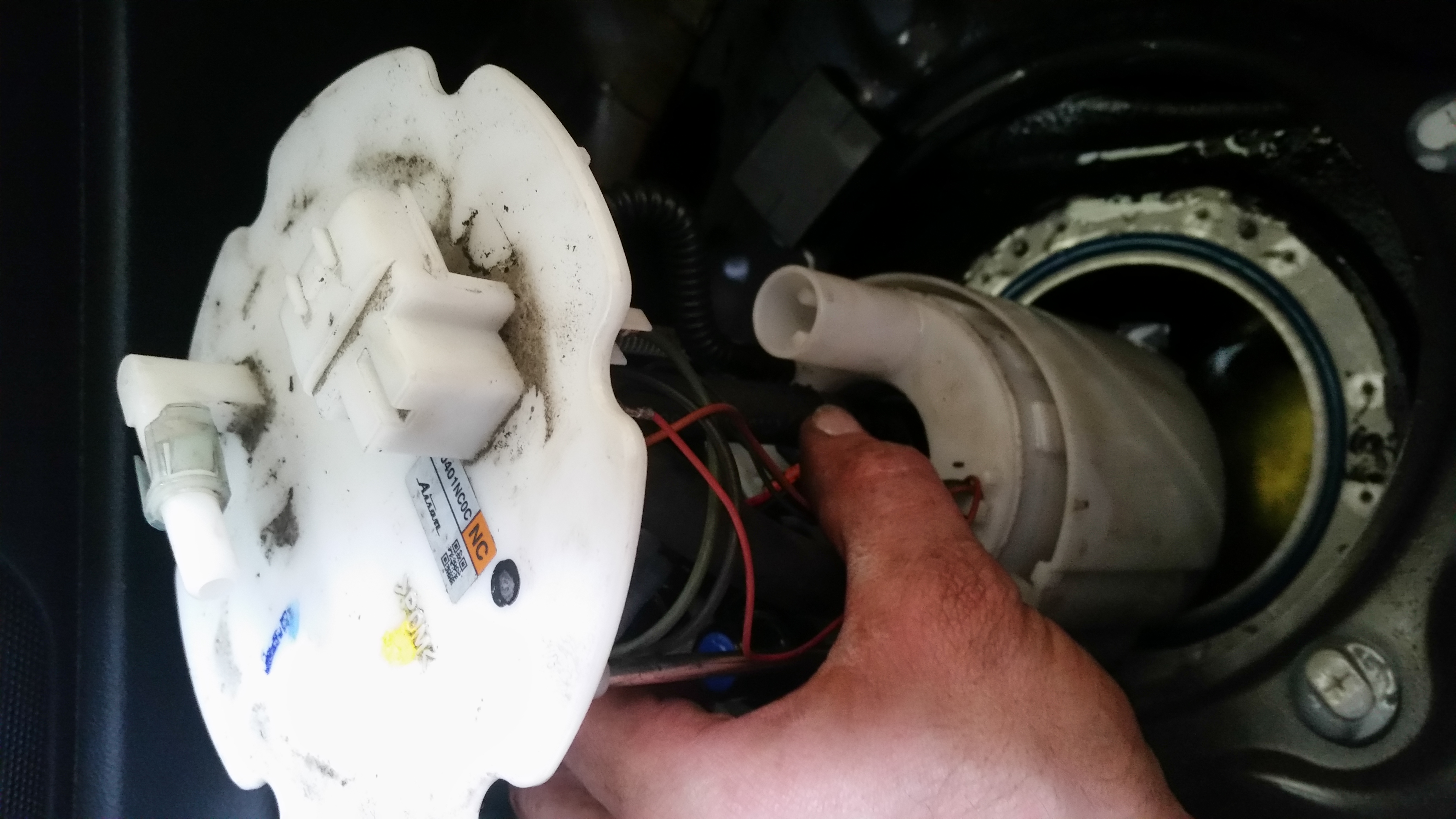

Other things I did was get the blower off, remove the fuel pump and take off the oil pan. Gotta figure out how to remove the impeller now to install the new one from superchargerrebuild.com that has better low and mid end with a good top but not as good as the 928 motorsports. Thats ok, I want more low-mid anyways. The oil pan I had to remove because I have an AAM pan spacer to put in. Looking forward to the added benefits of another quart of oil.

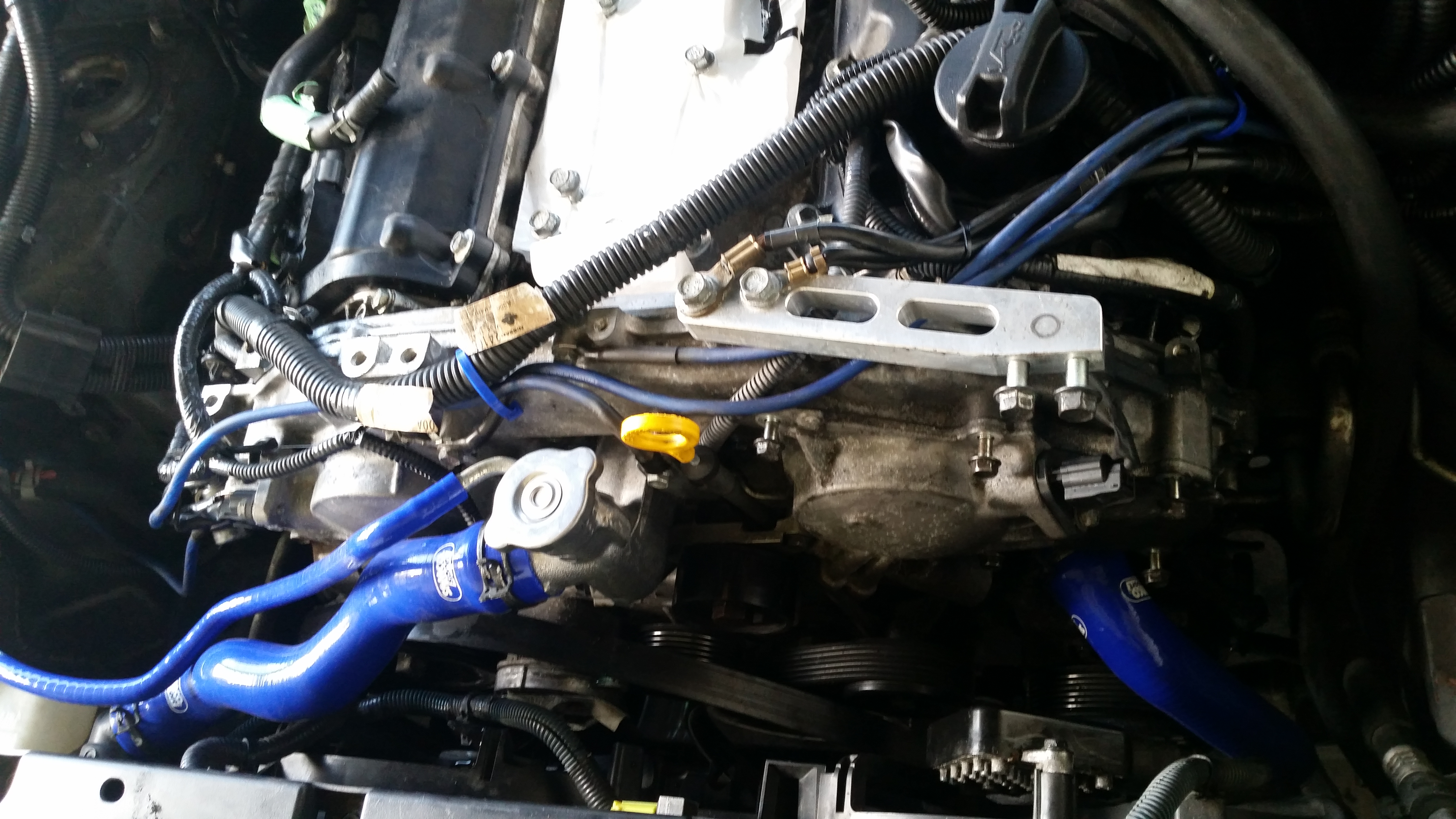

After dealing with all that I decided to drain my rad so I could install my blue Samco hoses. Have had them for almost a year and never had the time to get to it so it felt good to actually have them on even though it is probably the least effective upgrade that is happening to Lexi at this point. But it's nice to get the engine bay looking nice. As a matter of fact while I have it at this stage I am going to try tidying up the wiring. I am definately going to add a catch can to the passenger side to help unclutter the way the Stillen kit plugs up the drivers side pretty well. Also going to do a TB coolant delete and add a couple breather filters on the valve covers to help remove a couple unneeded hoses as well. That should simplify things enough to make it look a little cleaner under the hood.
