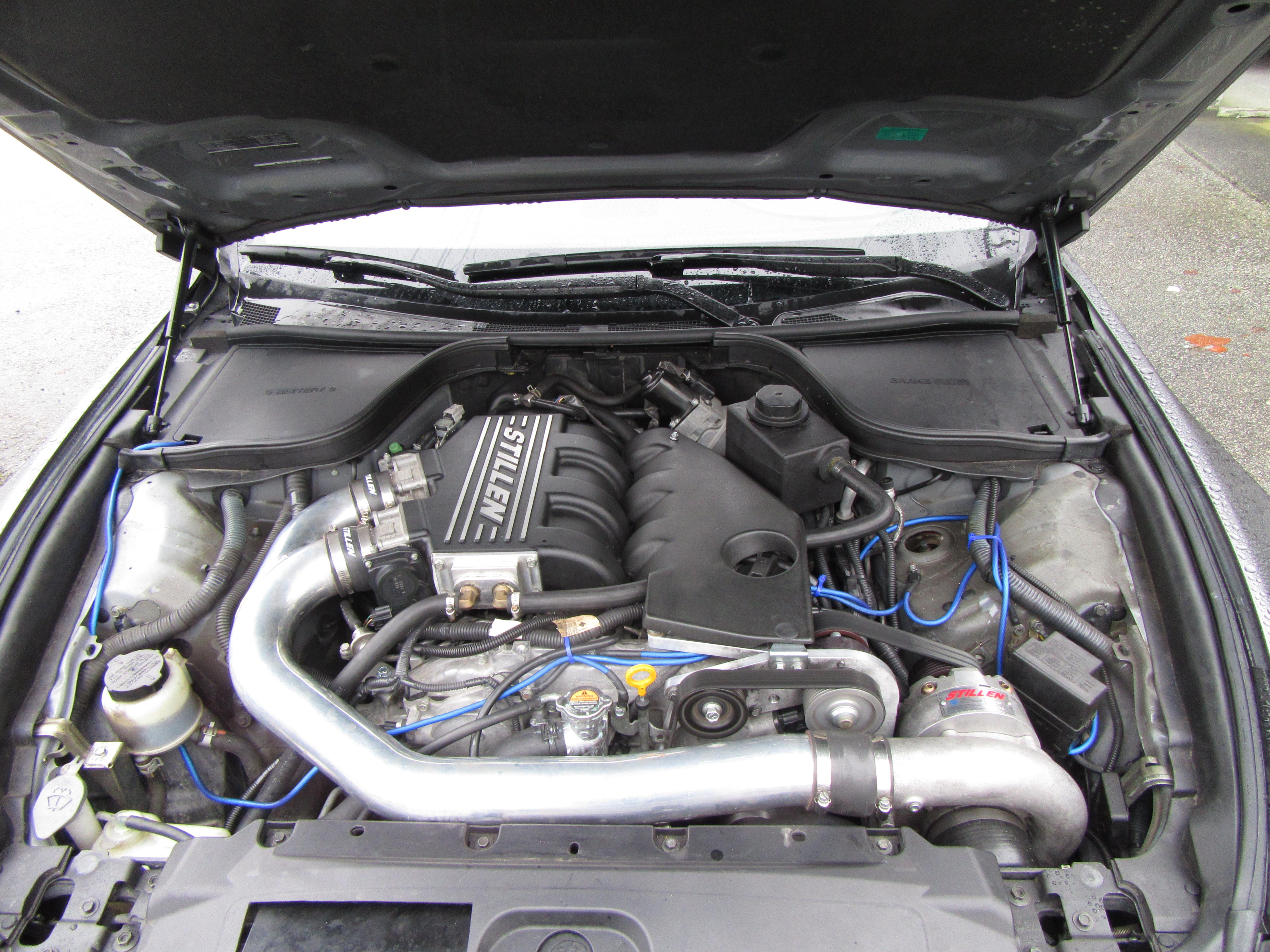

Hello my fellow G owners/lovers! I joined this site a few weeks ago and let everyone know that I was installing a Stillen supercharger to my 2012 IPL. I have added no other bolt ons to this yet as I was curious to see what it would produce as is.
I must tell you that there was an issue with getting my G started after the install of the supercharger. This was due to the fact that I had tried to get the shop prepared for the ECU flash afterwords so I called up the local Infiniti dealer and gave them my VIN # so that they could give me the ECU # in return. Apparently they gave me a generic number and the ROM file that was sent by Stillen wouldn't allow my baby to fire up. This obviously wasn't a screw up on Stillens part because they could only work with what they were given. On the other hand, instead of just plugging my car in and getting the proper ECU # themselves, the shop where my car was at decided to explore every other option first. Also, the head tuner for Stillen was on holidays for the next 2 weeks and the contact that the had for UpRev was away sick as well so they couldn't get steered in the right direction. I chose this shop because they were Stillen certified and I had assumed that they knew about tuning G's since I knew they worked on another one with a supercharger there. Well after they had exhuasted all other option they contacted another shop (which was only 2 blocks from my house as opposed to all they way across town like the other one) that specializes in Nissan/Infiniti and UpRev. The tuner there sent them a ROM file that allowed my girl to fire up first try!!
Finally!! After 2 weeks of my car being away from my possession I finally had her back . I have learned not to trust just anyone that may be certified by Stillen because that only means that they can order their product and might not actually know very much about it (not going to let that one happen again). Another thing that was unfortunate is I had a lightweight Unorthodox pulley I wanted installed with the supercharger and the shop that was handling that "didn't have the tool" to do it. They said they called around looking for it but were unable to track one down. I figured that was a red flag right there but my G was already in pieces and my first priority was to get the supercharger installed anyways.
So once I did get her back the shifting was all wrong and it was having trouble starting so I really wanted to get a proper tune done to make sure everything was proper with Sexy Lexi . Funny thing is, I called the only Osiris Pro Tuner shop in British Columbia (oh ya, I'm Canadian ) and it just happened to be the same shop that the last one called to have the ROM file dealt with. When I started talking with the tuner he knew my car and exactly what I was going through so I booked a dyno tune with him and also had them install my lightweight pulley. I am so glad I went to them because within minutes of them starting to work on it they noticed a boost leak and traced it back to the seal for one of the injectors. Needless to say they fixed up my G right and gained just over 20hp from the dyno.

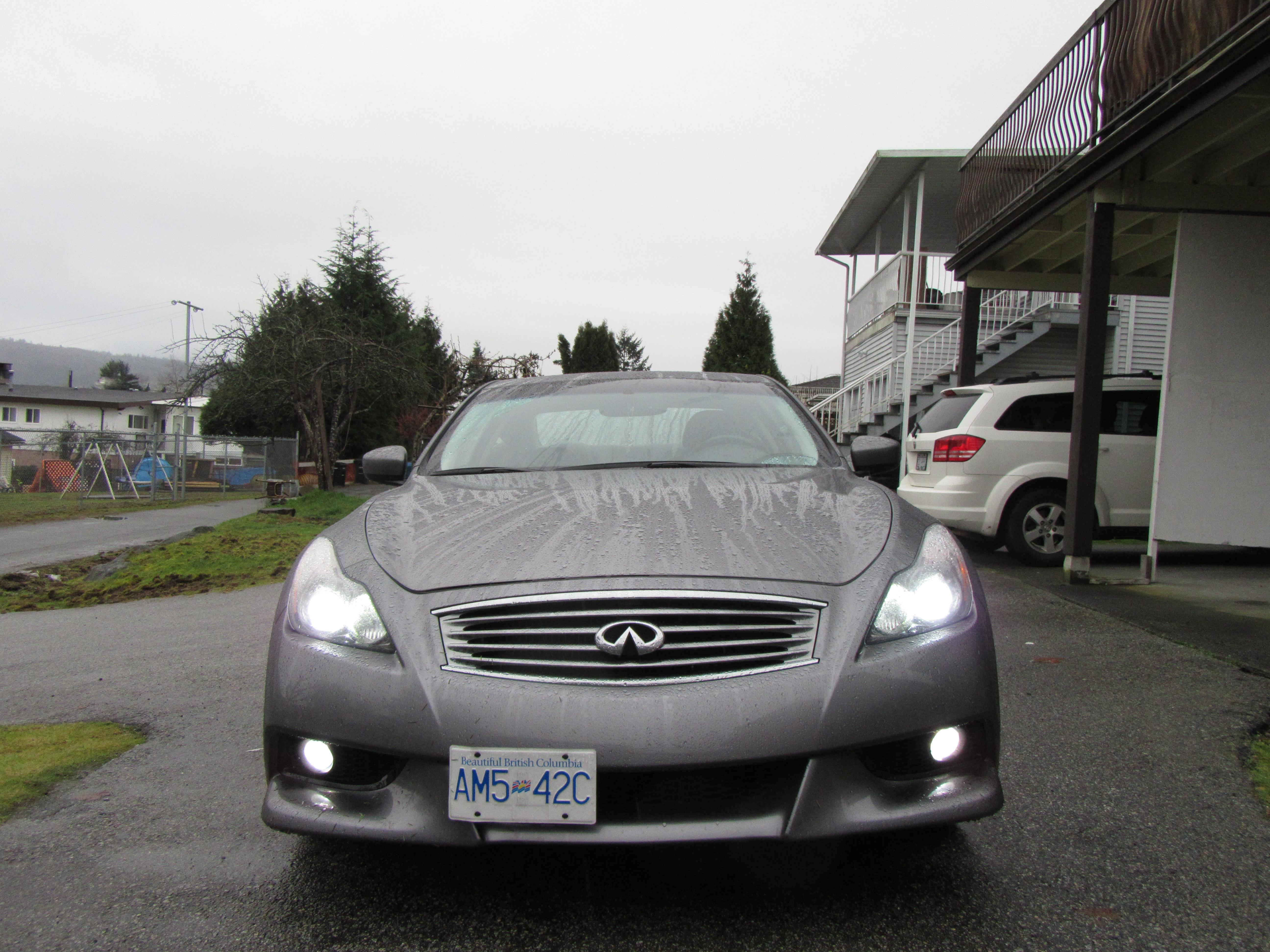

I have also installed 7000k headlights and fog lights with LED city lights too. I have also installed a ground kit just to be safe. I should also add that I added the oil cooler and transmission cooler (yes it is a 7at) from Stillen installed with the supercharger. I have added a few pics as a start to this thread. I am going to be following up with my dyno charts and maybe a video. I am extremely happy with how my G performs now and am looking forward to add to her. Stay tuned and I will keep updating as I save money and add more mods

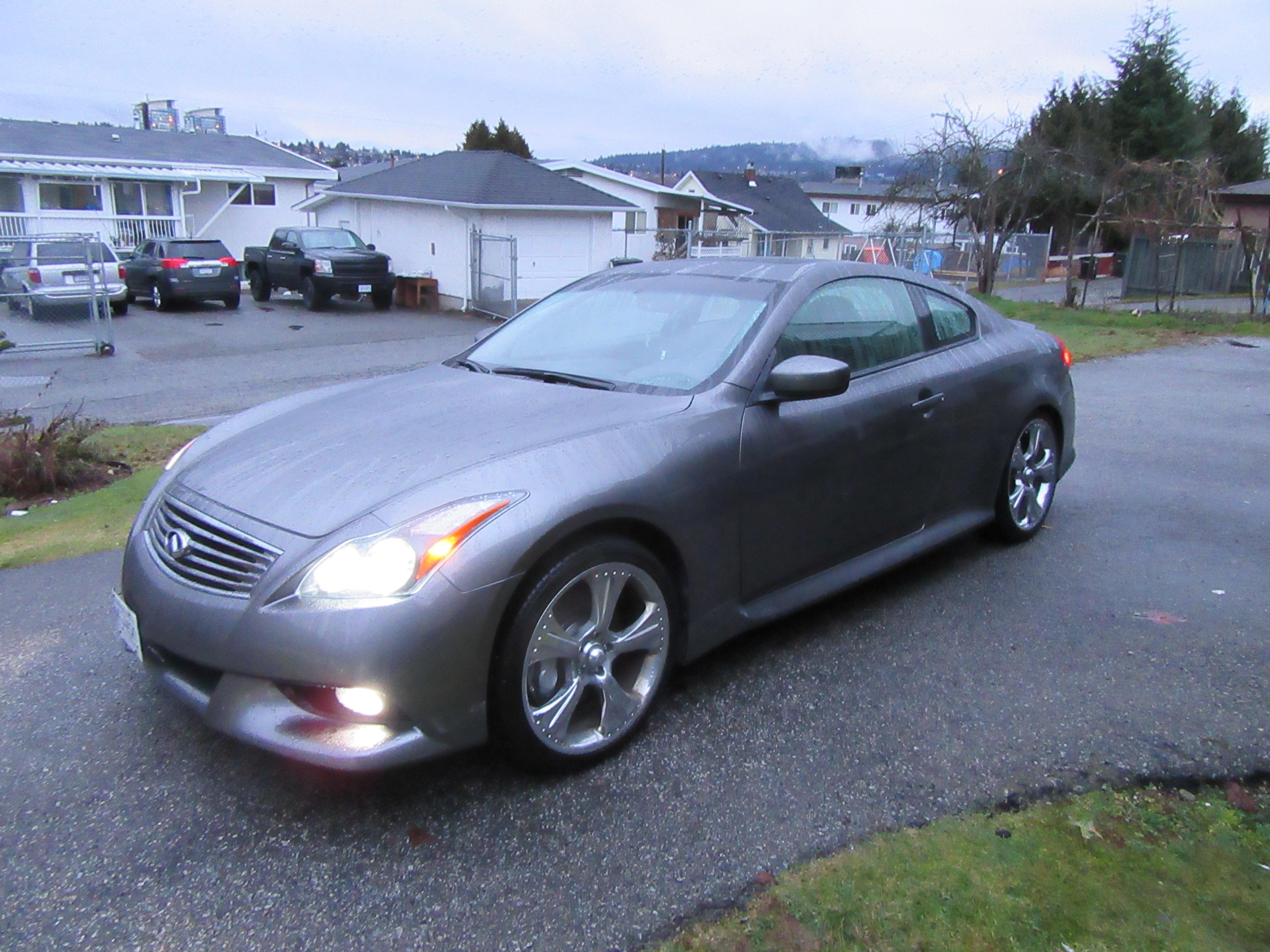

#1. If there is one thing that bugs met the most about our beautiful rides is the atrocious amount of wheel gap that comes stock. I have been searching relentlessly for which setup would suit me best and wasn't sure if I would be happy with whatever drop a set of lowering springs would give me and didn't want to settle for a cheaper brand of coil overs either but I do have a bit of a budget to work with so lucky for me a gently used set of KW V3's came up for sale locally and I pulled the trigger immediately on them. Only issue now was the issue with my rims and tires that I knew weren't going to be staying on Lexi and I didn't want to install and setup the coilovers onto something that wasn't going to be a permanent which brings me to the next mod.
#2. Those god awful heavy *** chrome rims just had to go! I wasn't in any rush to look for new wheels for my whip since the rubber on them were in almost new condition but since I was now about to drop my ride I needed to get myself some proper shoes to go out and play with the bigger kids..lol. I was keeping an eye on package deals for the last little while anyways so I kind of had a jump on the search anyways. I had come across a nice set of 19's but they were a 255/295 stagger and I wasn't up for rolling my fenders or doing much trimming either so I gave up on the idea of those and quickly after came by something that caught my eye and was kind of a little different from the style that most G owners seem to go with. They seem to make it more of a muscle/sporty look and since it's a G it still maintains the elegance and style that we all love about them, so to me it creates the best of both worlds. The owner of the shop let me have them for a smokin deal which made it a no brainer for me. They are Gianelle (made by Giavana) Puerto's 20x8.5 +35 and 20x10 +40 wrapped in 245/35 and 285/30.

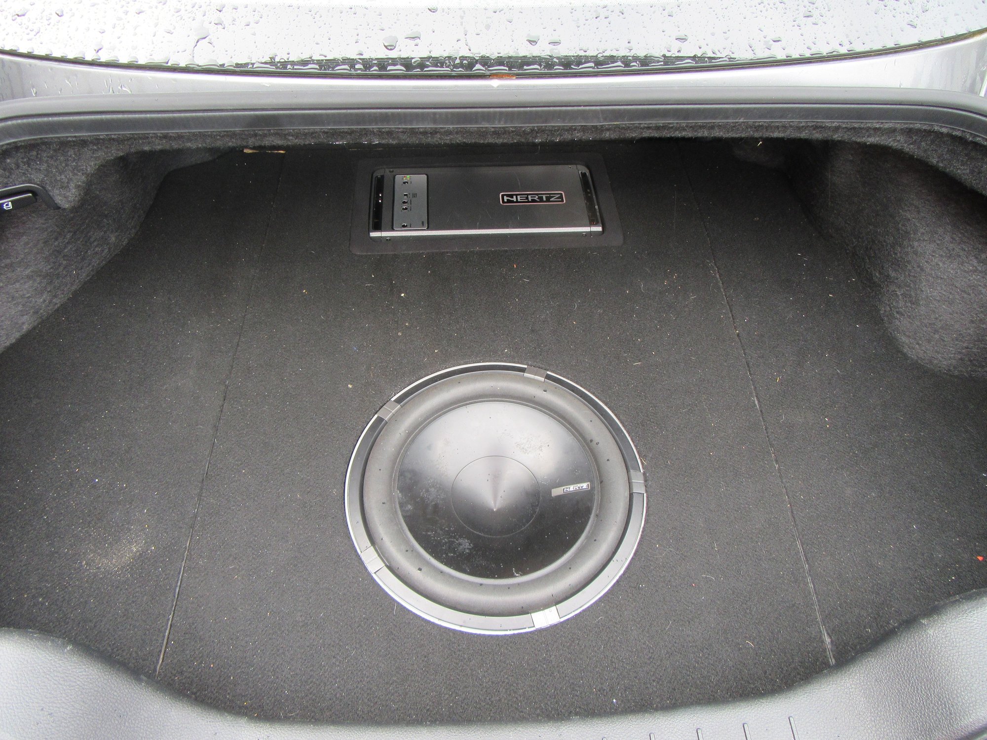

#3. This one I actually had done right after I brought Lexi home. I had a friend of mine at a home & car audio shop install a DSP (digital sound processor) which allows for a pre-out to hook up an amp and sub. Needles to say he hooked me up with a deal and designed a custom box sunken into the trunk itself which means that I had to remove the donut in the trunk which I saw as being worth waiting for a tow truck instead of changing a stinking tire on the side of the road by myself. The sub is a 12" 1200w Hertz with a mono 1000w Hertz digital amp. Let me tell you, I used to have 3 10" Kenwood subs along with 4 4.5" mids and 2 tweeters powered by 2 600w Kenwood amps and this Bose system with the added sub and amp BLOWS my old one out of the water.
