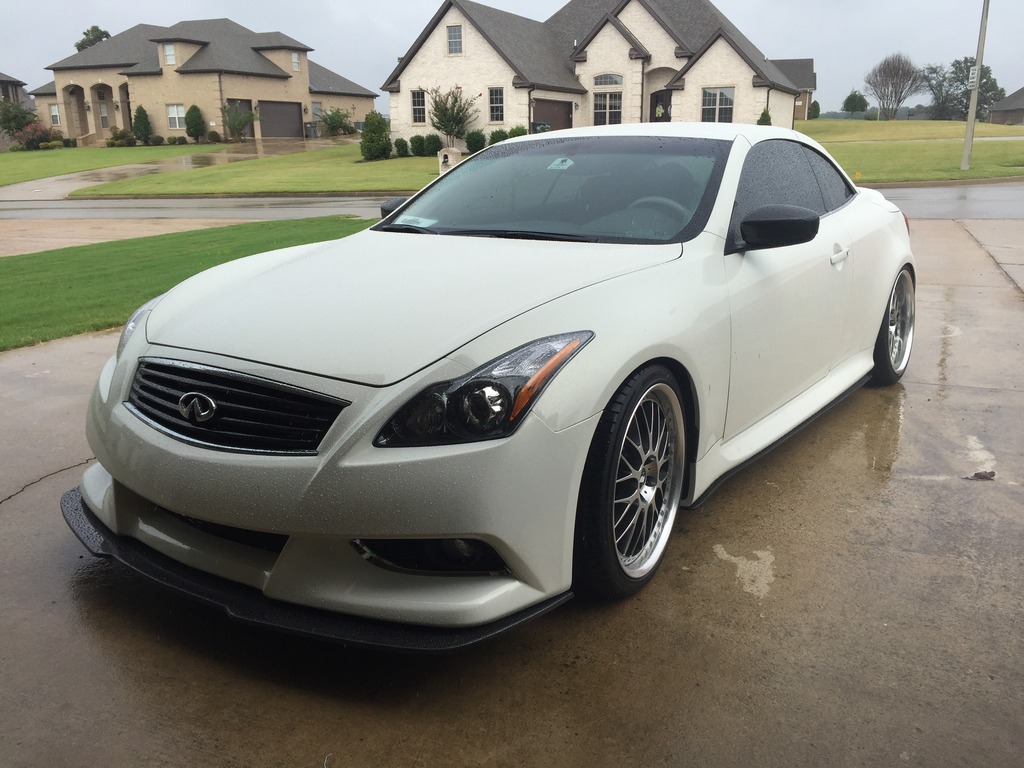

Well they weren't even able to get it up onto the lift without possibly damaging my CF ground effects! They said they were equipped to handle lowered rides but no luck today. I'll call around again and this time I'll be much more Specific about what they will be dealing with.
I need to get some adjustable arms soon. I need to raise the rear up by 1/4"-1/2". According to the wheel tech once my rear tires are aligned and adjusted he's not sure if the 275/30/20 will clear the fenders. Looking at it myself I can see he may be correct.
I'm going to take out my spare tire and all the tools just to see if it helps at all. But I'm gonna need some knowledge & experience dropped on me as well plz guys

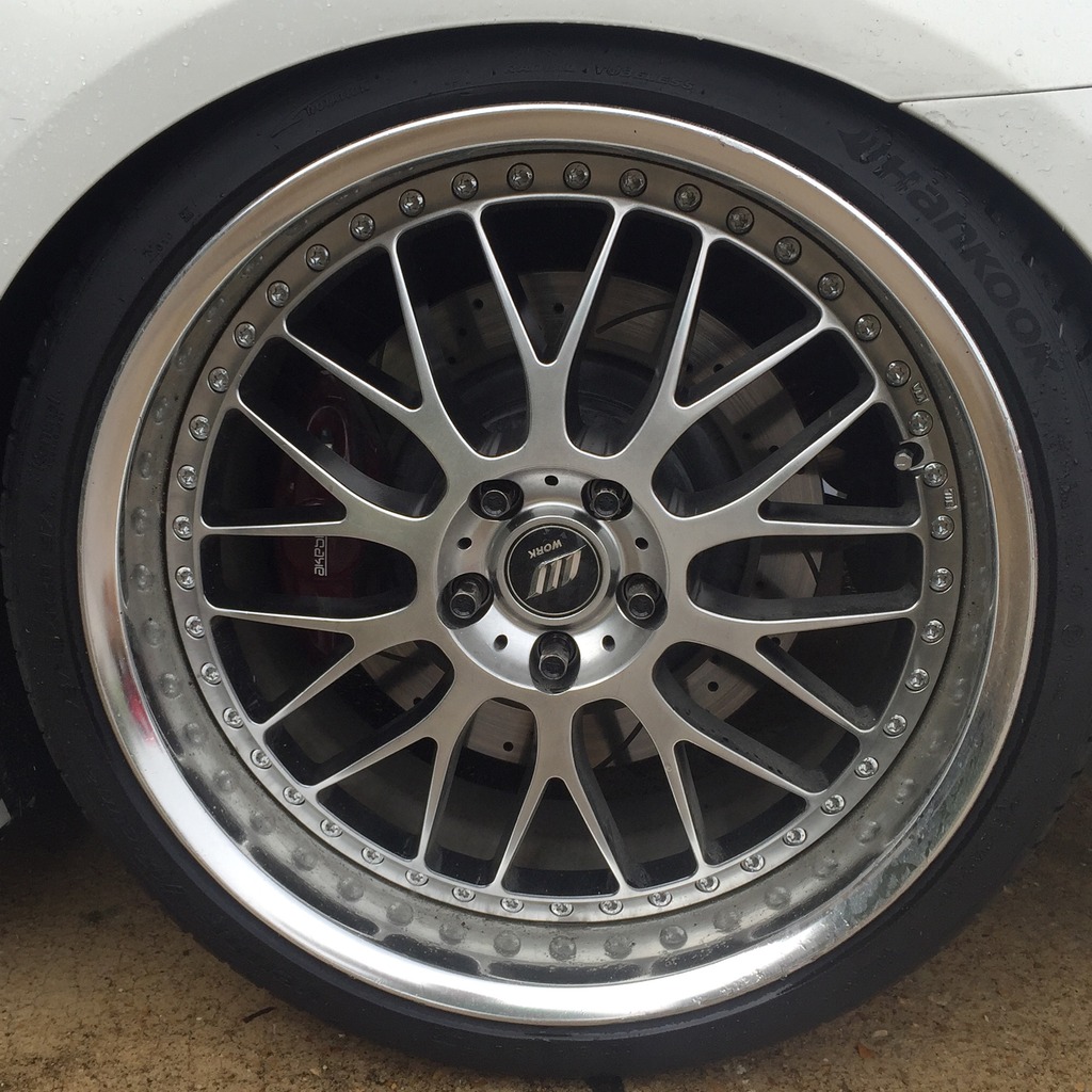

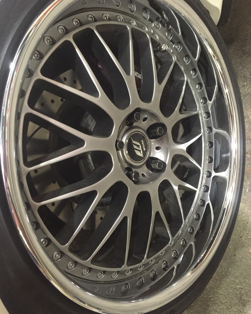

There you go 3POINT8. I figured with all the negative stuff going thru my head right now I should post some pics that make me happy. Ugh

To me, Red, it looks like you've got 300 pounds in your trunk. It just looks goofy, buddy. Sorry.
However, the wheels themselves are gorgeous. And their offset looks fine against the vertical plane of the fenders.
You're simply not going to be able to raise the rear end with poly spacers without compromising the handling. You saw what I went through this year, thinking that was a solution. It's not. It simply isn't. I'm a little embarrassed by my efforts there, but just a little bit... pride before the fall, and all that, LOL.
For one, the 5/8" spacer technique actually raises things nearly one full inch, because there's no material for the springs to settle into... the poly is too hard. Plus, once the springs are sitting on that hard poly, without the means to form into it, your handing gets a little squirrelly. That was something I didn't realize until after the fact. And the 3/8" spacers, while a perfect solution for a few weeks, eventually blew out because the material is too soft. Both experiments were a big fail.
My only option was to go with Coil-overs, and even then I am maxed out at the height extent on what would be considered very conservative CO's.
Potentially, you could put a spacer on the *underside* of your top-seats. But to accomplish that correctly and safely, you need a creative mechanic willing to experiment. And I suspect the fitment of the top seat into the upper bucket would be compromised.
Whatever you do, you will likely require an adjustable camber arm and aftermarket toe-bolt, otherwise camber will dial in after targeting toe, and it will be whatever it is, with barely 0.2* available adjustment. Without the camber & toe kit, there's just no wiggle room.
You know, I don't hang out in the Vert forum, but I have to believe these problems are identified and solved over there.
