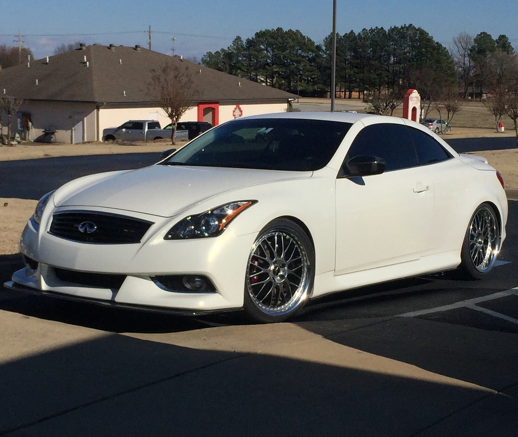

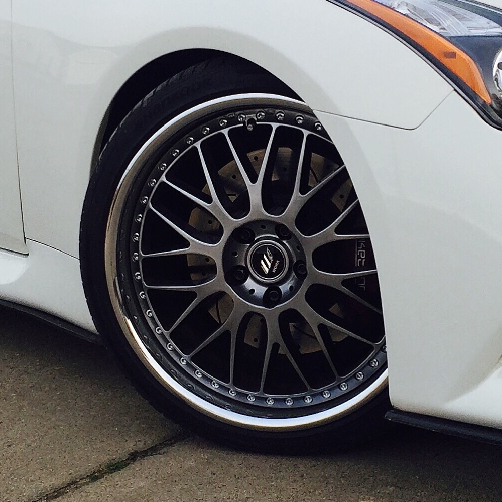

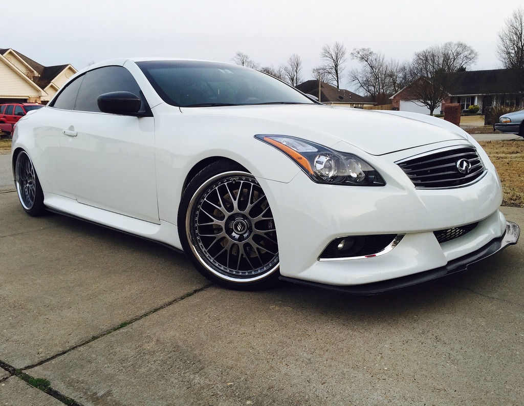

Hello gentlemen. I apologize for my disappearing act of late. TBH I was still dealing with the alignment issue and I just didn't have the heart or the desire to get on the site.
Brad the control arm that was bent was the rear passenger side. The tire that got eaten alive was the rear drivers side tire. It wasn't the tread that got destroyed. It was the outer tire wall that is closest to the suspension. The tire tread was still lookin tick and wonderful. But the tire wall began to show a healthy amount of the wire belt. This happened over a course of two months, but you need to understand I only drive my car 10 miles a week. Maybe even less than 30 miles a month. So this was drastic.
I found a pit alignment place, took the spc adjustable bolts Brad told me to buy, jacked the car up, installed the spc bolts, and relinquished the car to the alignment technician. Before I left I armed the tech with the installation instructions and told him to please not use the impact wrench to put my project kics R40's back on once finished. He called me an hour or so later and said the rear tires could not be aligned without aftermarket control arms.
I am planning on having my brother in-law (professional mechanic btw) drill the holes the spc holy instructions call for this Subday. Oh and I bought a set of 5mm kics spacers to replace the 20mm kics spacers I had in the rear. This gave the wheels n tires much more room to be manuvereed without having to worry about rubbing the fender. I'll update you all after the holes are drilled and the results are in.
FYI the tech did manage to align my front tires. This caused the traction control warning light to go off which is great IMO. Here is a few pics to catch you guys up.

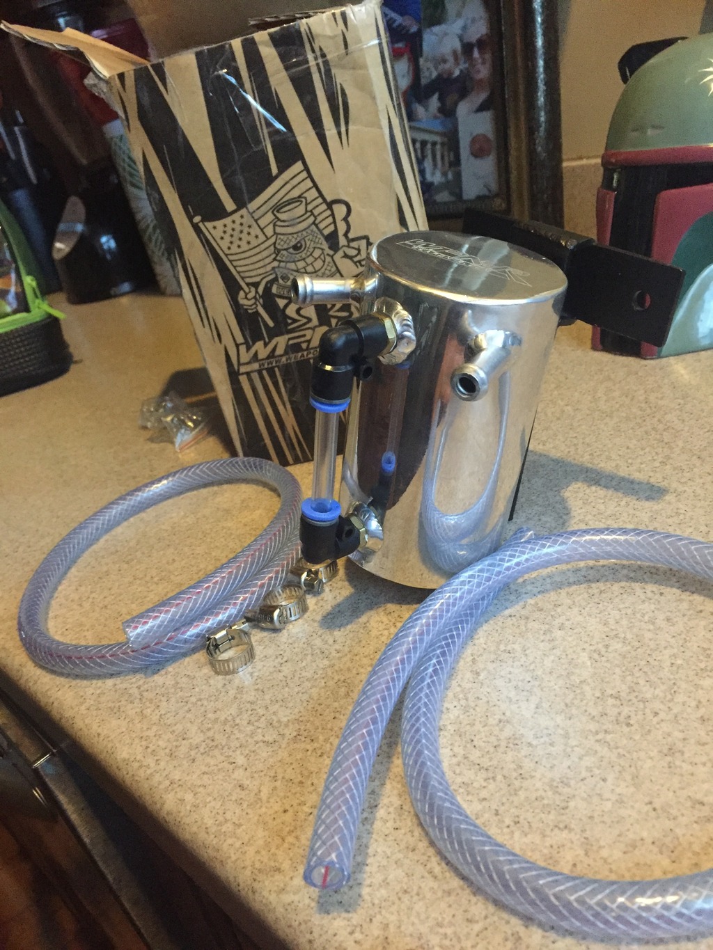

Got a catch can for $40 off of chi city snow. Also got a cusco strut bar coming soon from another member. Just wanted to update everyone.
Gonna attempt to do a JP type of engine bay job DIY style before I install either of them. Most likely I'll practice on the battery cover first. Wish me luck!!
Anybody got tips or tricks on bay painting pls speak up or pm me.

Make sure you mask it well. I just used some standard spray can dupli-color on my engine/batt/brake covers. It looked good, until I went with another color on the rest of the engine cover and didn't mask it right, got some paint bleed and tried to touch it up. Now I need to redo the engine cover when it warms up a bit.
The black is now white, and engine heat has discolored some of it, if you do the lower portion of the engine cover, might want to use high heat paint.
