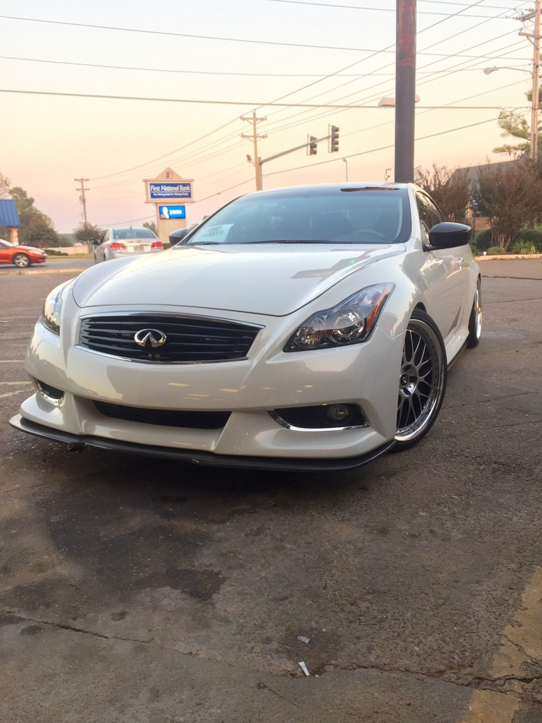

Old Oct 16, 2015 | 04:08 PM
  #297
Redfire32's Avatar
Redfire32
Ginger ninja
Joined: May 2014
Posts: 1,998
Likes: 258
From: Jonesboro, AR
