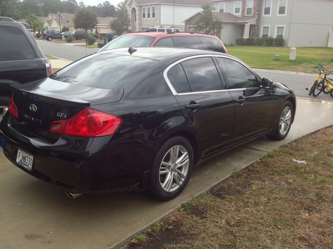

Any issues with your sedan being an "X" as far as the tire size is concerned? Or is the outer diameter good to go?

Wait, I missed that the OP has an X, and those OEM Sport rims he bought and restored are staggered.
Deelow, aren't those 8.5" front, and 9.5" rear? If that's the case, won't 275/35/19 be large on that rear wheel?
I must be missing something here. The sidewall stretch will be different front to back. I'm only saying that because they look perfectly identical on my rims front to back (on my dining room table), and I have those same size tires, but on 10" wide rears.

^Here sir.. I guess it's an X unless it was a rebadge from an S?
