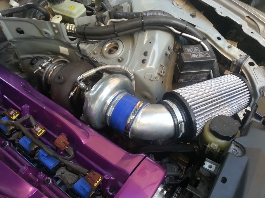

Thanks man. A leak down test is currently being done on all valves. Hoping its just that.
In the meantime, here's a pic of my intake side:
Old Jan 22, 2013 | 08:48 AM
  #273
daonlyillwiz's Avatar
daonlyillwiz
Posts: 491
Likes: 30
Way too tight DAMN.
If i was you i would send the hotside out to get ceramic coated both inside and outside as well as the exhaust manifold. Also wrap the downpipe as well otherwise your intake will just be sucking in hot air and by the time its cooled by the intercooler it will pass through heat soaked piping and get hot again...especially in the middle east lol.

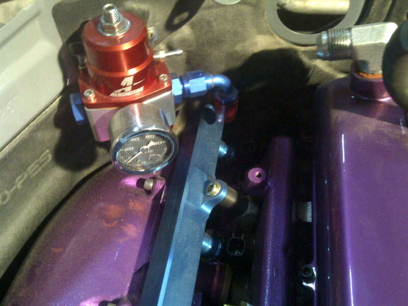

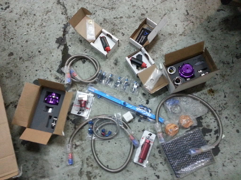

Originally Posted by daonlyillwiz
also check base fuel pressure...if you're running aftermarket injectors you cant zero out the tune config because it wont be stock at that point because the injector dead time(time between open and close position) and global value(amount of fuel per squirt) will be different. If you are running the aeromotive stealth FP, you need an aftermarket fuel pressure regulator and make sure base FP is @ manufacturer spec for the RB motor.
You missed out on a lot of reading in this thread
Not sure but since i cant see a MAF sensor anywhere im going to assume you're running speed density so just make sure the MAP and IAT are working correctly and hooked up correctly.
Yeah I'm running MAP & IAT, both are brand new. Tuner will do his thing tomorrow.
