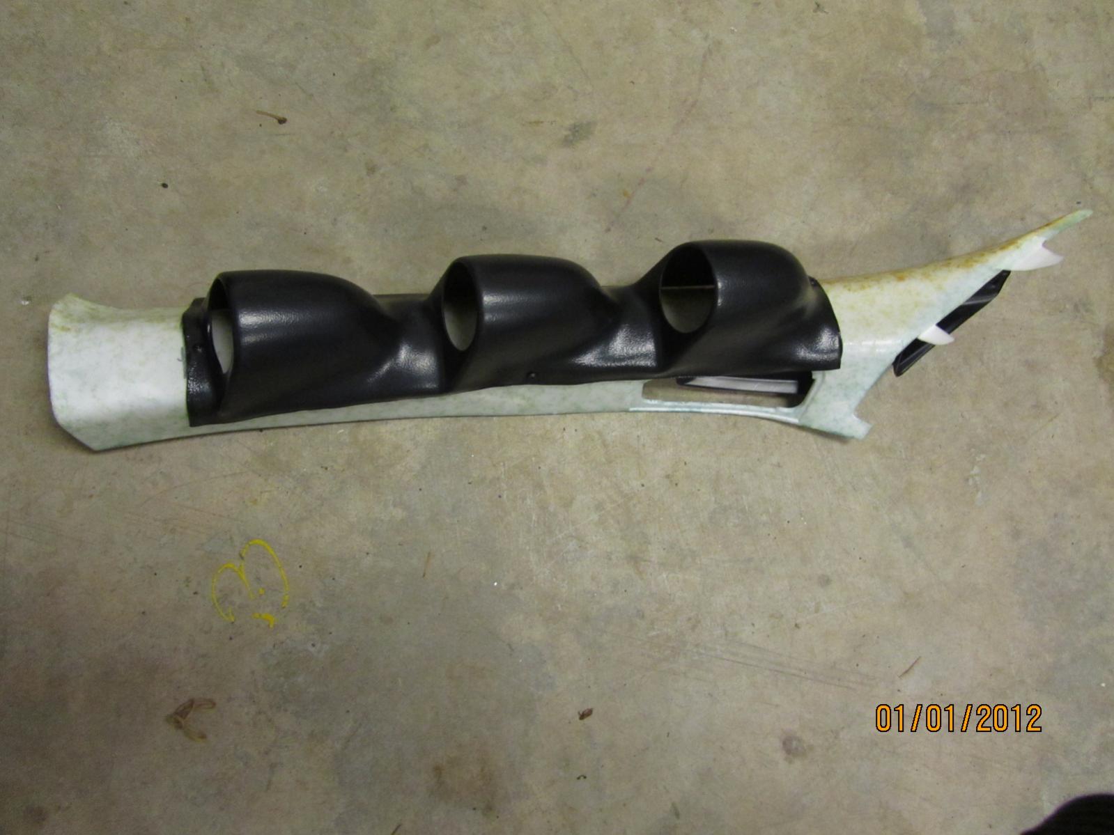

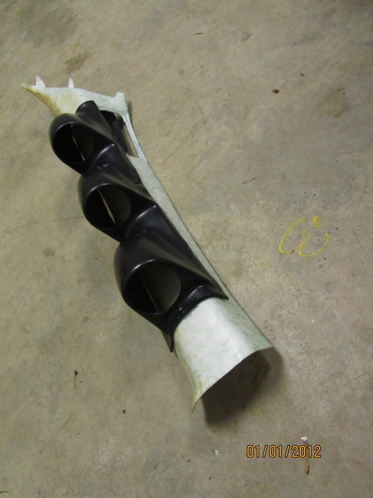

So Wed. has come and gone ... I have been busy with some other things . Started the molding of my gauge pod to my driver side pillar. Bought some bondo and plastic weld from home depot . I placed my universal gauge pod on my pillar to find the location I liked best .. Took the pillar off and started taking all fabric off of it .. Next I placed the gauge pod on the pillar again and took my heat gun and started to warm up the plastic of the gauge pod to conform to the pillar. I than scuffed the areas of the pod and pillar that would have contact and
glued them together . I put screws in 4 different locations to get a nice bond between the two... Let set for 24hr and trimmed all the excess gauge pod with a dremel ... Next is the Bondo !!!!!!!!!
